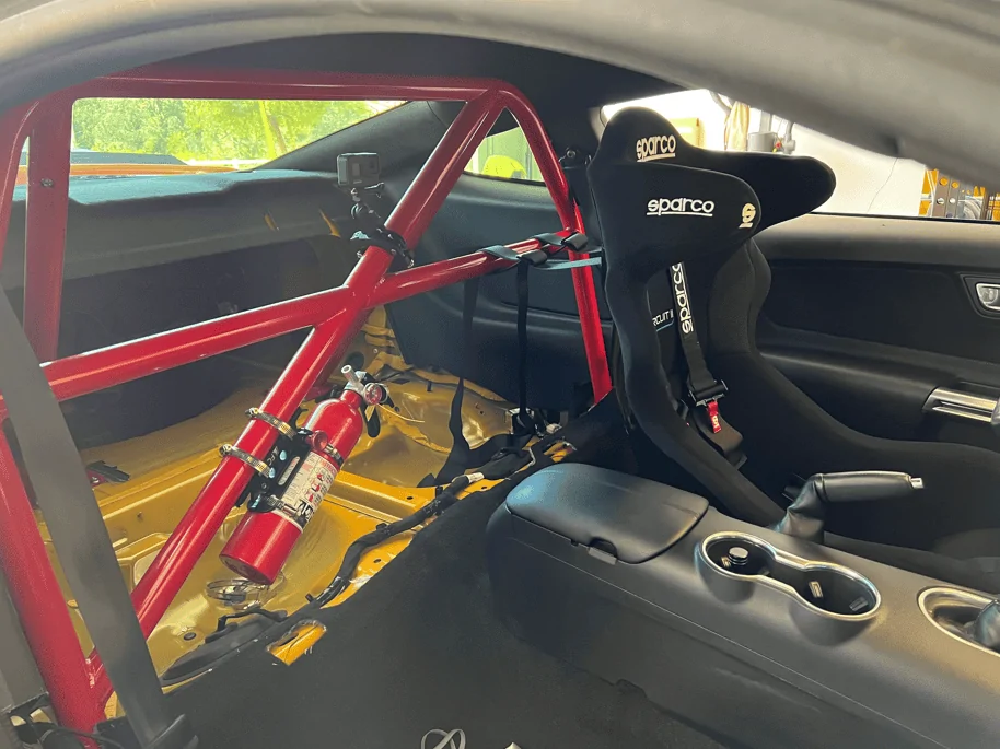

I got mine at Home Depot
@PaddyPrix has unfortunately had to use his before. I think he used the same type.
I wouldn't worry so much about clean-up and rather use whatever works best. You won't need to worry about clean-up if your car is burnt to the ground.
