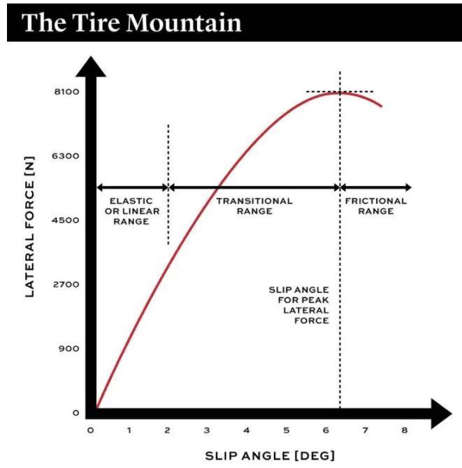

Sliding isn't fast, that's correct. Controlled yaw/rotation is very different from true oversteer, as it's keeping more of the "static-esque" friction between tires and the road surface, which has a higher coefficient of friction. Oversteer and understeer is asking the front or rear tires to do too much at one time. If you are seeing oversteer on the entry phase of the corner, you are probably upsetting the car via inputs (timing of brakes or lift-throttle). If it's at the exit of the corner, you're probably using too much throttle too early.

Also remember, using this tire , your car would need to yaw (be sideways) 6.5 degres to get max grip. I have seen a lot of novices stop pushing the car as soon as they generate any significant slip angle, which means they are running at well under the limits. So one guys oversteer might actually be just driving at, or close to the limit. Or "neutral" for a skilled driver.

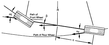

Yaw angle =/= slip angle. Related, yes.
Your point is valid.
