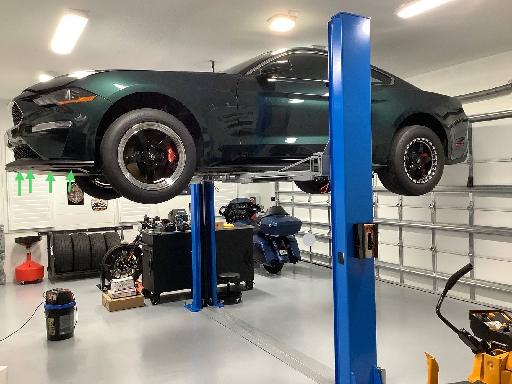

All of the screws for the belly pan on my car are easily accessible. See pic with green arrows referencing the location of some of the screws.

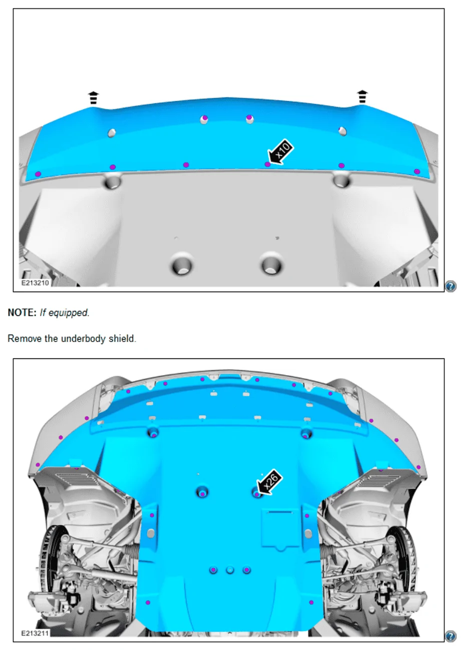

Ahh... here's what you're facing with a GT350:
There are 14 screws holding the splitter on (the diagram doesn't show it properly but there are two screws in each of the four forward openings in the splitter, not just in the middle two as shown), and once it's off you can remove 26 more screws and a handful of push pins to get the undertray off. It's tedious but not particularly difficult.
A side benefit of taking it off was getting two pounds of OPR (other people's rubber) out from on top of the undertray and splitter.
The bigger challenge when I did mine is that you only drain about 5 quarts out of a 15-quart cooling system. I'm not sure what Ford intended, but changing 1/3 of the coolant just doesn't feel like "changing the coolant" should feel. I used multiple drain-refill cycles to change out 70% of mine and then called it a day.
