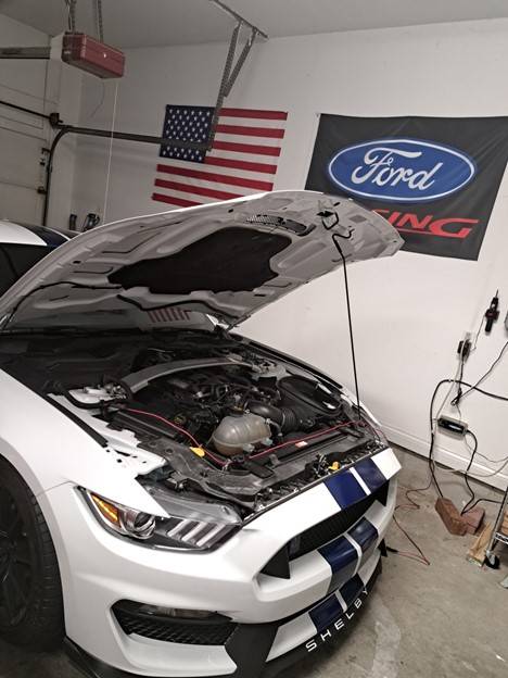

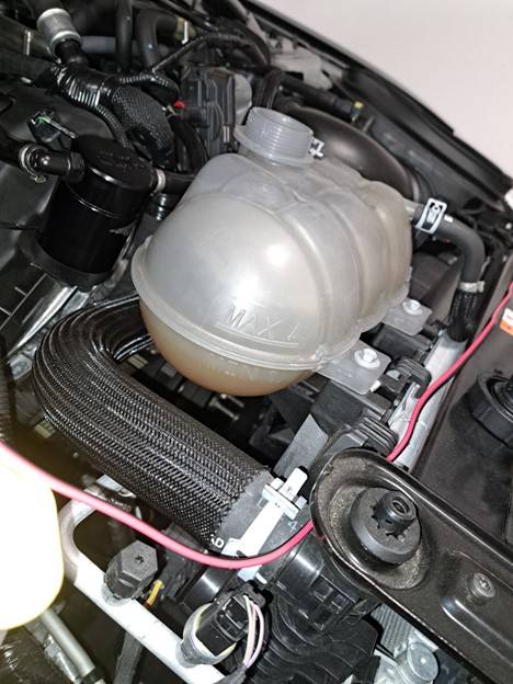

As mentioned, about a half inch below minimum line, wondering if distilled water is suffice and safe to top off? I'd think so, but I learn something everyday. Thanks!

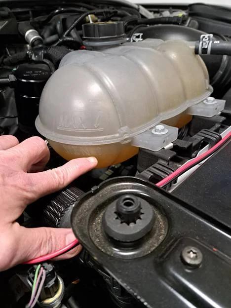

Updating with pics. Still since about a half inch below minimum line, wondering if distilled water is suffice and safe to top off?

Just buy a premixed jug of yellow Motorcraft coolant and top it off, unless concentrated fluid was used to begin with, in which case it should be fine to use distilled water.

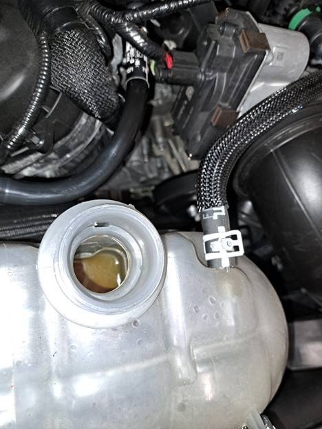

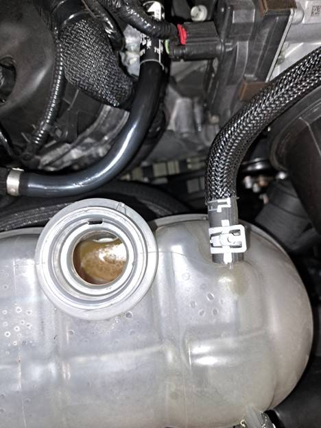

Next time, will not be going to dealer for underfill of coolant flush. Hell, atleast they could have topped it off, not leave it to me to do that. No way to even know if they actually flushed the coolant well, since it is still organgish and cruddy looking. Dumbass me trusted them to do it right, but I got crud of unknown origin or quantity. Lesson learned, do my own drain of coolant, follow directions, and I have the NEW bright yellow coolant that I added myself. Not orange stuff that Ford no longer makes.
