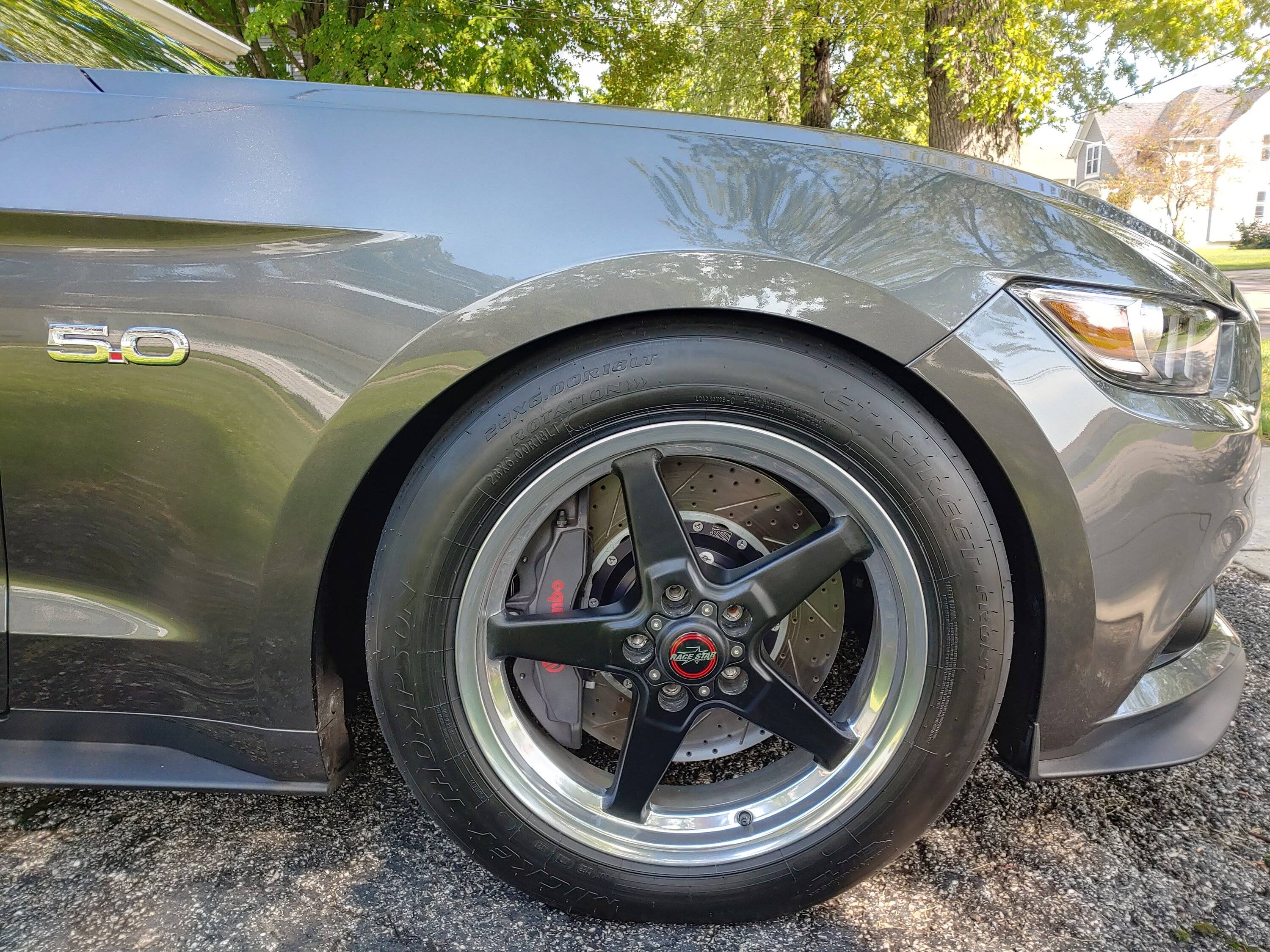

I have Racestar's with 28" tall MT radials that clear the Brembo's and don't rub. They're inexpensive when on sale but the lug nuts are an absolute pain. I would go with the Forgestar's like NGOT8R has if they're priced right.

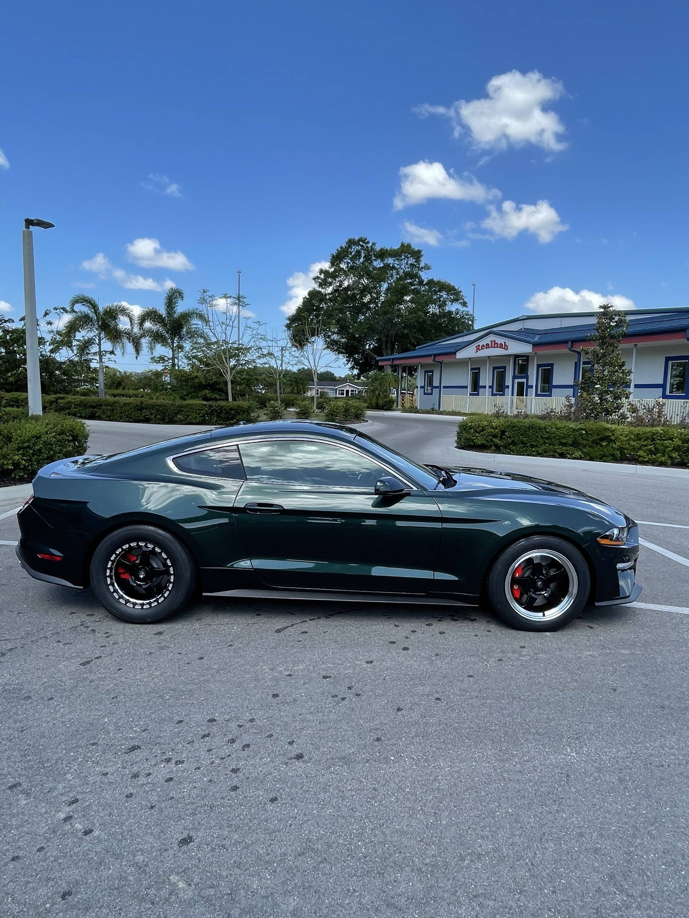

I was going to comment on the lug nuts. It’s been so long since I’ve had those wheels that I don’t remember what the exact issue was. I do know that I didn’t care for something regarding the lug nuts though.

For one thing, the tech inspector will question not being able to see stud threads if you want to drag race it. Also, the washers distort and get gouges in them. I'm trying some higher quality lug washers now.

You’re right, extended studs are the way to go. I had some on order through Steeda for over 90 days and finally canceled the order because no one had them (including ARP). I pressed my factory studs back into the rear hubs and called it a day. On the two test-n-tune track days that I attended, I took the necessary tools to r&r a lug and torque them back down after tech. It turned out that tech didn’t even inquire about it. I think would definitely check during a sanctioned event though.
