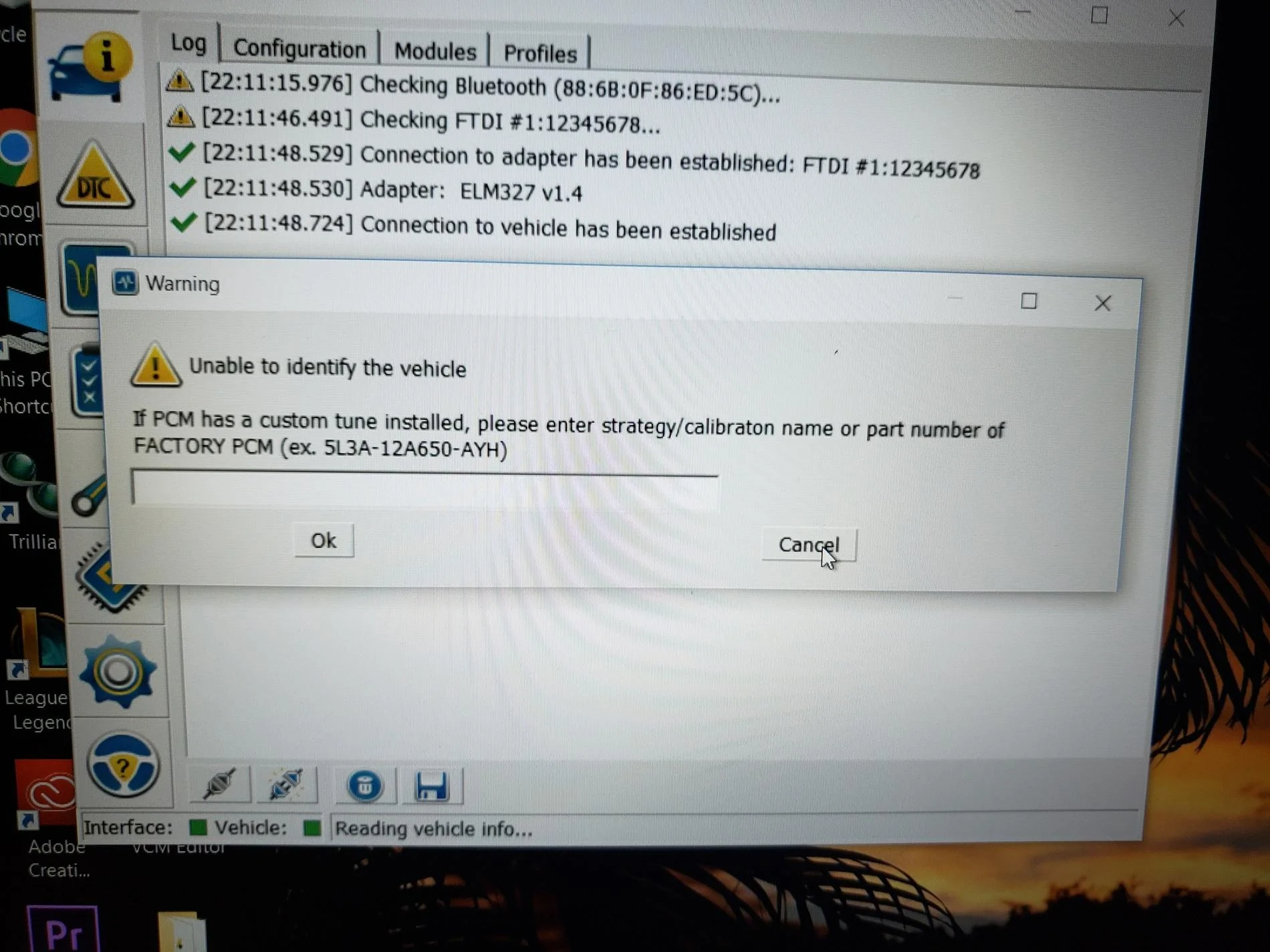

The horn honk is in the BCM. I wouldn't think ForScan would care if the car has a tune. My Cobb tune doesn't affect ForScan. I've made many changes with the Stage1 tune and a few after the Stage2 was applied.
Is ForScan not willing to proceed?

This is where I got stuck, apparently it cant identify the vehicle because custom tune. I guess I could try entering my current tunes name, or look up the PCM code.

I tried putting my tune name in and that didnt work. I included the .ENC though, I may try again without that. If not I have to get into my engine bay and pull back a cover blocking the computer part number and enter that I think.
