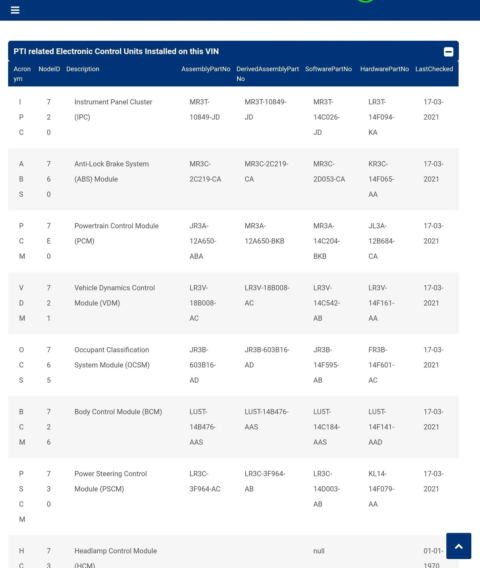

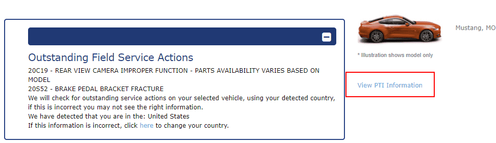

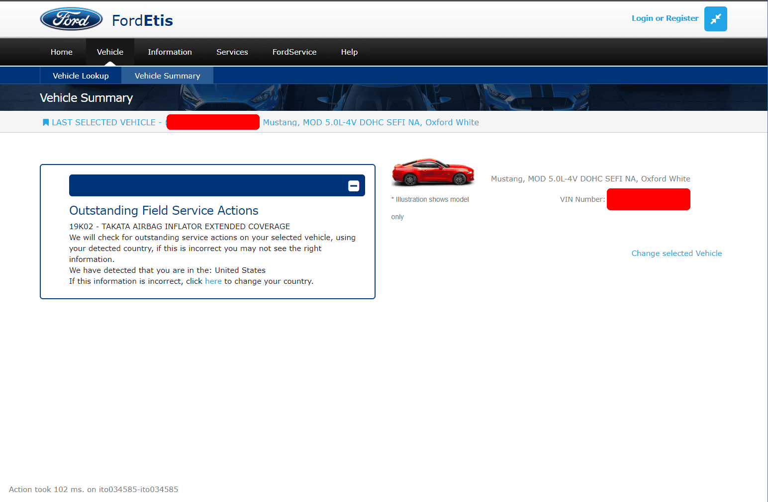

Interesting...mine is located here:
Not exactly sure why nothing pops up for you
Mystery solved. I found the URL for the PTI info page in a search and it contained the VIN, so I plugged my VIN in and got a page explaining why:
PTI Information
This vehicle was built before 20th May 2018, PTI Info available for vehicle build on or after 20th May 2018
PTI Information
Well, that sux.
