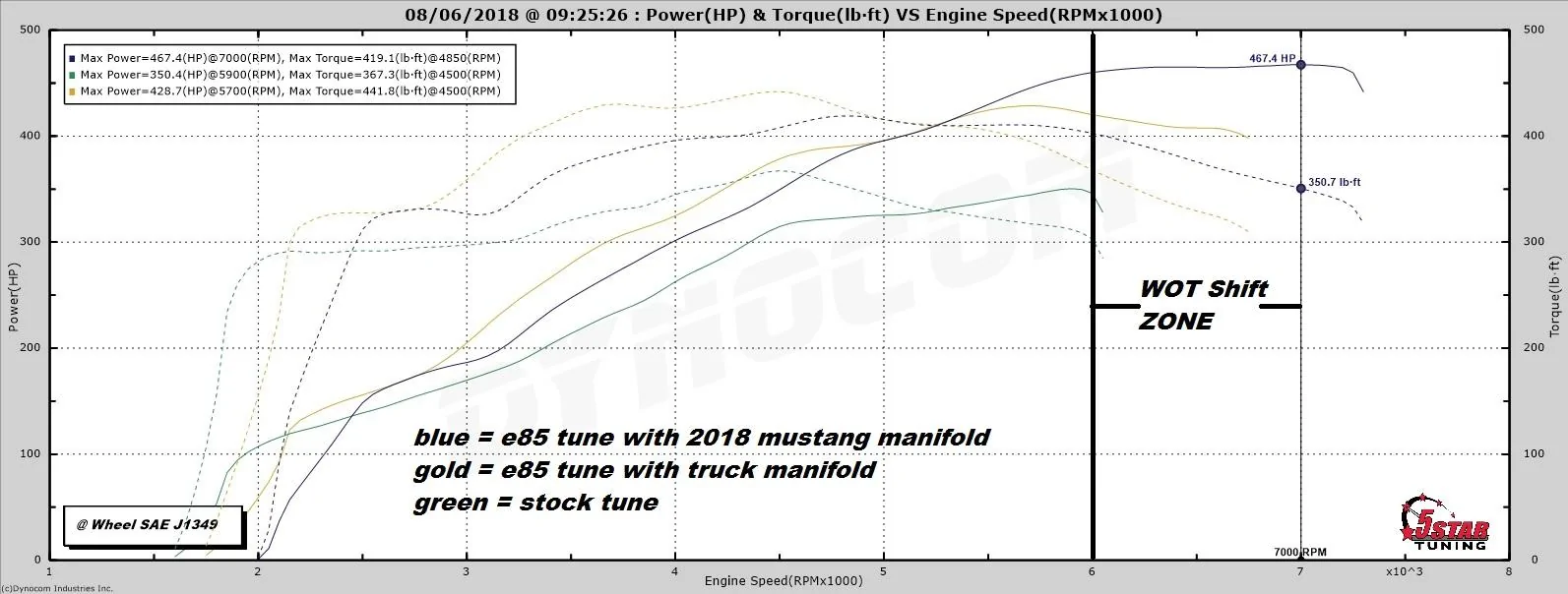

2018 F150 intake?
GT350?
The F150 intake will certainly be a consideration when the time comes to get the GT where I want it for the street. I will probably never see the track and very seldom full throttle redline runs so .5 sec or so slower at the track I will not care about. The thing is I planned to get a new GT that has a nice warranty and I NEVER imagined 450 HP was going to feel this slow while short shifting and driving around normally. I'd downshift, then downshift again and cause more attention then I would like with a high revving v8 coming down the road. So I was really disappointed I was going to need to void a warranty to have a motor that was going to be as fun as my turbo cars were in the past or big V8's from the long past.[/QUOTE]That said, if you want more torque, I believe the F-150 intake manifold will give it to you, and will bring down the max hp rpm by well over 1,000 rpm if my memory serves me correct. And you'll lose something like 80-90 hp and gain a decent amount of torque. And your car will be much slower because of it. But at least it'll impress at 2,500 rpm!
