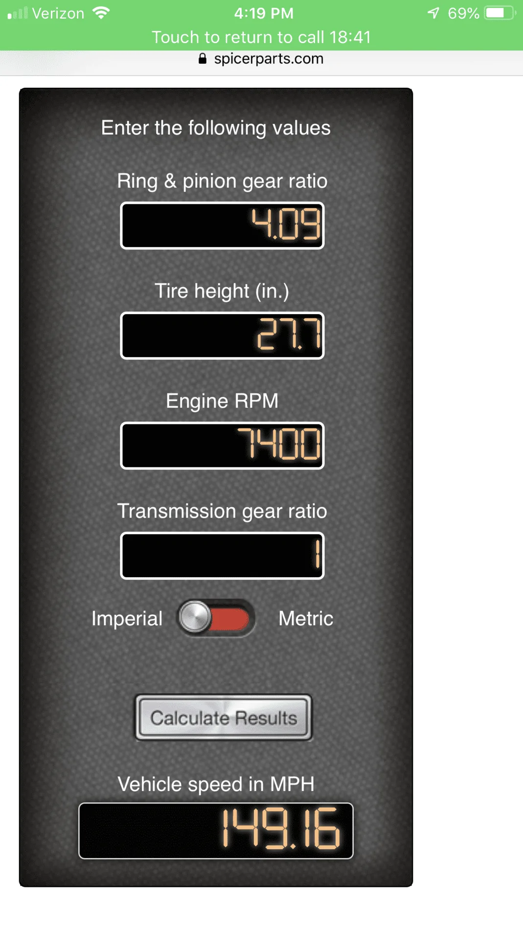

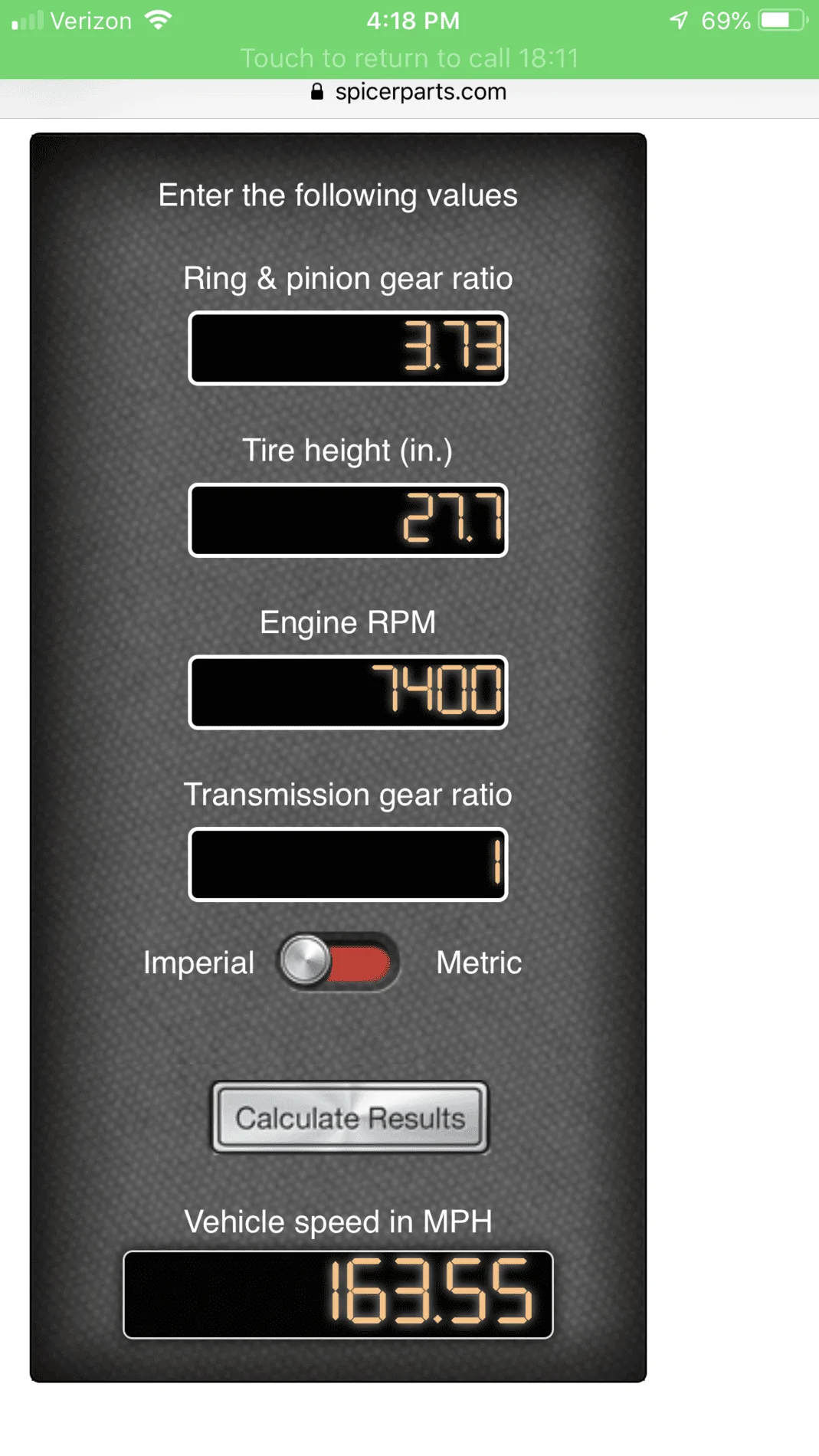

I just did the math, 4th gear with the 3.73’s would hit the speed limiter. Less than fabulous for solid acceleration.
4.09’s look better.
4.09’s look better.
My rear tires are 26.77" tall. (325/30/19) I would hit 158 MPH with 3.73's which would be perfect. 3.55's would hit 168 MPH.
