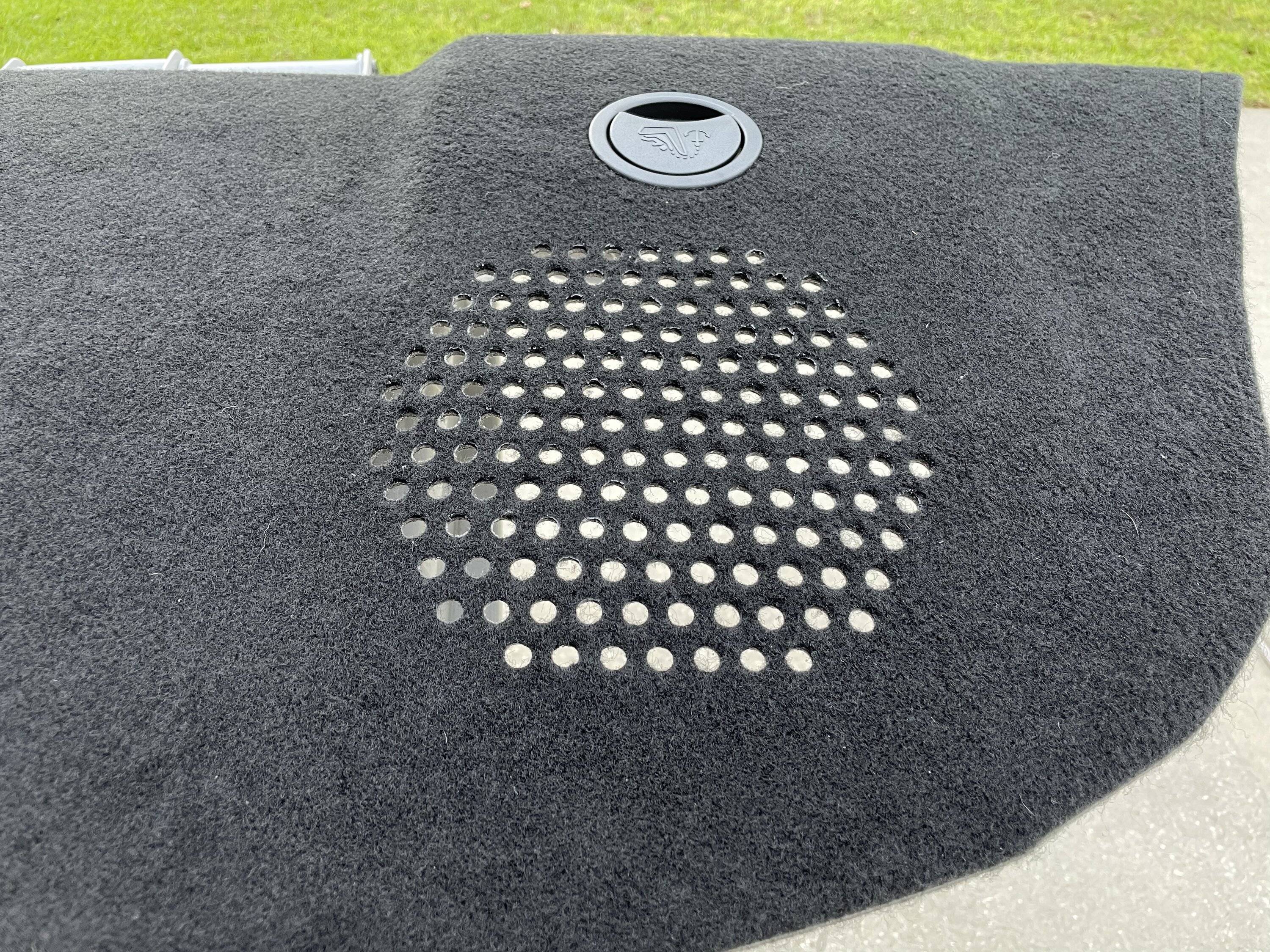

Replacing them is a bit of a pain as you have to strip the entire rear end of the cabin apart to get to them. You’ll need to remove both side 1/4 trim panels to get to the pins securing the rear deck panel. If you want to go this route I highly suggest using a 5/16ā€ leather punch tool and removing the carpeting from the vent holes in the backside of the panel like I show here:

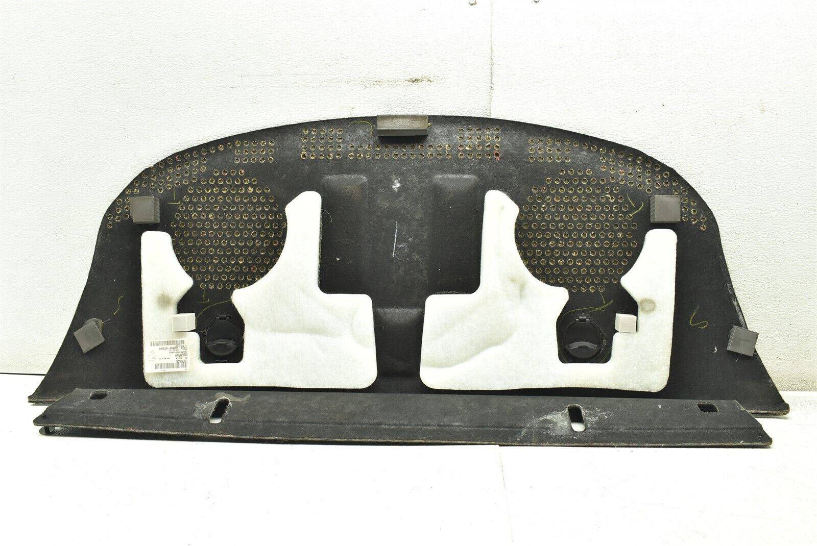

Thanks Doug! I also found out the rear package tray panel can be purchased for around $200. There are also already holes in all but the top layer. I doubt anyone else is as "keep it original" as I am, but if you do want to drill holes, there is already a guide from Ford there.

Yep, all ya gotta do it lay face down and use a 5/16ā€ leather punch to knock out the fabric from the holes.

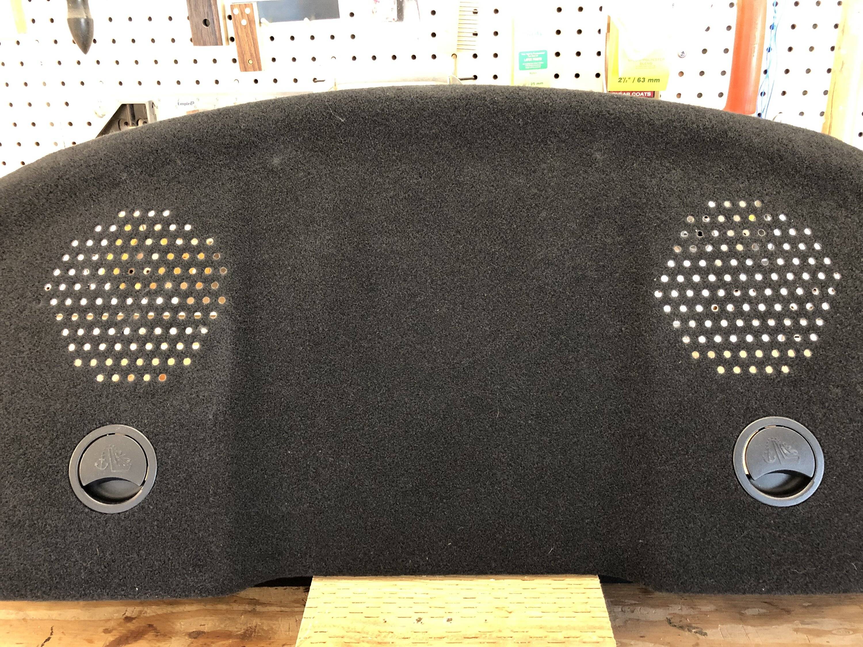

I have opened up the holes as @Evolvd did. I removed my rear speakers and opened the panel to let bass into the cabin. My subwoofer was making the rear deck flap so I had to create a pressure relief. Used the punch on a scrap piece of HDF board. You need a real hard surface for the punch to cut through the carpet. For heaven's sake DO NOT USE A DRILL. You will destroy the carpet as it will twist around the drill and rip off the panel.
