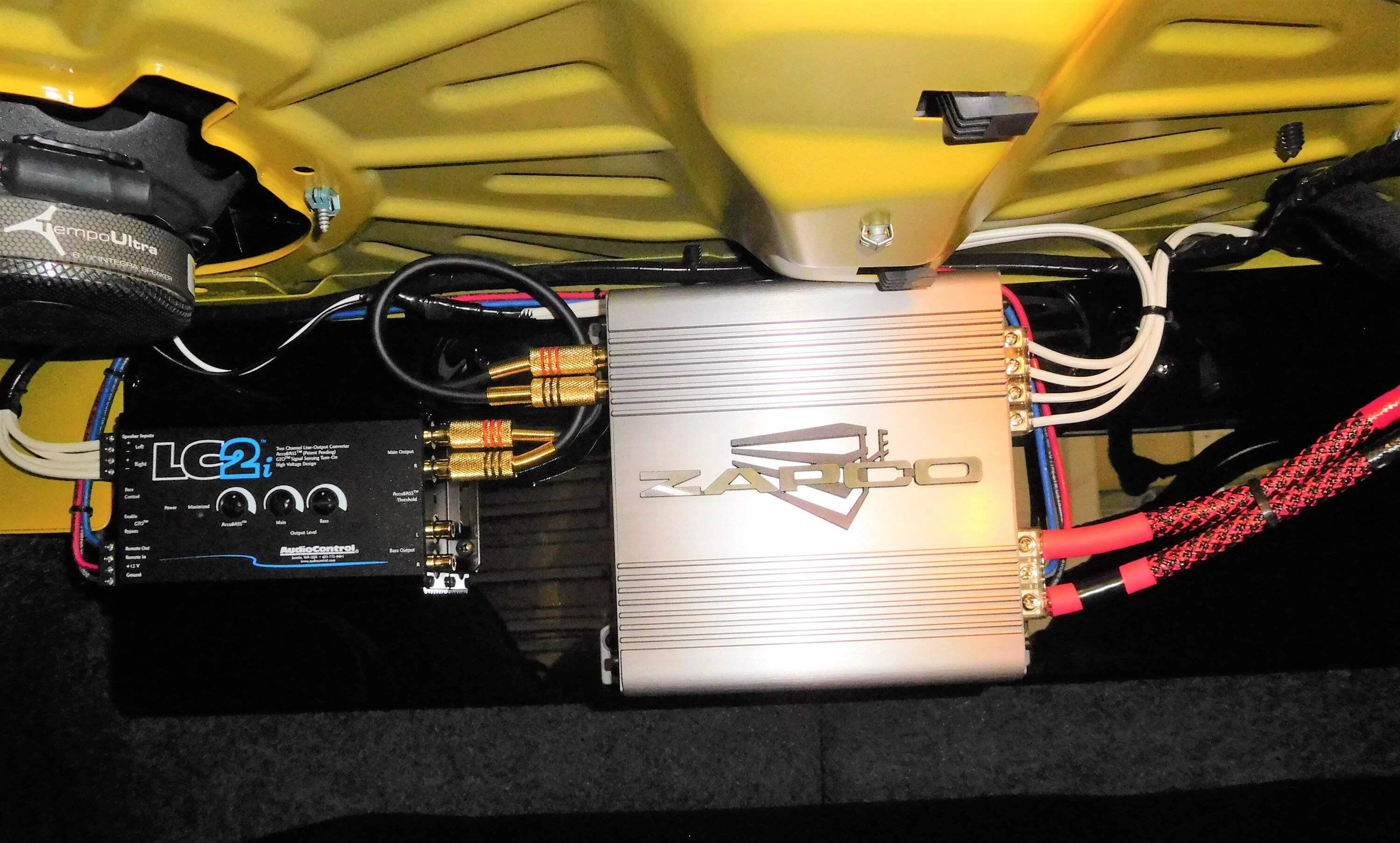

Or do this.....

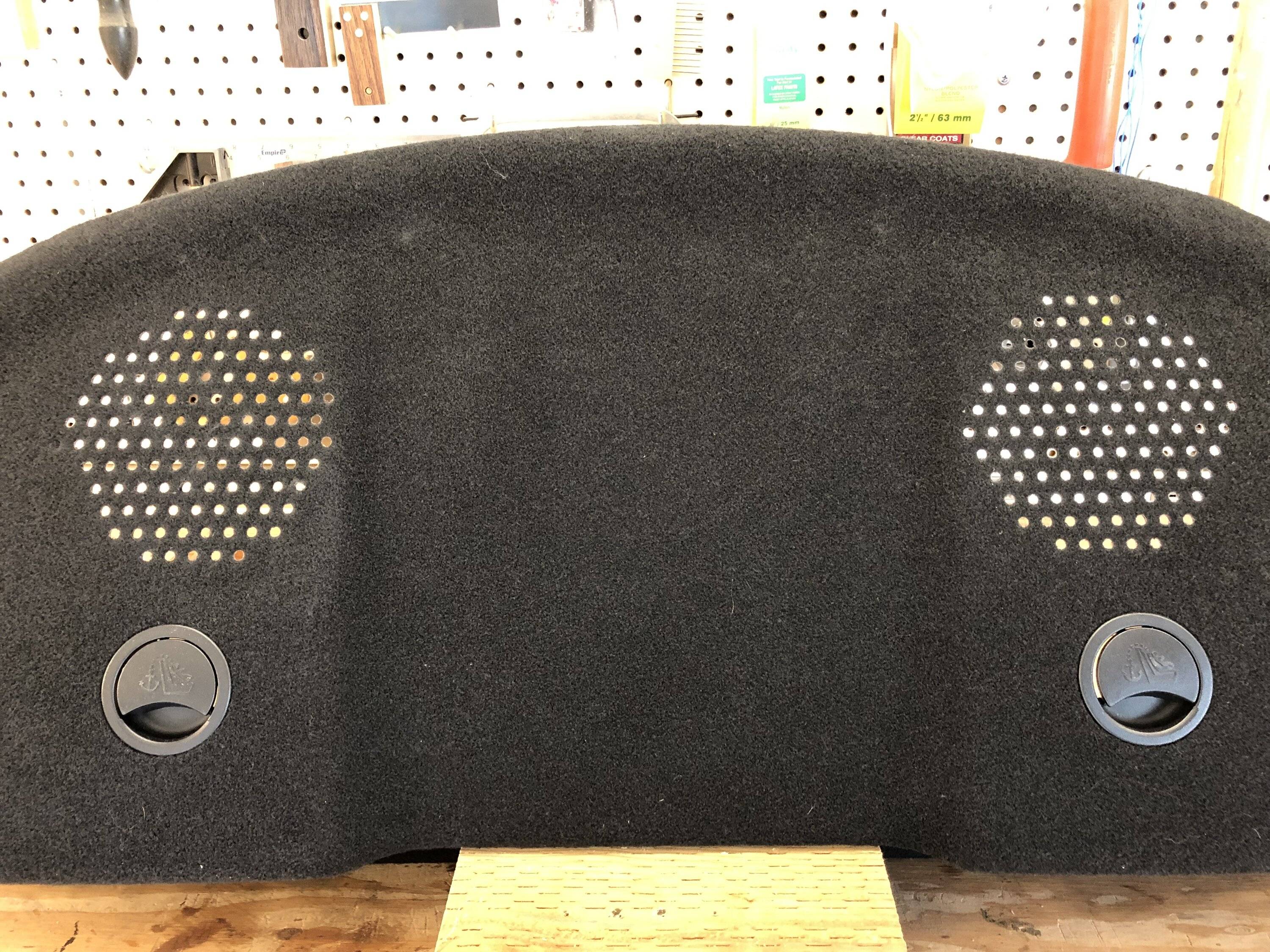

I don't know what I'm looking at here. Is it the holes?
The rear deck trim panel has holes in it but they are covered by the thick factory carpeting. This muffles the already craptastic speakers ford puts in there. If you want more sound to come though you’ll want to punch the carpet out of the holes. The hole is 5/16” and any leather punch of that size will work. However, removing that panel is a chore and requires your remove the rear seat quarter trim panels.
