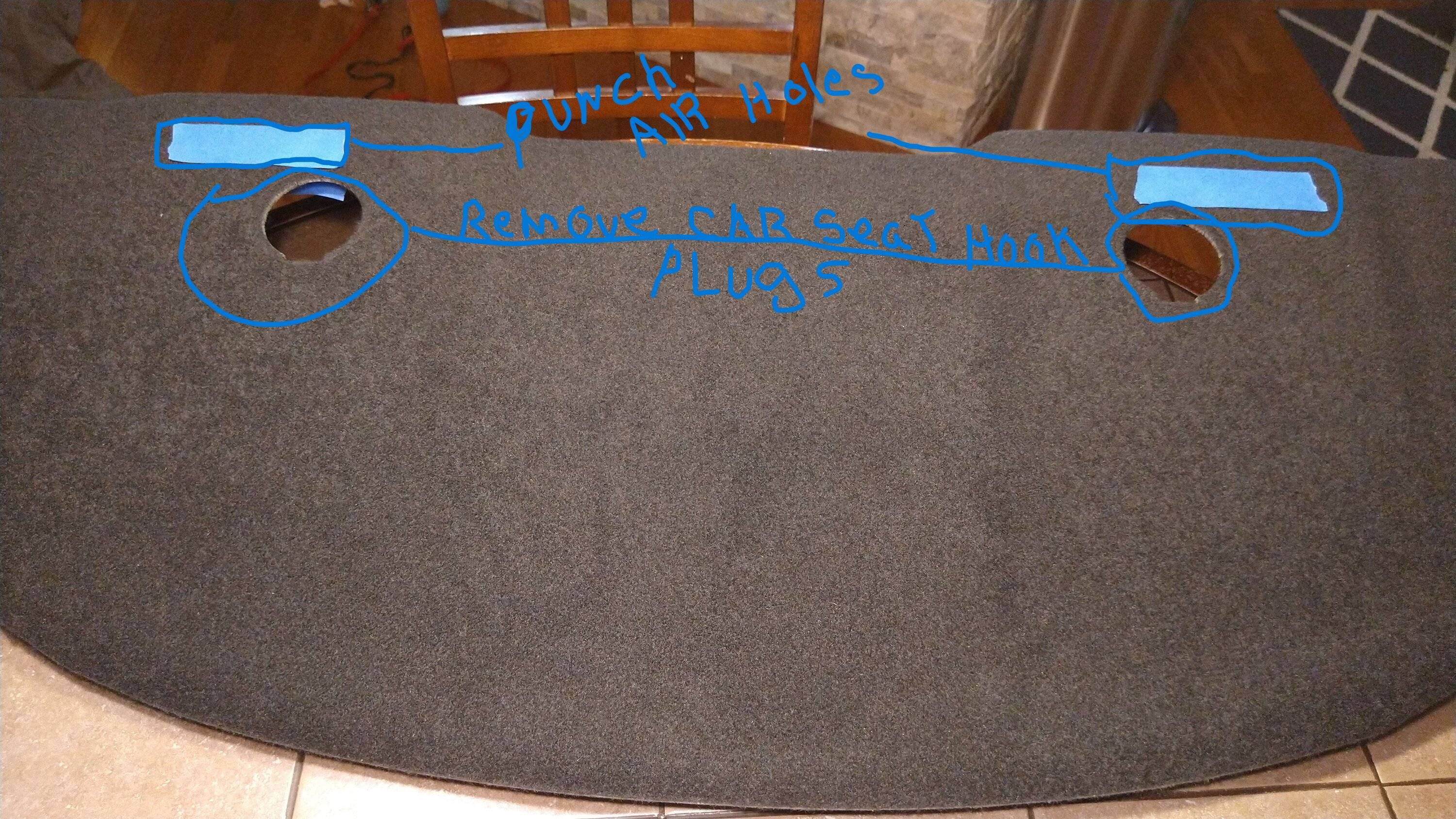

The rear deck speakers have three things going against them. One is that they are in an infinite baffle location (meaning they have nothing to contain and amplify the acoustical energy like a box or door), they are cheap paper cones, and the rear deck trim panel is so thick it chokes off the acoustical response.
Replacing them is a bit of a pain as you have to strip the entire rear end of the cabin apart to get to them. You’ll need to remove both side 1/4 trim panels to get to the pins securing the rear deck panel. If you want to go this route I highly suggest using a 5/16” leather punch tool and removing the carpeting from the vent holes in the backside of the panel like I show here:

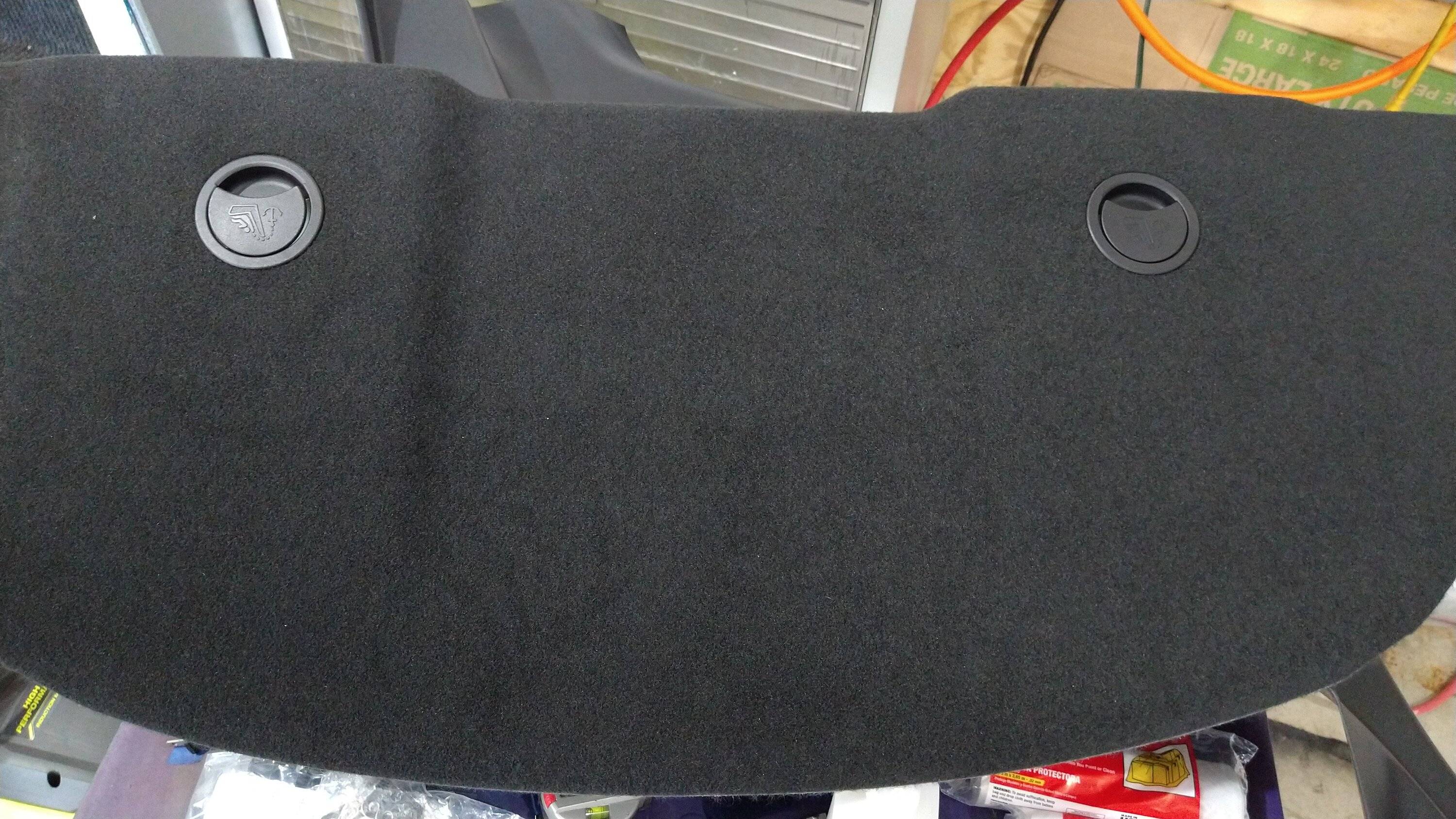

Man your right. Ford covers the rear deck speakers, no wonder they don't put off sound. I will punch the holes out before reinstalling lid.

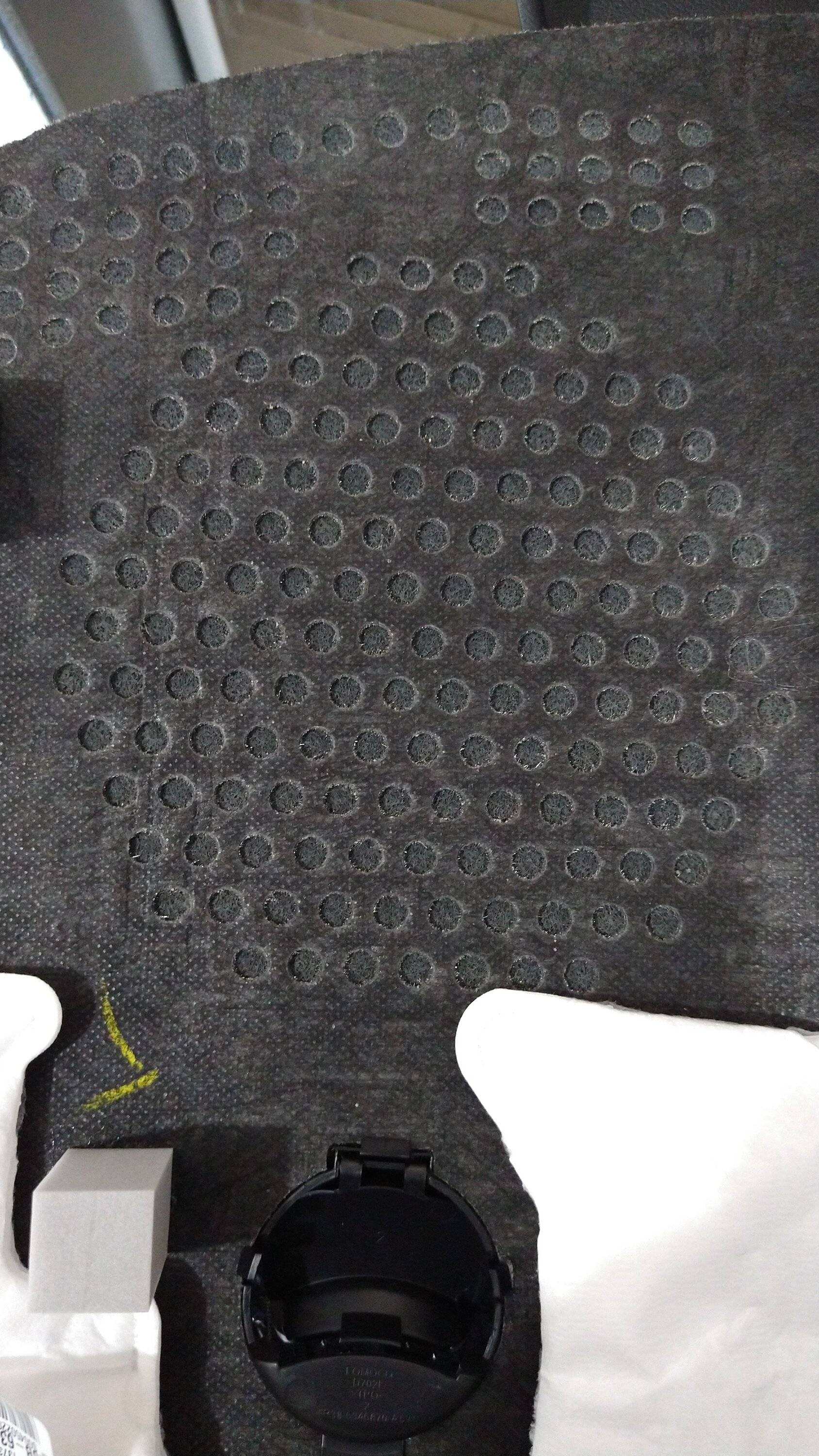

Here’s the holes I punched. You don’t need to do all of them, just the ones directly over the speaker.

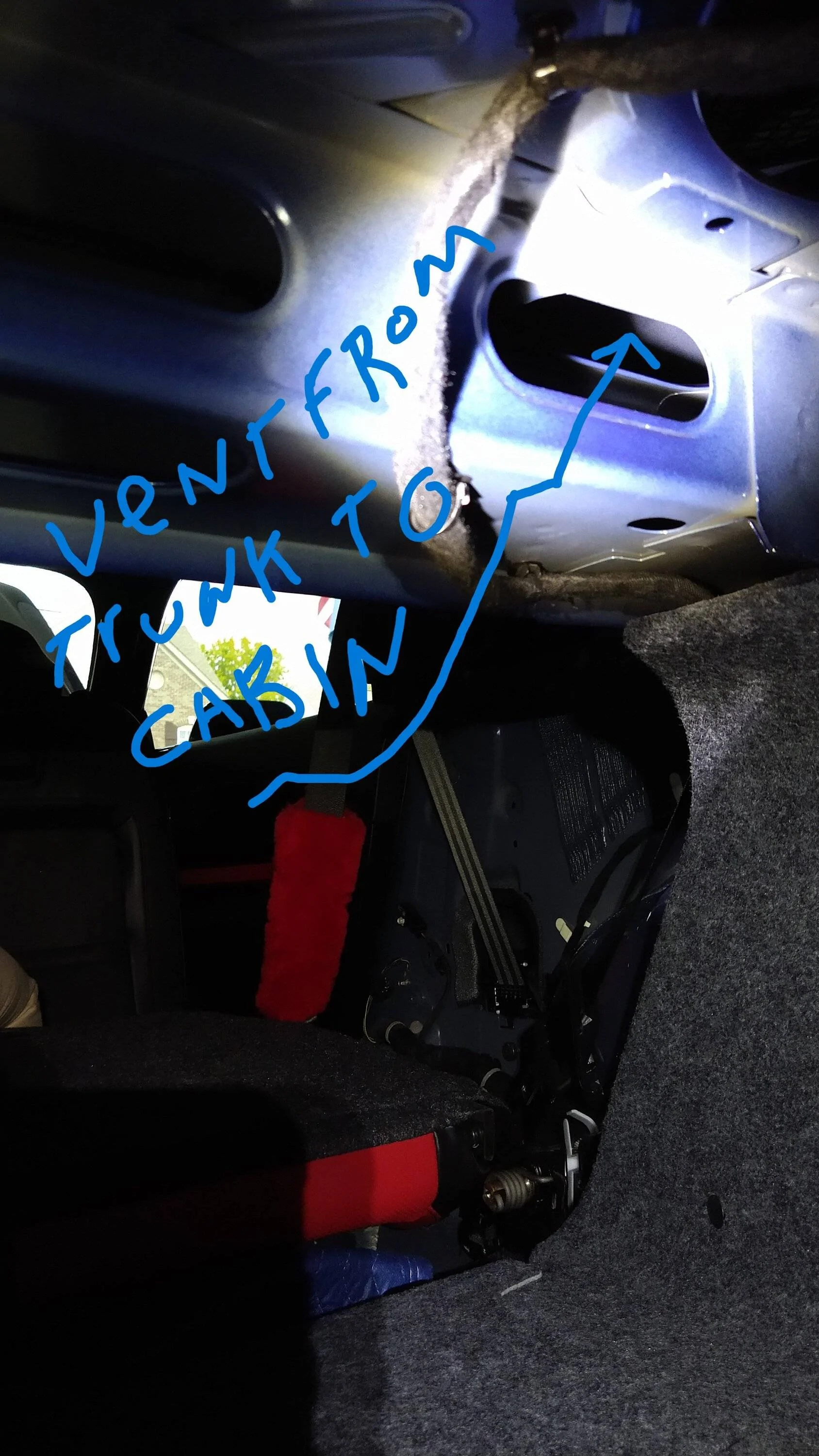

Looks great, I plan on doing the front holes which cover the trunk vents for the bass to easily pass through

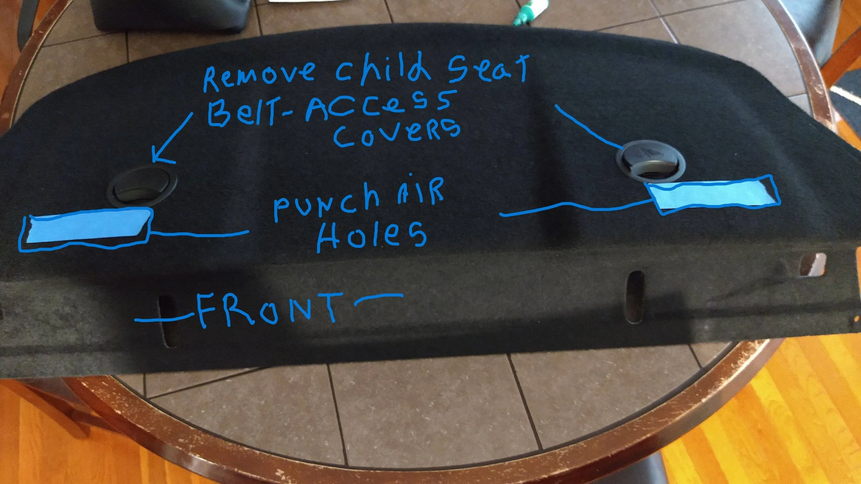

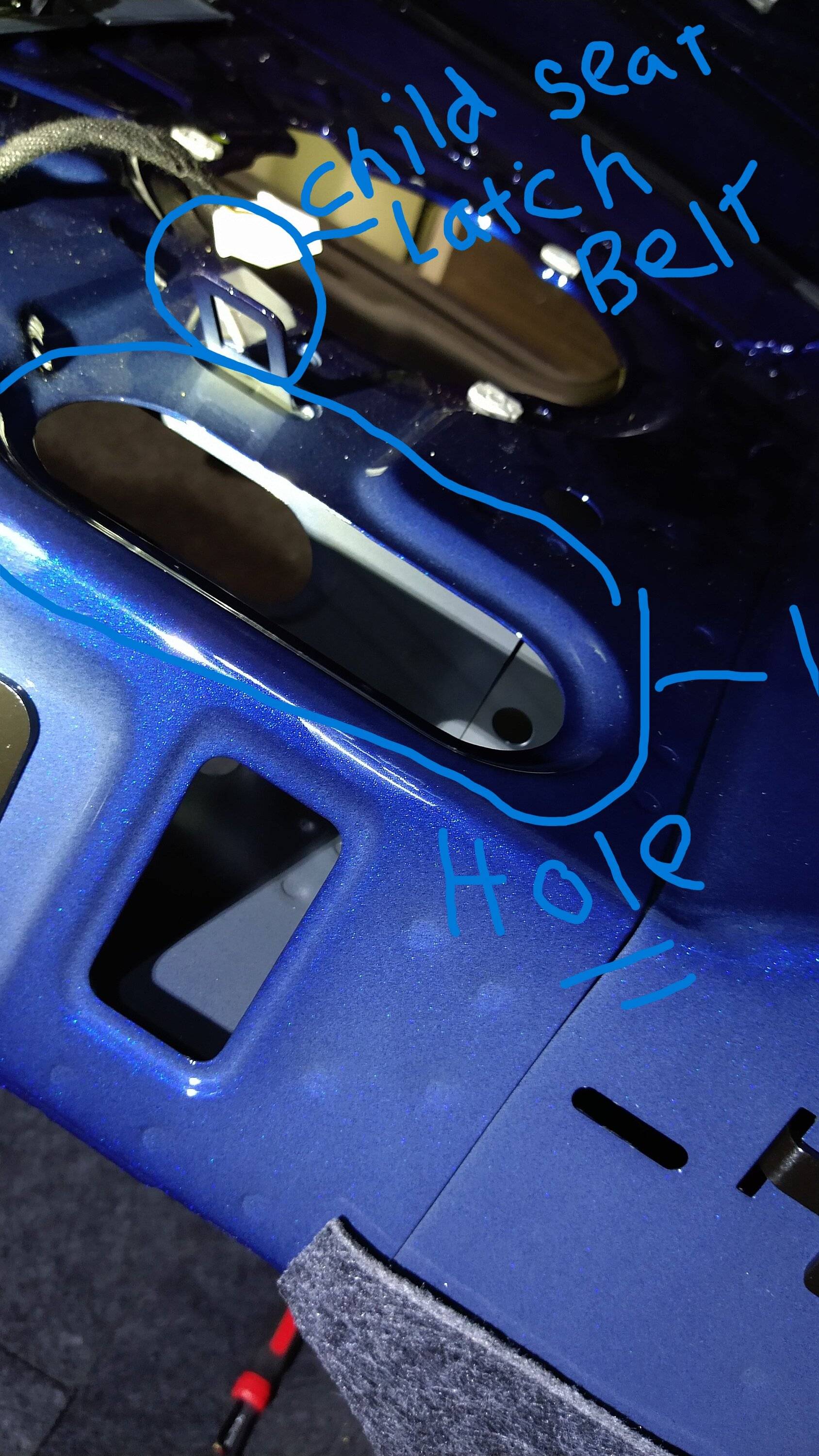

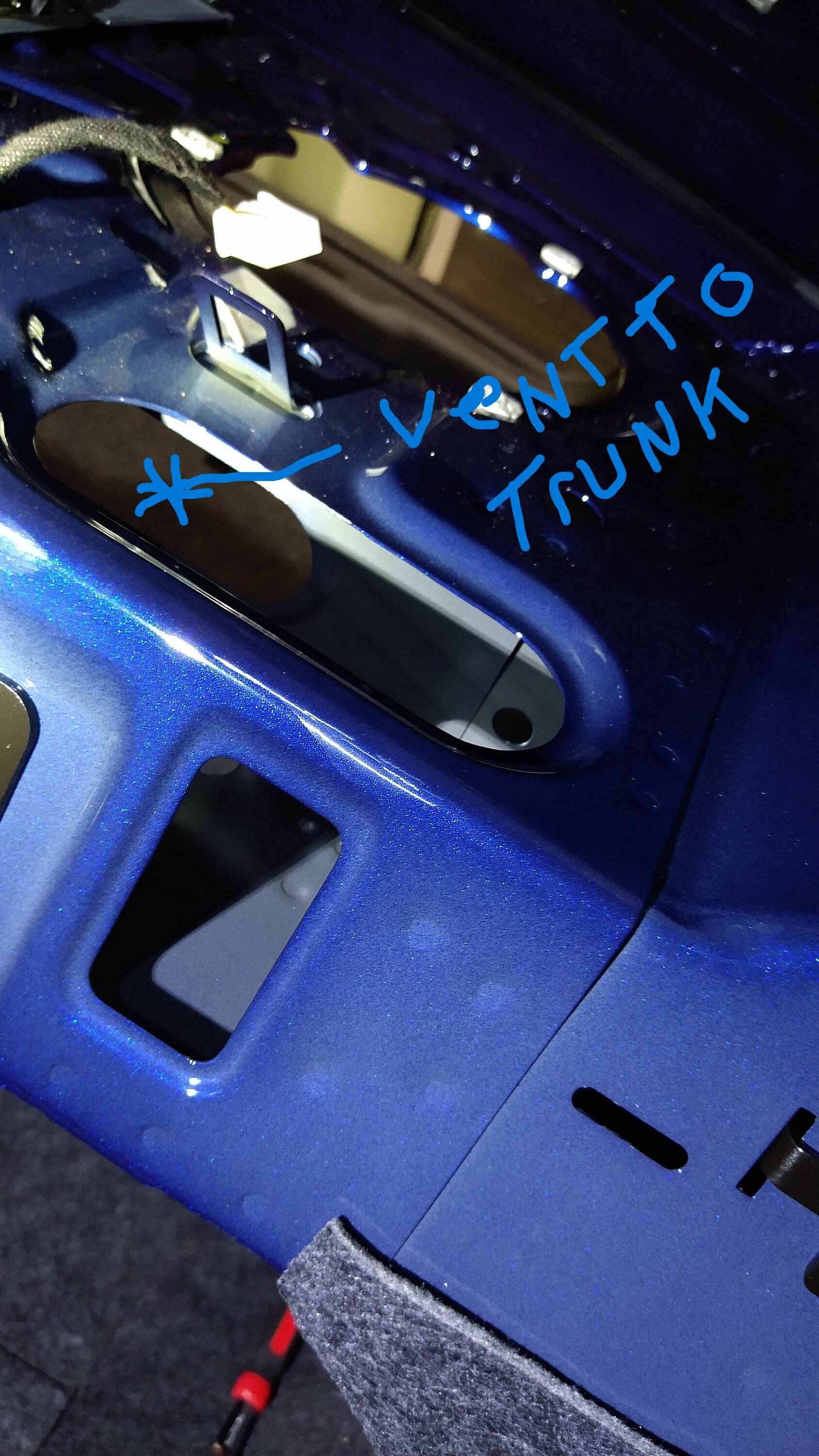

What front holes?
I will punch Holes where the vents are just like I will do to the Over the speaker Holes I will punch.

Ah I see. If you want to have a cleaner look I’d recommend spacers on rear seat latch. There’s a thread on here about it.
I will look for them if I can find the thread. I will probably just remove the pop up lid from the child seat access hole panel. It would look like a real panel vent port.
