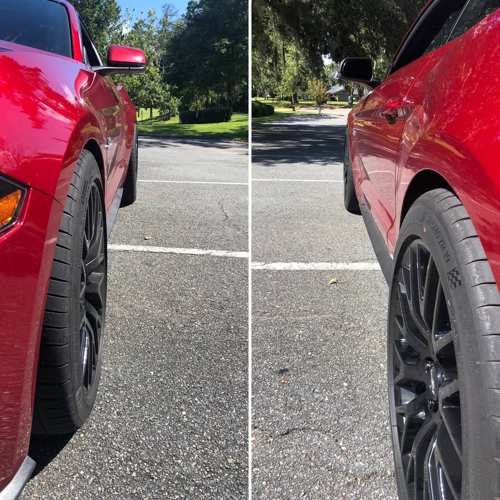

I was running 30mm (approx 1.2") spacers on my front factory PP1 wheels with no problem. Car has Magneride

take a Bullitt wheel off and see if the backside has pockets. I would expect it does. If so and they are >5mm you should be fine. But the correct answer is extended studs and slip-on spacers.

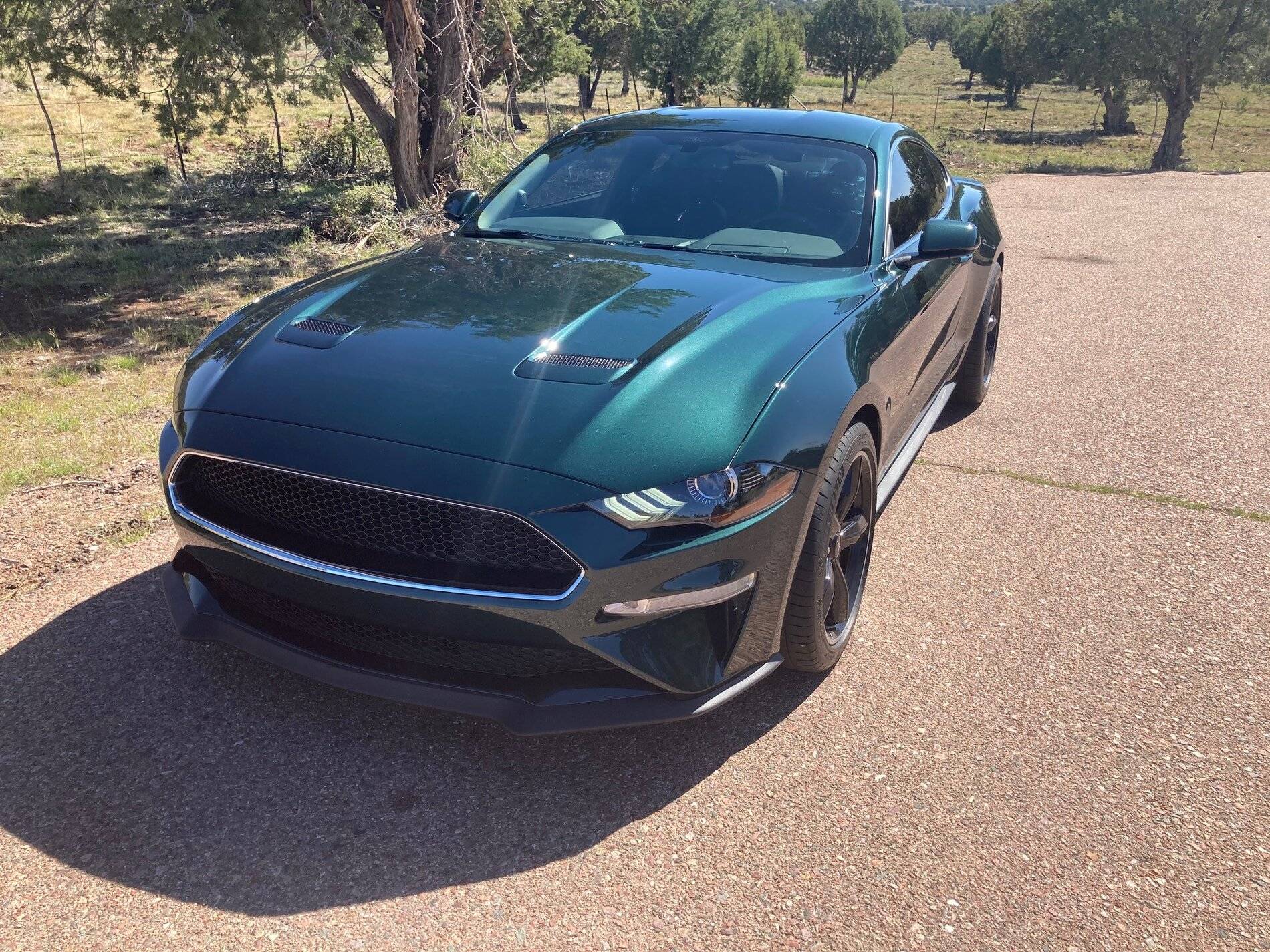

I have a 2019 w/Magnaride and have the Steeda 1 inch front and 20 mm rear spacers. No cutting required.

Could you post some pics of how it looks please?
