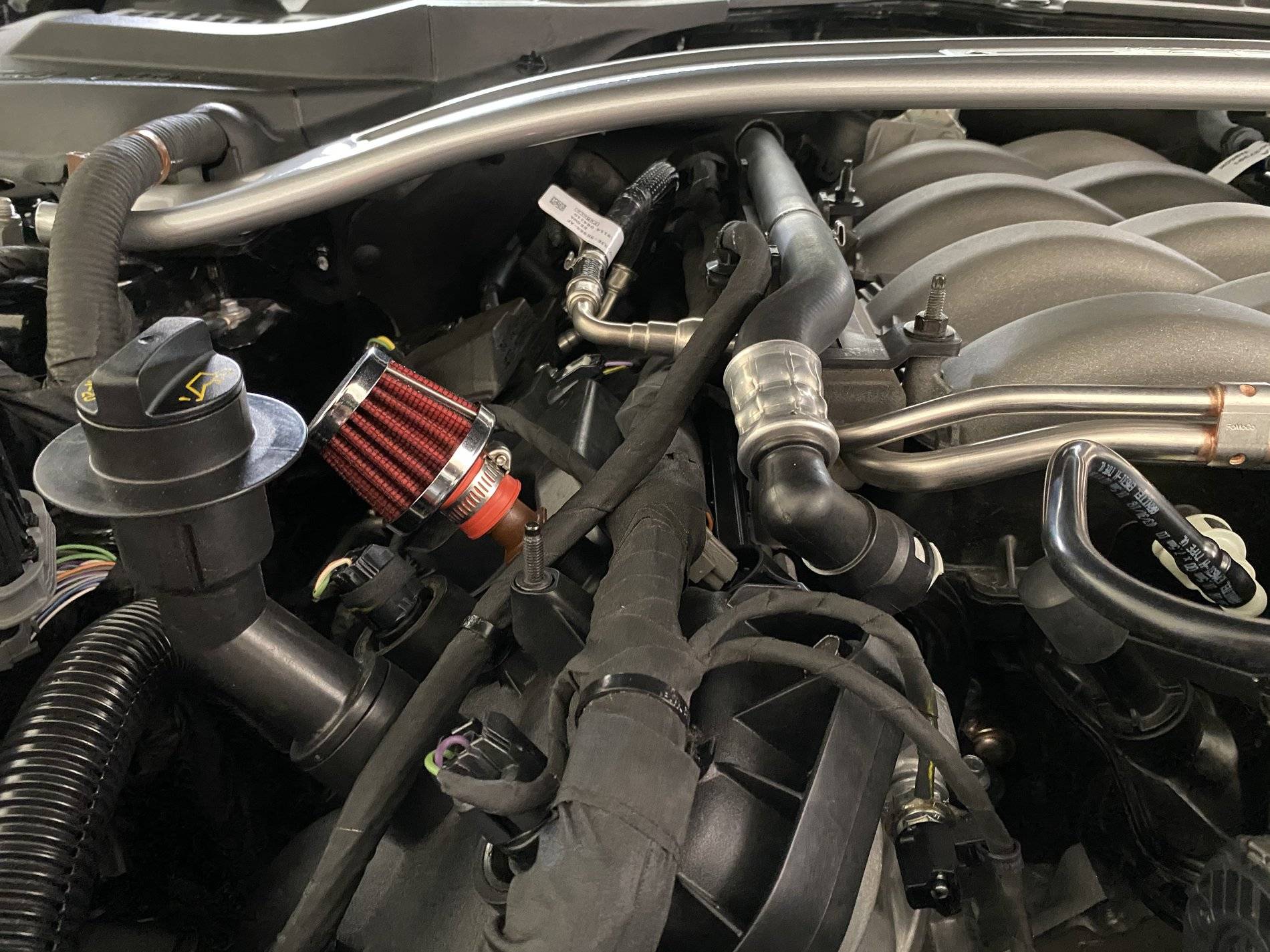

Fuck the EPA. I have run this setup for 10k miles (passenger side) will zero issues or messes. Kill two birds with one stone w/ crank case ventilation. ;).
That's just stupid. Every time I see a setup like this all I think "old guy from the 50's that has no idea how modern engine systems works, or a Honda owner that went to Pepboys."
The hose is connected back to your intake after the MAF, so the CPU is accounting for that bit of airflow in it's numbers. It's air the computer interantly accounts for in it airflow number claculations, so by doing this you're basically making your AF numbers be slighlty incorrect, and you've added a hole to your system that air can escape the sealed system out of. Air should not be able to ENTER your engine any way BUT your intake tube, and escape it anyway EXCEPT your exhaust.
Maybe I'm missing something but not sure how this set up is a problem as he appears to be just venting his valve covers to atmo. If it was still plumbed back into the intake then it'd be a problem ie leak.
As for the ECU accounting for increased airflow after the AFM where's the air coming from? The vac is applied to a sealed system so the airflow is negligible. For airflow sufficient to affect the mixtures you'd need a leak ie hole in the block or sump.
Follow the tube that he removed. It DOES go back to the intake, the system factors that air circulation into it.
