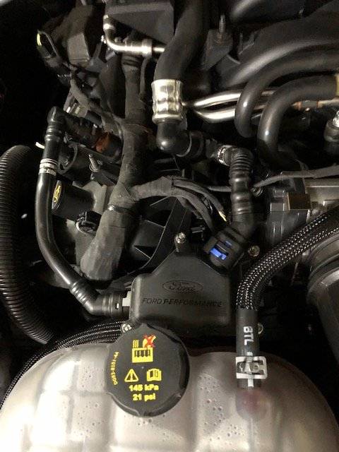

:thumbsup: what he said. if it were not for my catch can (oil separator) this would be going right into the intake .....

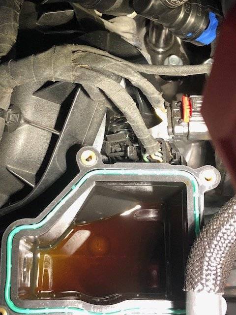

you guys should pull your intake and check out how much oil you prob have pooling in there...

This picture is pretty much what mine looks like after about 2000 miles.
So, answering the "Do they work?" question: Yes, they do, and it's not a debatable position. Catch cans absolutely remove oil vapor from the intake air stream and prevent it from going further into the system and through the valves.
The implied question that wasn't asked was "Are they worth the effort for normal driving?" That one drops into "Opinion / YMMV" territory.
