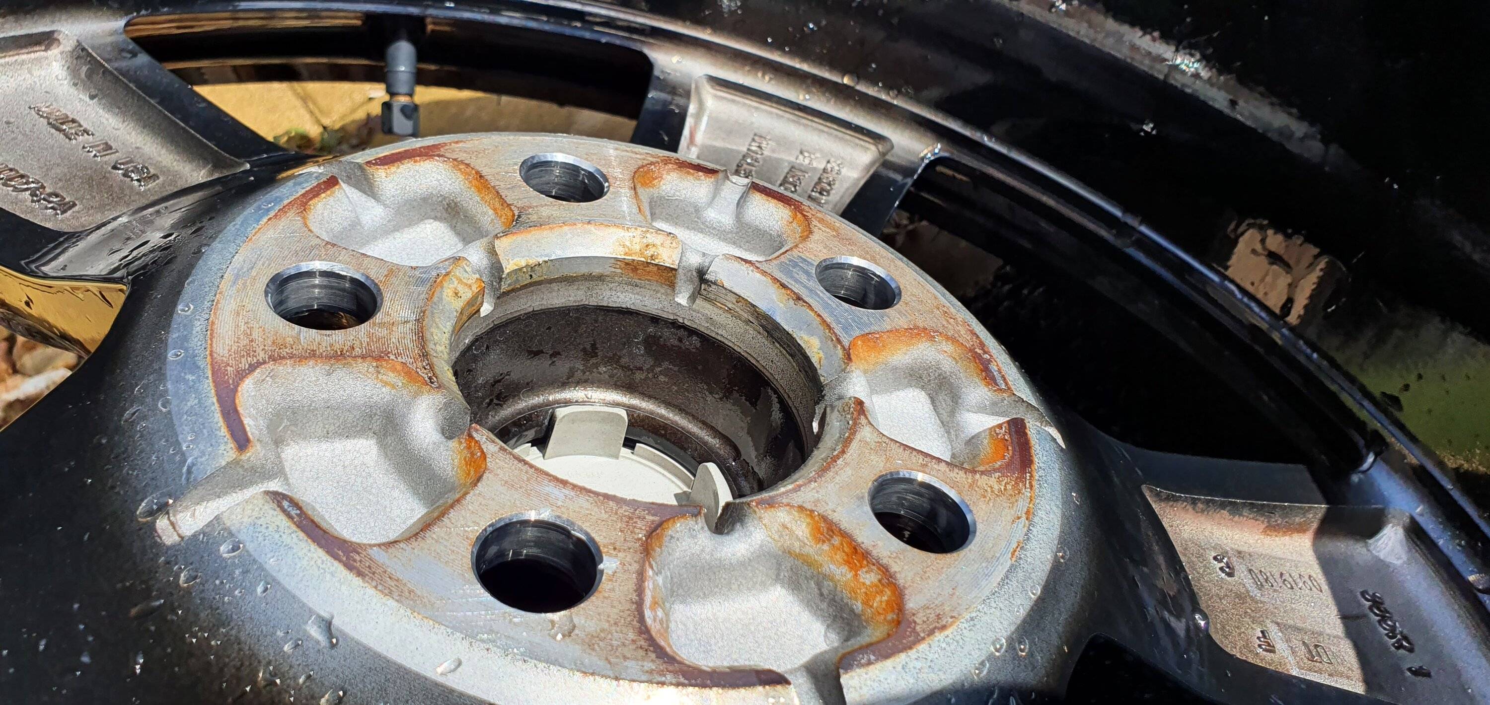

I am looking to fit 20mm spacers, front and rear, on my 2019 Bullitt with magneride.
I have heard the stud lengths can be an issue on the GTs due to their wheel choices. I have taking the wheels off the Bullitt to see if i will have the same issue and I'm not sure if i do:
Can anyone confirm if i will have an issue with stud lengths with 20mm spacers given the recesses in the stock Bullitt wheels?

You look like you'll be fine as the rims already have the recesses.

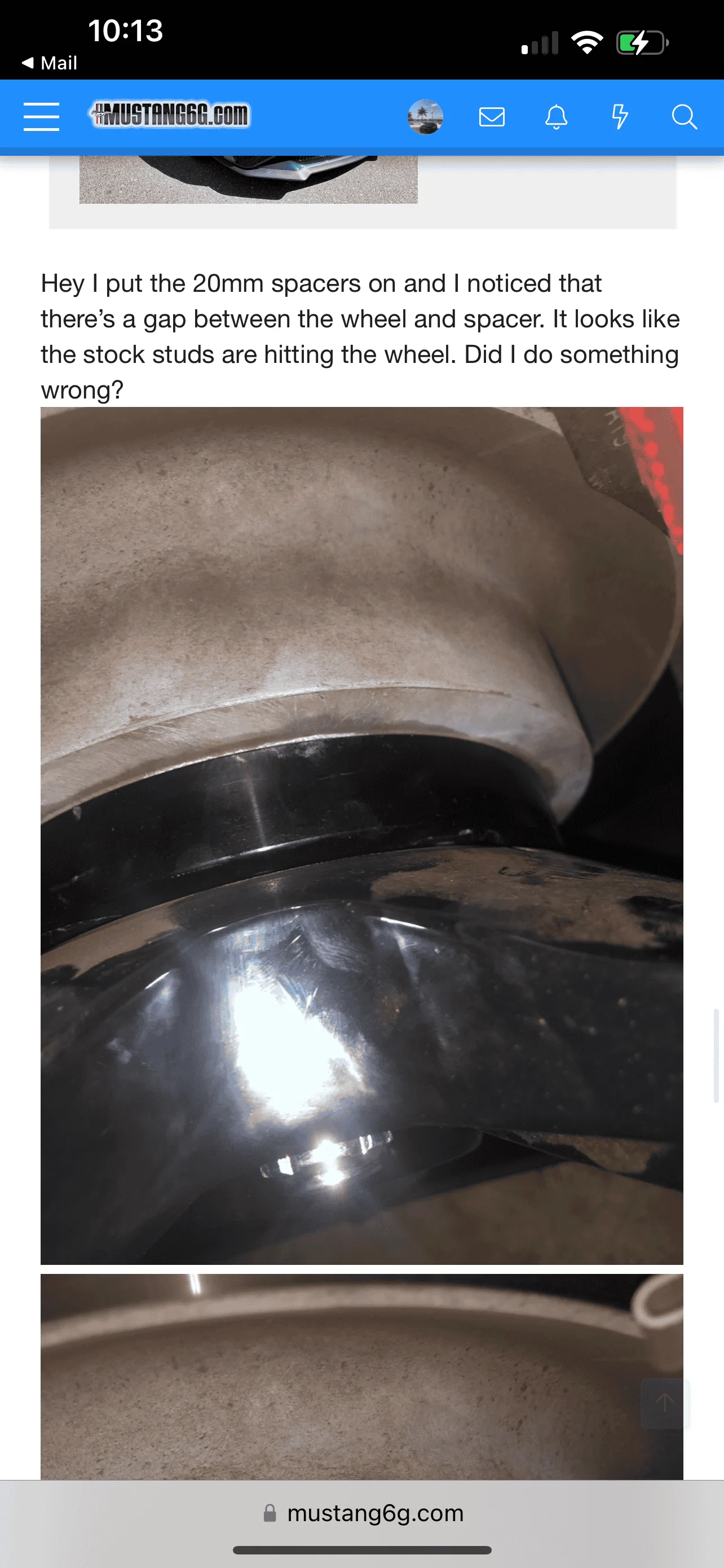

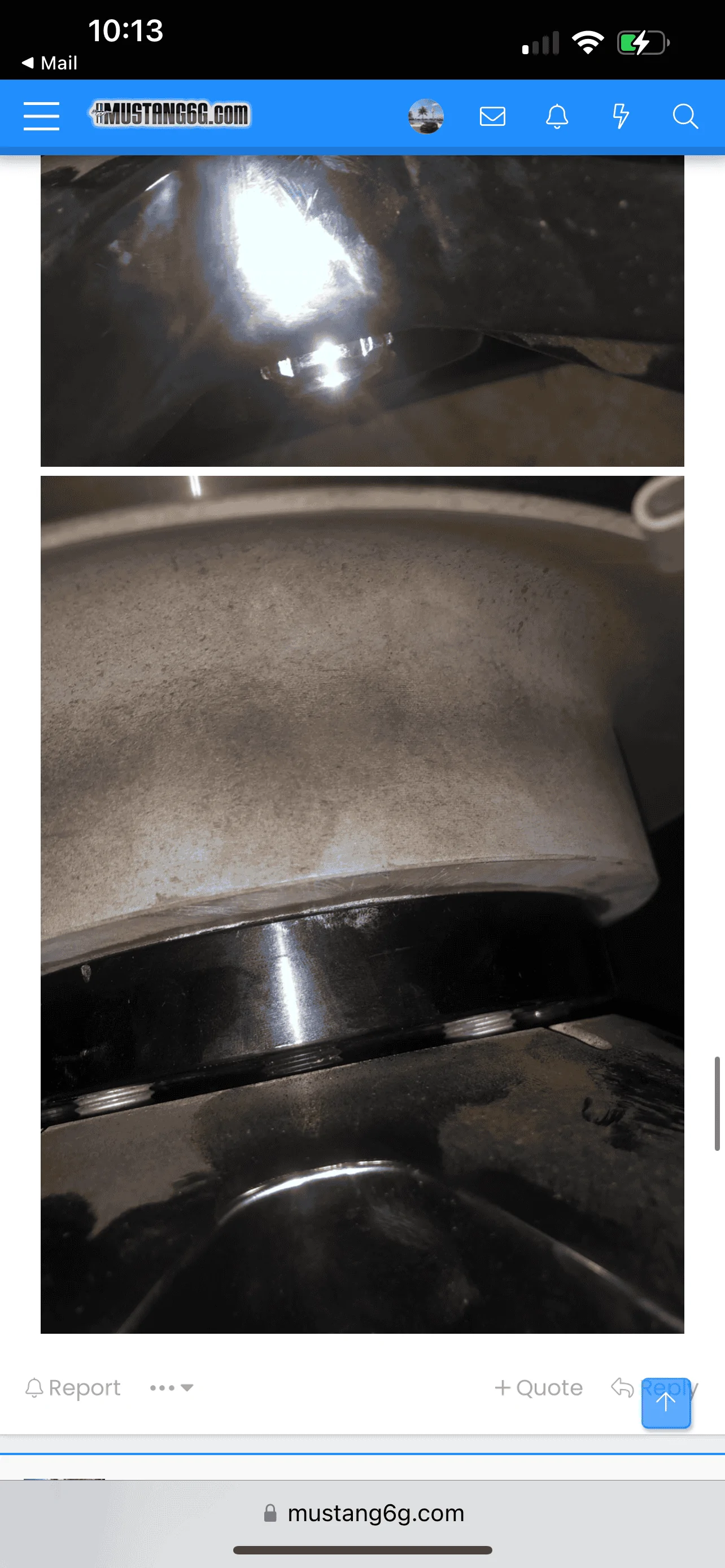

The 20mm will not fit magneride cars in the front the studs are too long. I had this happen to me look in my old thread I believe it’s called spacers on bullitt. You need at least 25mm in the front. The rear however will fit the 20mm, for some reason the studs are shorter. I’d recommend 25mm in the front and 20mm in the back, it’s what I have. It gives a flush look all around and is also what steeda recommends.

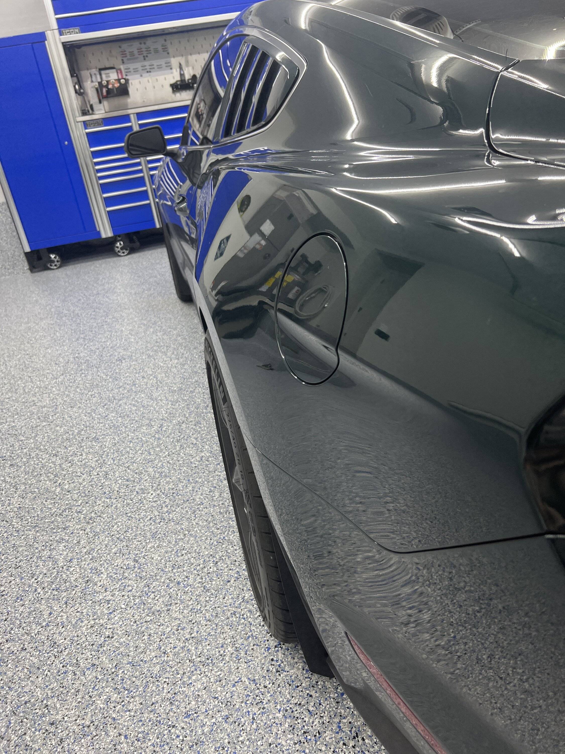

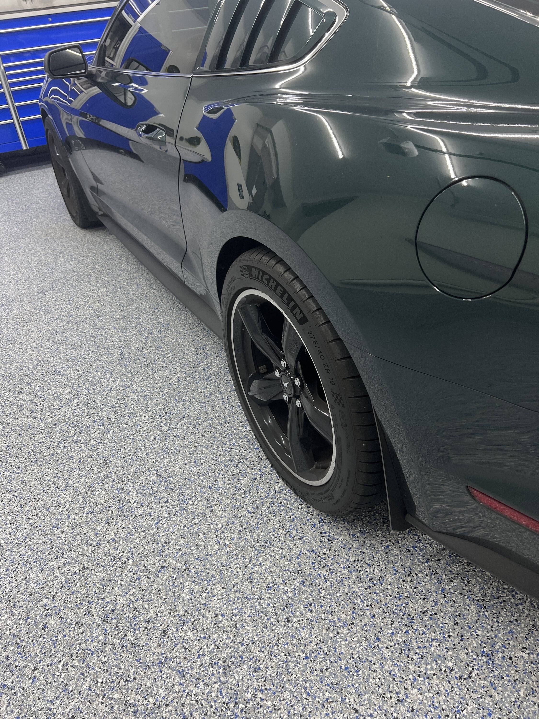

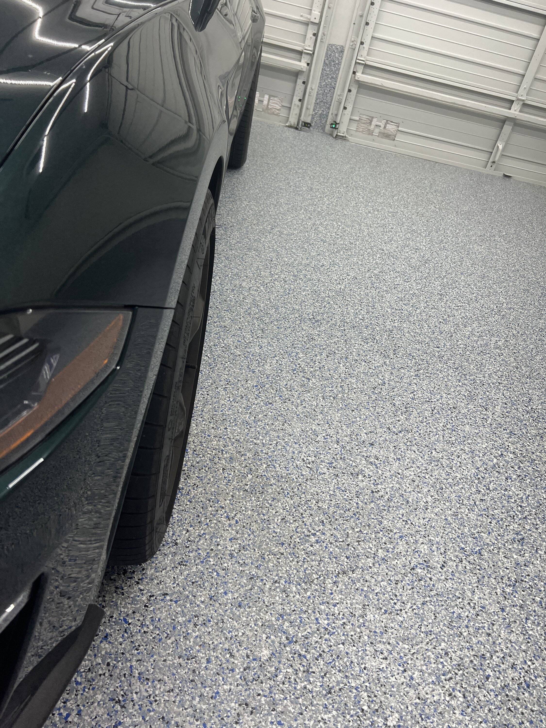

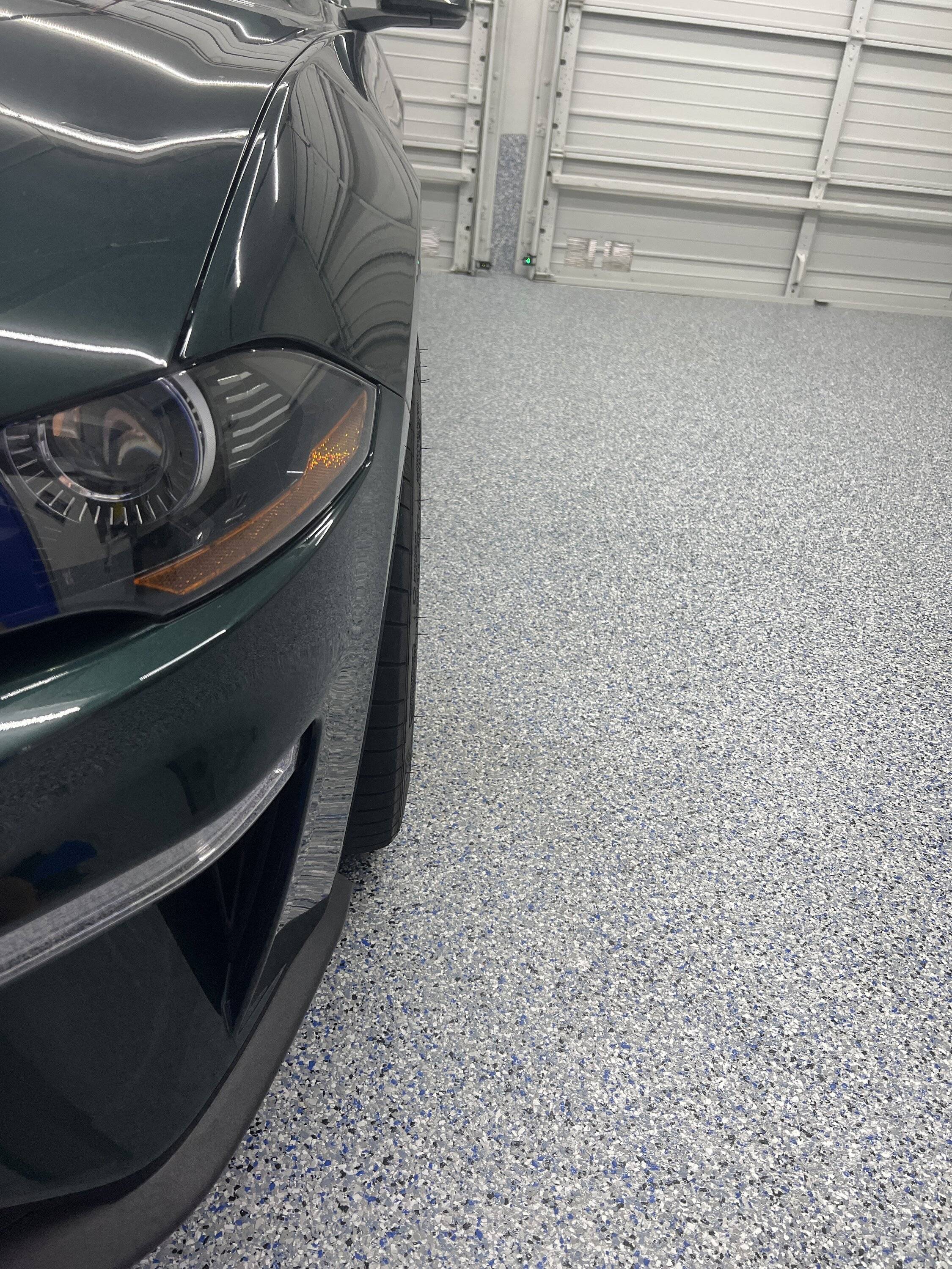

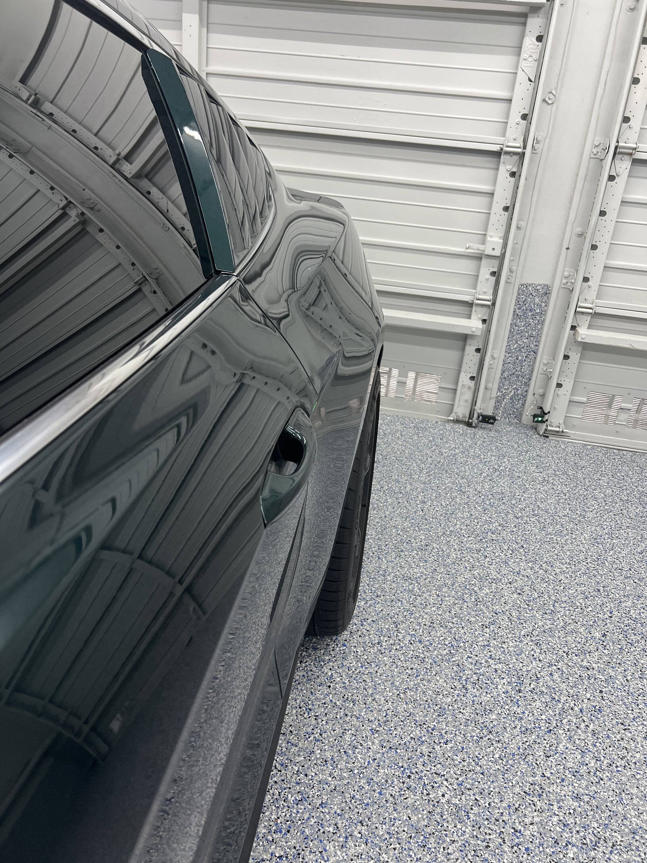

Here’s some pics of the fitment. It’s flush all around. You can’t ever look at stock mustangs the same once you see one with spacers the stock offset is horrible. Yea I put rokblokz mud flaps all around just in case so I wouldn’t get any paint chips.

Looks insane mate, thank you for sharing. This is definitely the fitment I'm looking for.

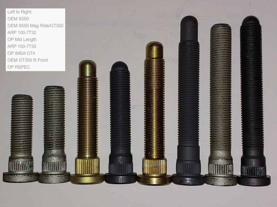

The Magneride front hub/wheel bearings are totally different from non-Magneride cars.
I agree with Anthony that 25mm up front is better looking. I went with extended studs and use slip-on spacers instead of the bolt on style. I used the front wheel bearings from a GT350R (the wheel center section on the carbon fiber wheels is INSANELY thick thus really long studs) and the Ford Motorsports rear wheel bearings with the ARP studs with 20mm rear slip-ons. The use of 25mm rear spacers produces a tad bit of poke that I did not like the looks of. I was also able to put a set of rear wheels on the front for a true squared set-up with the ability to rotate tires diagonally.
Here's a pic of the various stud lengths.
