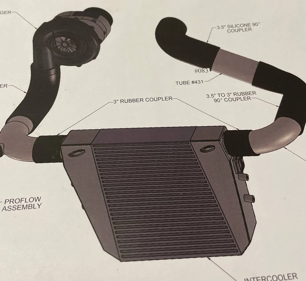

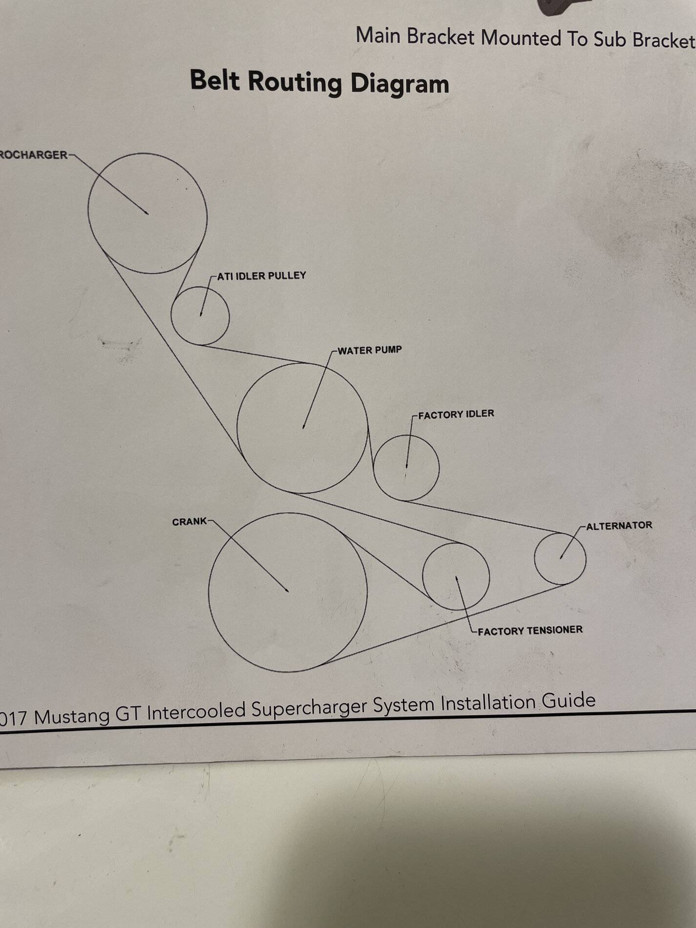

I’m not really sure what you are asking but yes you need a longer belt and you will need to add one idler pulley that’s all. It uses the stock belt setup otherwise. All the stock pulleys and tensioner are used
Those diagrams are super helpful! What I was talking about is there has to be some gearing from the crank output the the final blade spin. But it looks like procharger just packages the head unit including gearing and the belt receiver together.
All centrifugals have a built in gear box. The P Series and D series procharger have a 4to1 gear ratio then you have the pulley ratio. The p1x can spin 65000 rpm recommend but people go past that all the time
