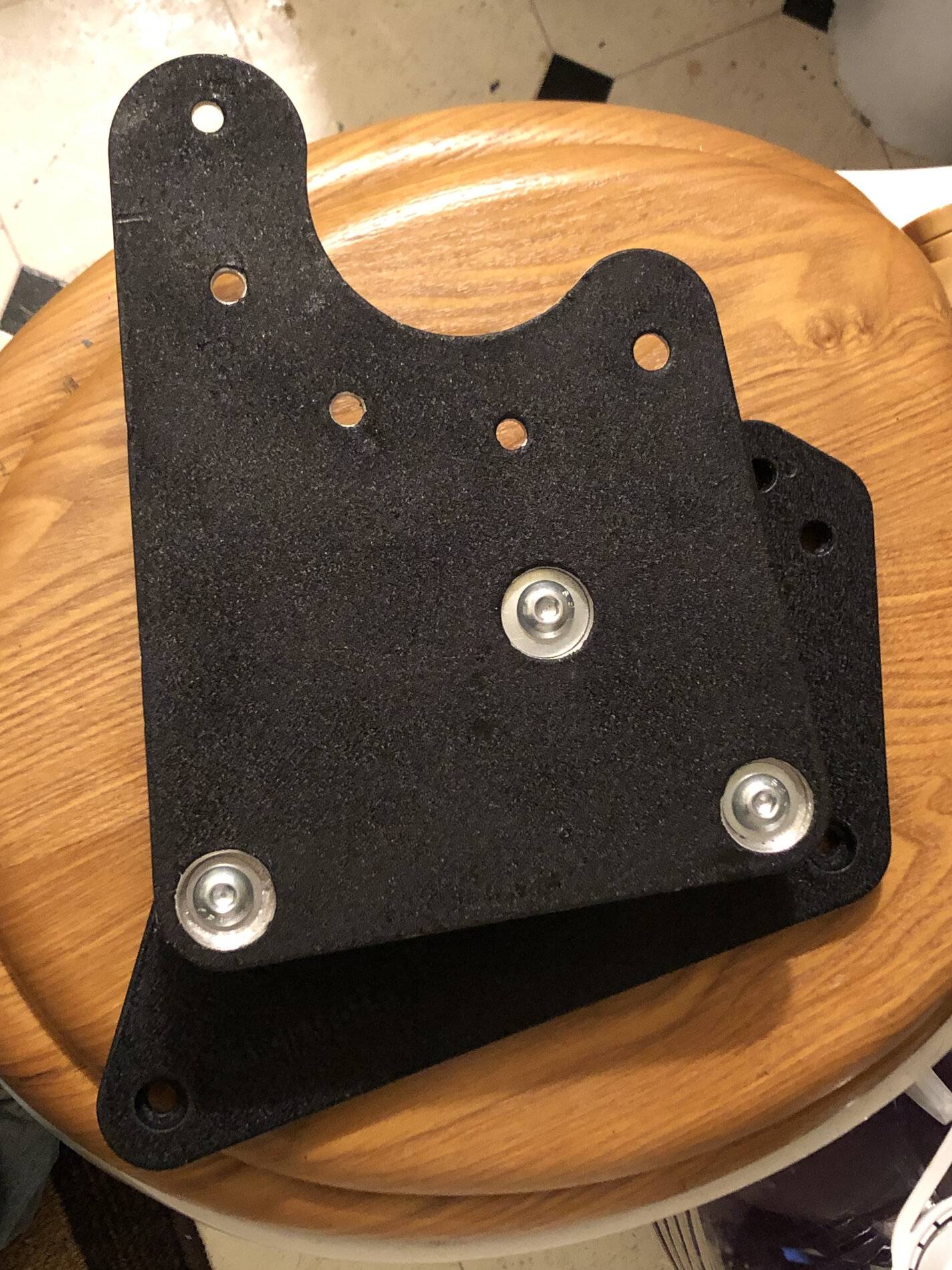

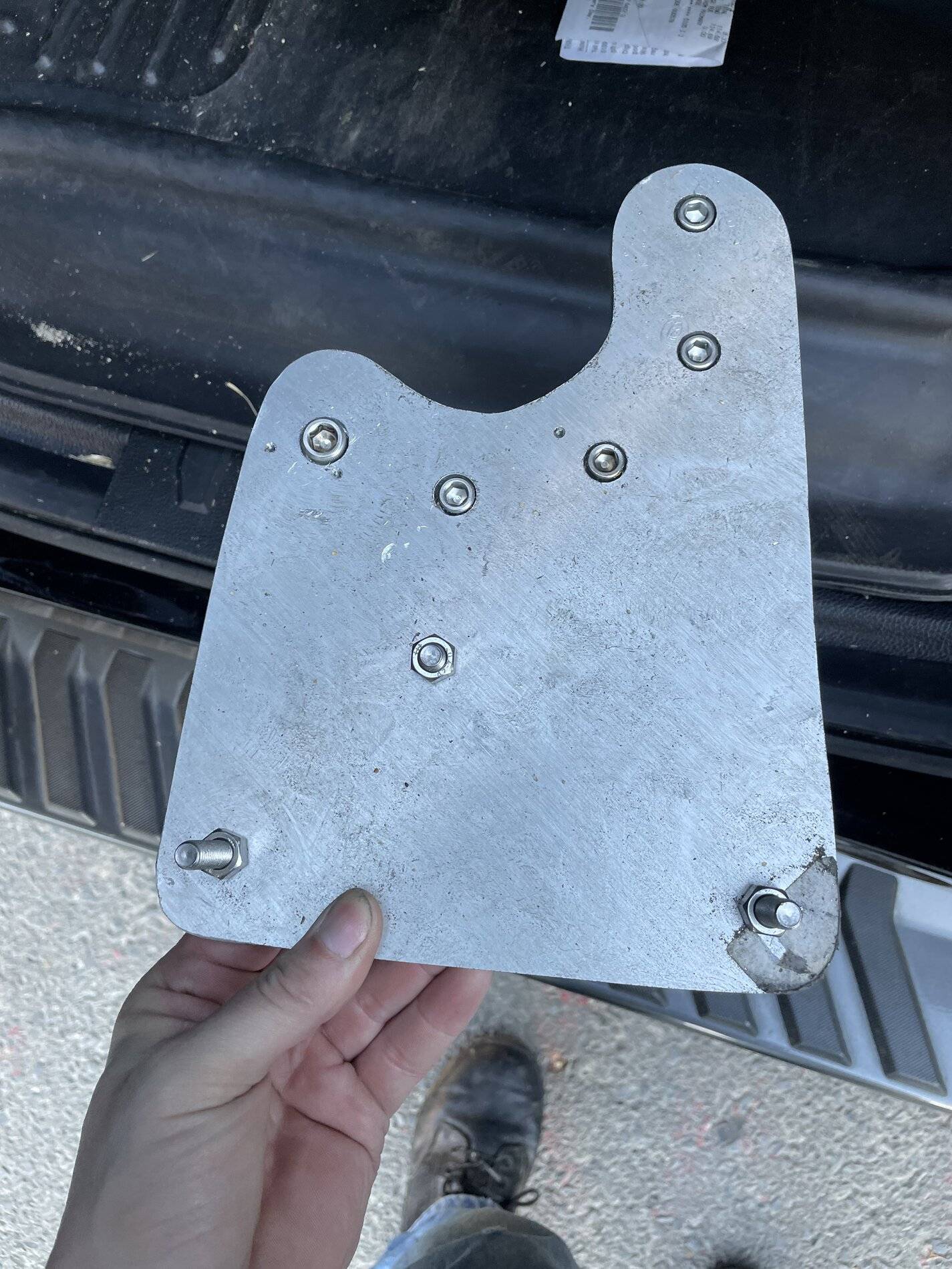

As a test I took my mounting bracket and laid it down on another piece of 9/16 aluminum and used spray paint to make a pattern, Something any novice might do. After verifying the holes would line up I center punched where I needed to drill. Next I took a grinder and a few cut off wheels and cut the bracket out. Then used a sanding disc and cleaned it up. Next I drilled the wholes with a shoulder and in 2 hours half the mounting brackets are done. I sure this can be done now is it worth it. That’s for each person to decide for themselves

Wow this is great! If you could somehow share the dimensions so others could make a similar bracket that would be amazing. I think I’m going to create another forum post trying to list out all the parts someone would need to do this project. I think I have managed to source a replacement crank pulley extender so you could run a belt up to the supercharger. After that I think it’s something most people can do. Only worried about gearing the supercharger now

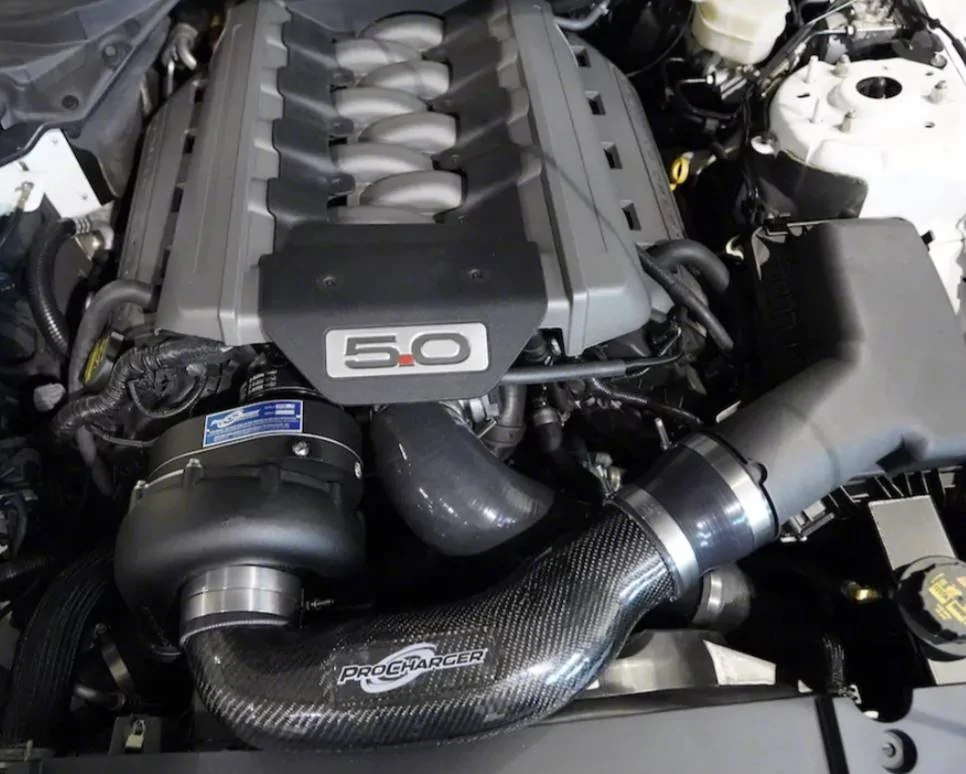

This supercharger bracket setup uses the balancer and does not need any kind of spacers or extension. It bolts the procharger here like a vortech and runs on the serpentine belt.

Hmmm I’ll have to watch the install video to see how they do it. I assume you need a longer serpentine belt. Are you able to see any of the gearing from the belt to the supercharger? I also need to research on what would be required for that.

I’m not really sure what you are asking but yes you need a longer belt and you will need to add one idler pulley that’s all. It uses the stock belt setup otherwise. All the stock pulleys and tensioner are used
