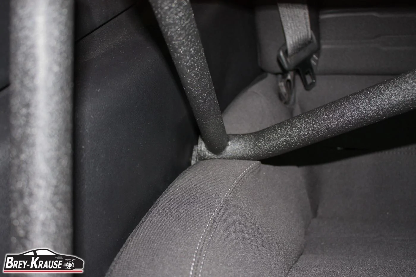

I have been waiting for a harness bar however it looks like this is only a 2 bolt design and the bends on the rear seats serve no purpose as they are not bolted to anything. Oem seat belts have 3 mounting points per seat but this has 2 in total (not on b pillars at that..) seaming to be significantly weaker despite the claims as if I would be able to sit in the back seat, and leg press the bar and make it bend. What's the purpose of the rear seat sections and do you plan on making a 4 point mounted system?
[MENTION=16487]Tucsonturbos[/MENTION] This is a 4 point mounted system otherwise it wouldn't work :)
[MENTION=22502]BKauto[/MENTION] double triangulates the the structure making for a very solid design. They use factory occupant restraint mounting points which are the strongest points in the car. These are safety tested to withstand large forces and by utilizing the rear points the system is spreading loads throughout the chassis.
PM us if you have further questions.

ahhhhhh much better couldn't tell in the other pictures, they looked like pointless bends at first! thank you for clarifying, you will probably have my business in the near future.
