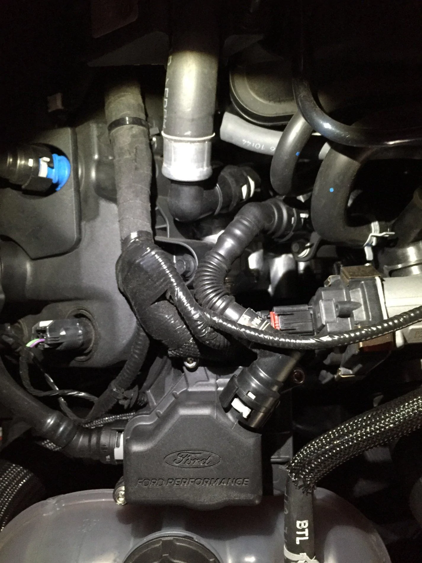

The vehicle went to the track last fall, and the dipstick lifted (popped) during each track session, just as it had previously on track. Midway through the sessions, the Ford Performance oil separators (driver and passenger side) were removed, and the original hoses put back on. The dipstick still lifted.

I have a 2019 GT 350 with approximately 1900 miles on it. The vehicle has been to the track twice (beginner/novice sessions), and after each track session, I have noticed that the dipstick (otherwise known as the "Indicator Assy - Oil Level") has popped out and is resting in the oil level indicator tube. The only engine mods are the Ford Performance Oil-Air Separators on both the driver's and passenger's side. Any thoughts on why the dipstick keeps popping out?
