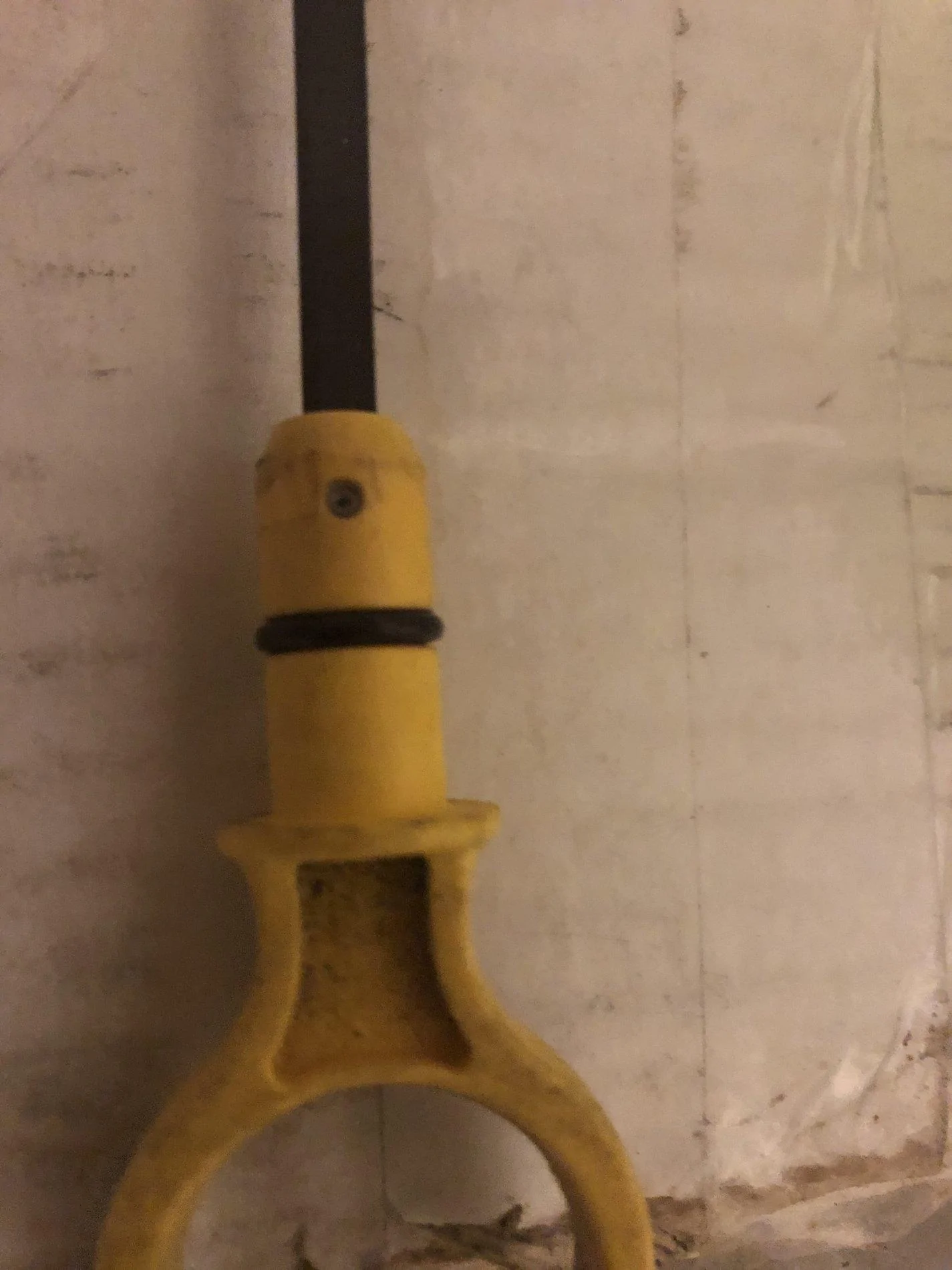

Check the O-ring. If it is comprised then higher pressure will cause it to pop. Had this happen on another car. Replaced with a new one and all good.

Agree, most probably the o-ring. Have seen this happening to another GT350 on the track. Replaced with a new ring and was solved. Was a little tricky to find the right replacement size. Maybe going to Ford for OEM replacement ? Good luck.

I have a box with many different sized O-rings. I just found one that fit.
On a different car I found a vendor that made a super nice aluminum version that had dual O-rings. I would love to have something similar to that for the GT350. The company only build stuff for European cars.

I did the O-ring replacement on a different car. So I have no idea what the Ford size is. I have had no issues with my GT350 dipstick yet.
I would like to find a replacement with dual o-rings. Just moving to aluminum is not going to make a huge difference. Although it would look much cooler. ;)
