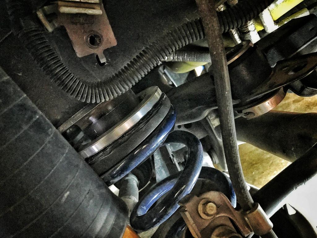

I love this Steeda 3/8" spacer. Super easy to install, and great craftsmanship of the part. My findings are as follows:
[Steeda 3/8" spacer results]
Measurement : PP / M350 / M350+3/8" spacer
Front PP Splitter: 5.5" / 5.125" / 4.875"
Fender Arch: 27" / 26.75" / 26.625"
Quarter Arch: 27.125" / 26.5" / 27"
Jacking Rail front: 3.625" / 3.25" / 3.375"
Jacking Rail rear: 3.875" / 3.5" / 3.625"
PP = 255/40/19, 275/40/19
M350 = 295/30/19, 325/30/19
9.5mm spacer above rear spring lowered front splitter 6.35mm, and raised the rear 12.7mm

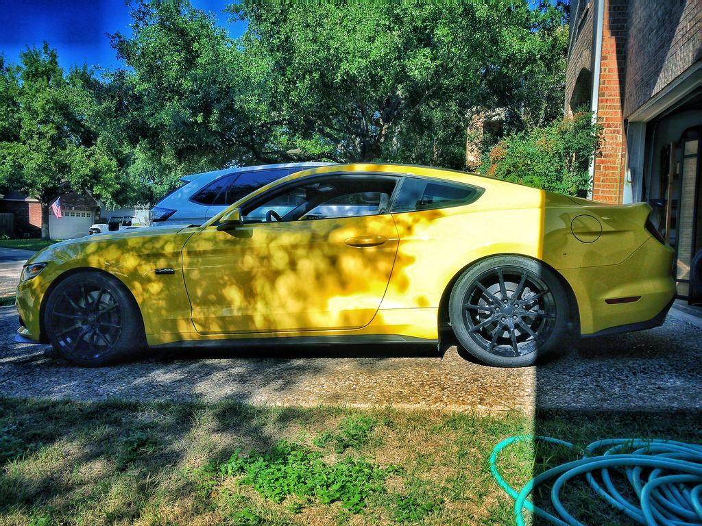

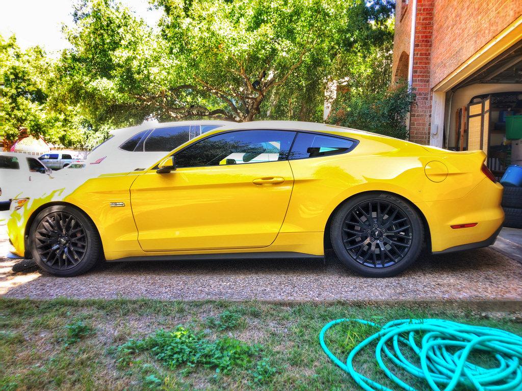

This is the spacer. I installed it above the pad isolator. Super easy because the Ultralites are short.
PP wheels and Ultralites
M350 wheels and Ultralites
M350 wheels and Ultralites AND 3/8" spacer

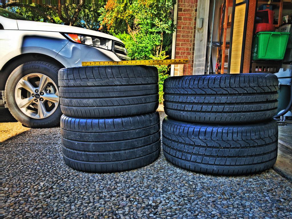

And quick comparison shot between stock tire sizes and 325/295 tires.
Money well spent.

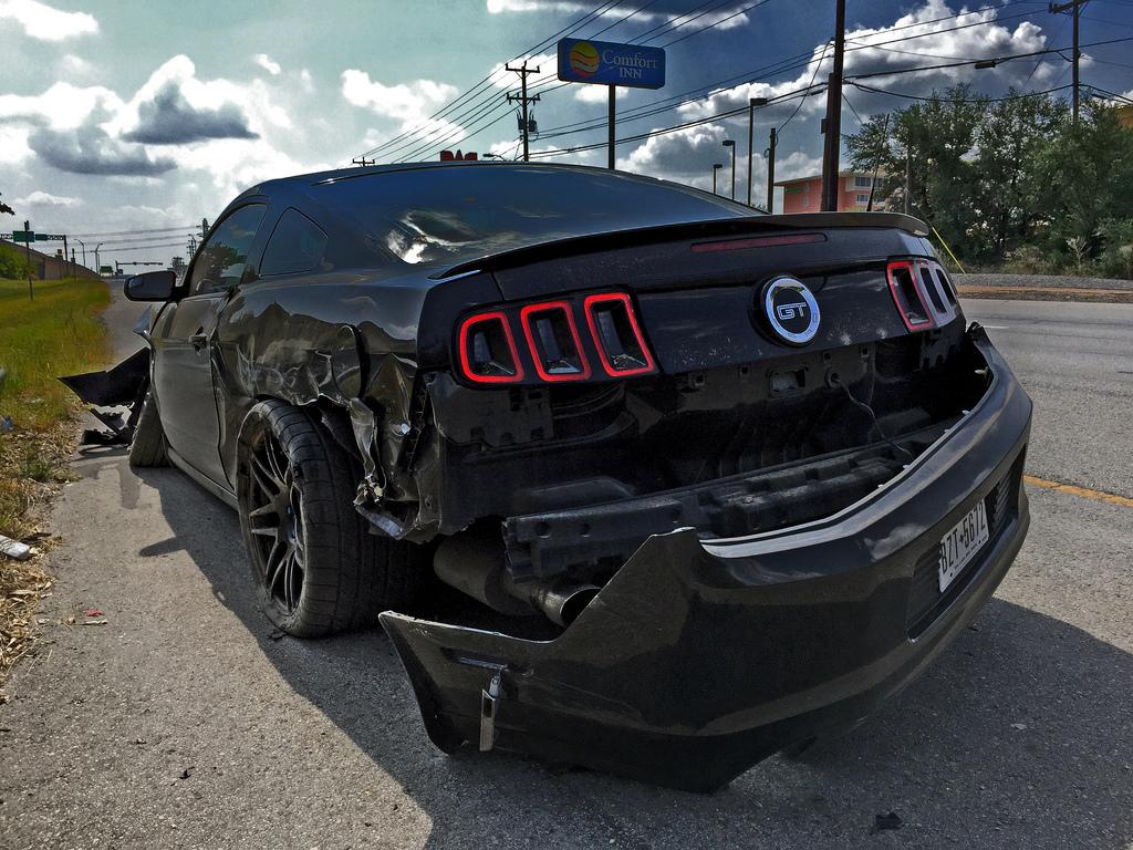

I DD this beautiful car. Ever since my last one was taken from me by an idiot who was texting and not watching the traffic lights. I feel like nothing is ever guaranteed, the fact that I will have this car tomorrow, or the fact that I will be here tomorrow. So I drive the piss out of it every day.

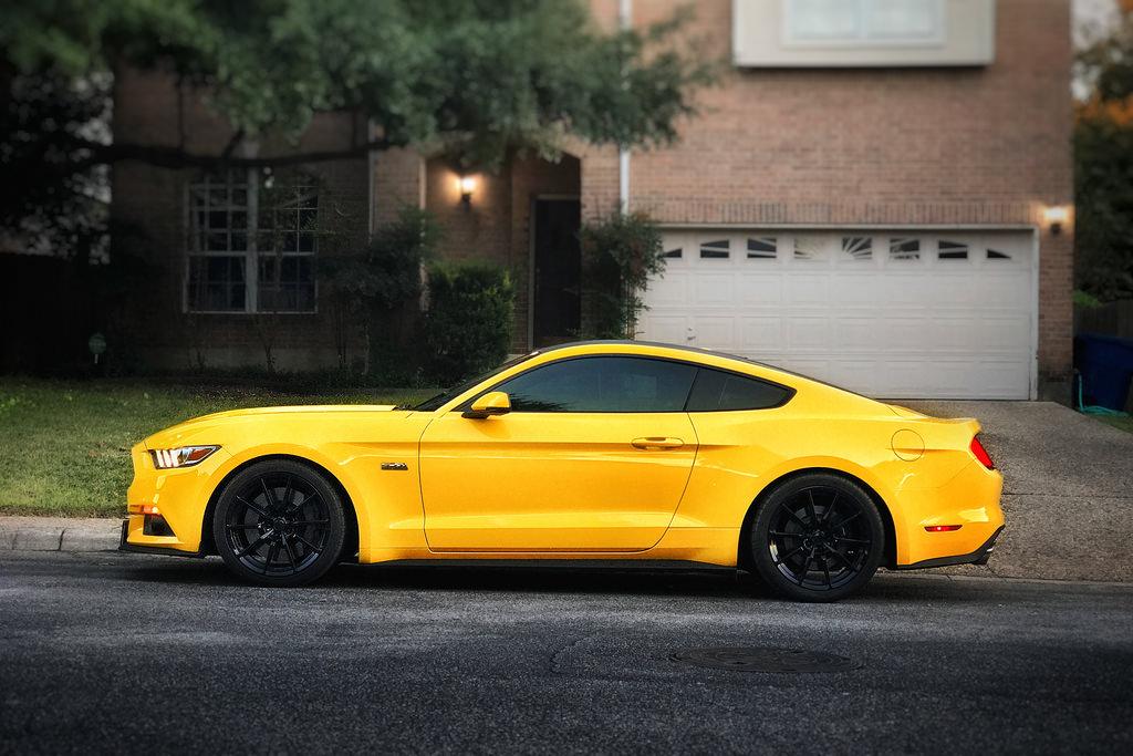

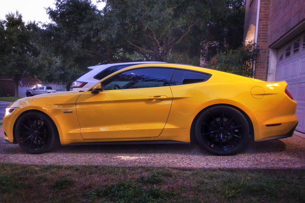

These are some better pictures from my phone iPhone 7 Plus, I just rinsed the car didn't even dry it, it's going to rain today. I just recently installed the Steeda Billet Spring Spacers 3/8" on my Steeda Ultralites.
Did you post about an accident?
I don't think I posted about it here. But I did on S197.
It did not buff out, contrary to popular belief . The wife and I were unscathed. As soon as the insurance company totaled it we bought a new one. Which really sucks because I was saving up for a GT 350, and it wasn't out yet when this happened.
