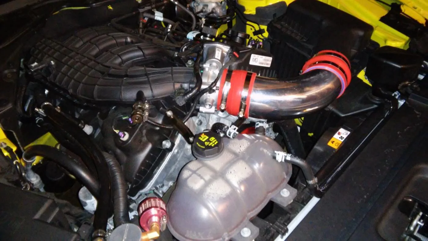

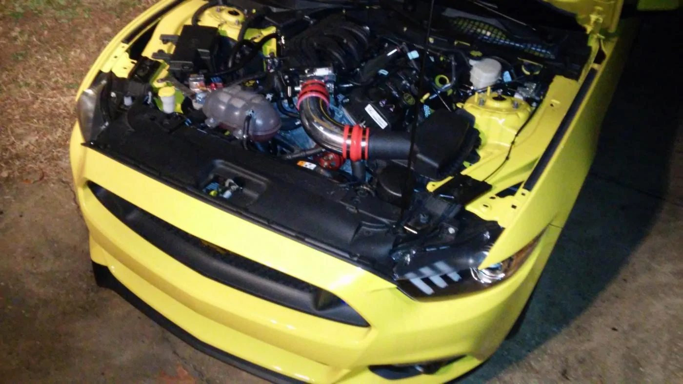

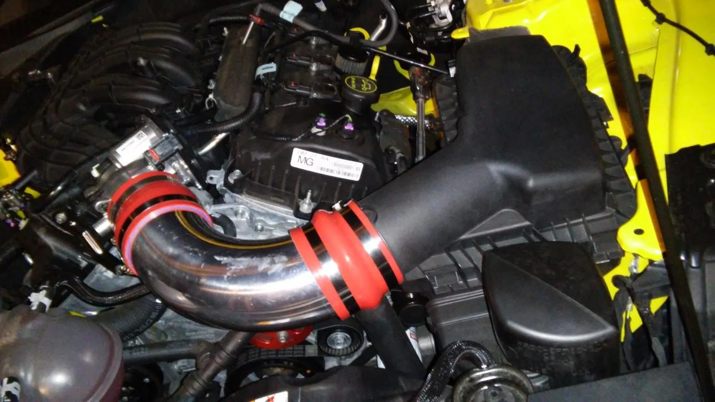

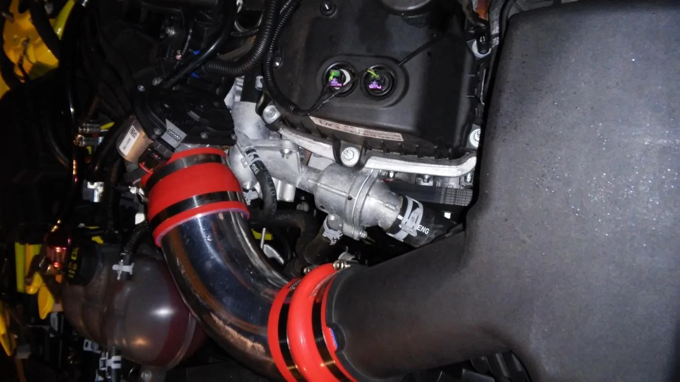

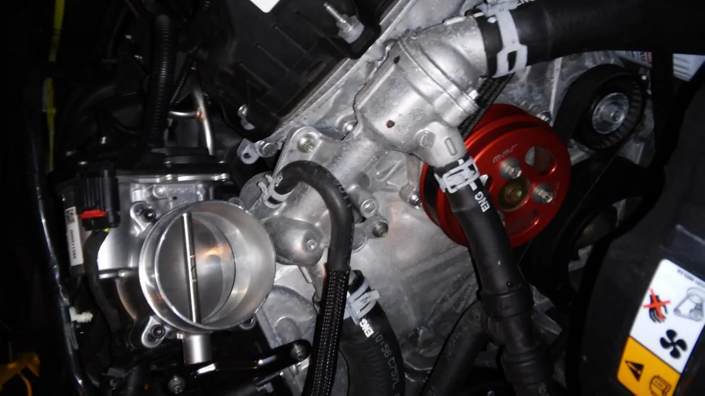

Custom intake tube looks nice, where did you get it done? Keep up the work, she's coming along very nice.

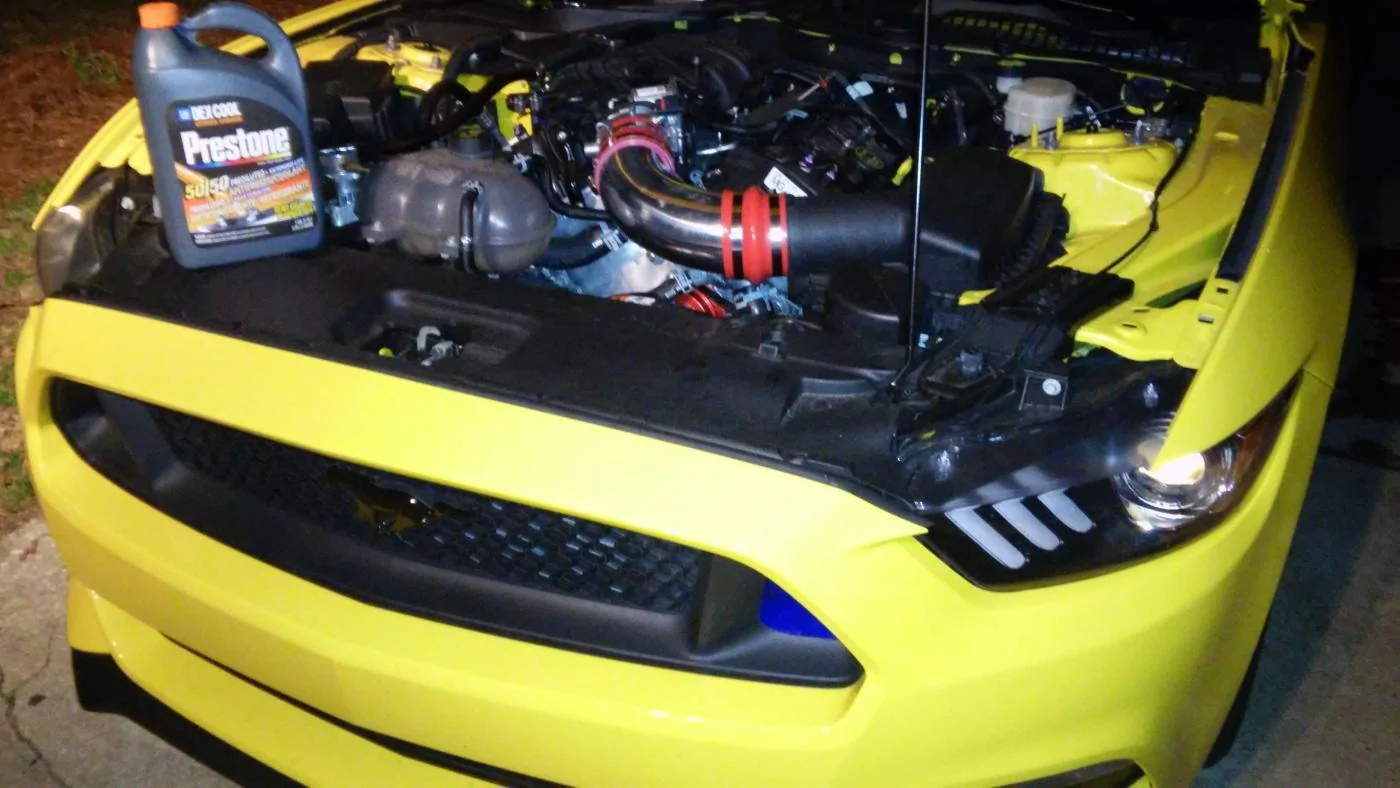

Thanks! It is 102mm Ebay intercooler piping. Works great. :D

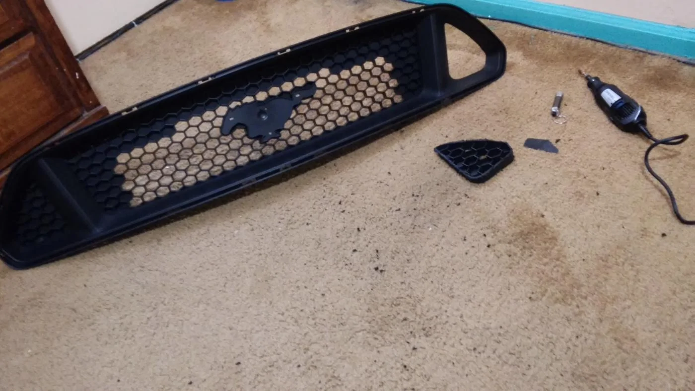

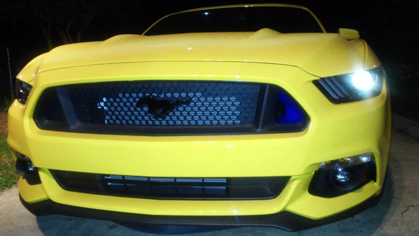

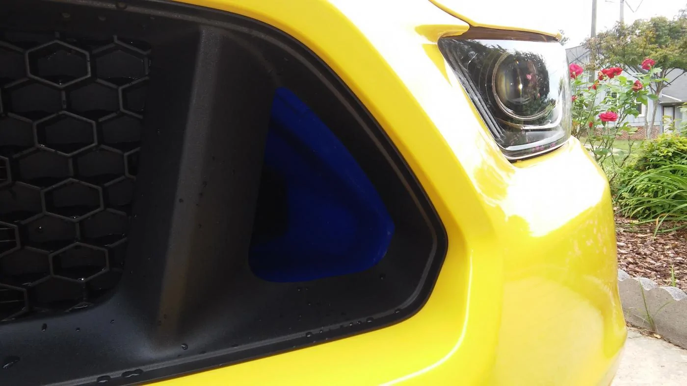

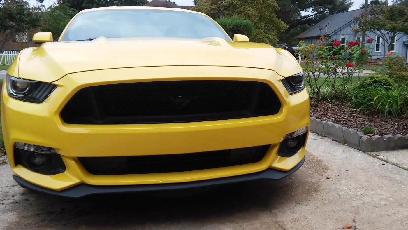

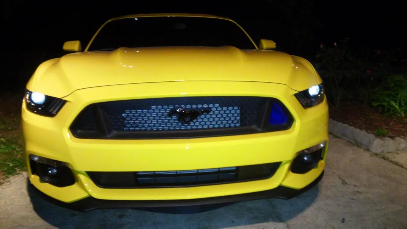

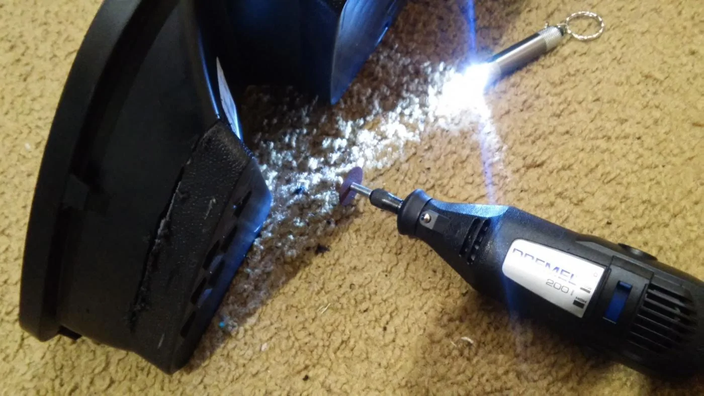

Added
-GT Grill
-Black Running Pony
-Velossa Ram Air Snorkel

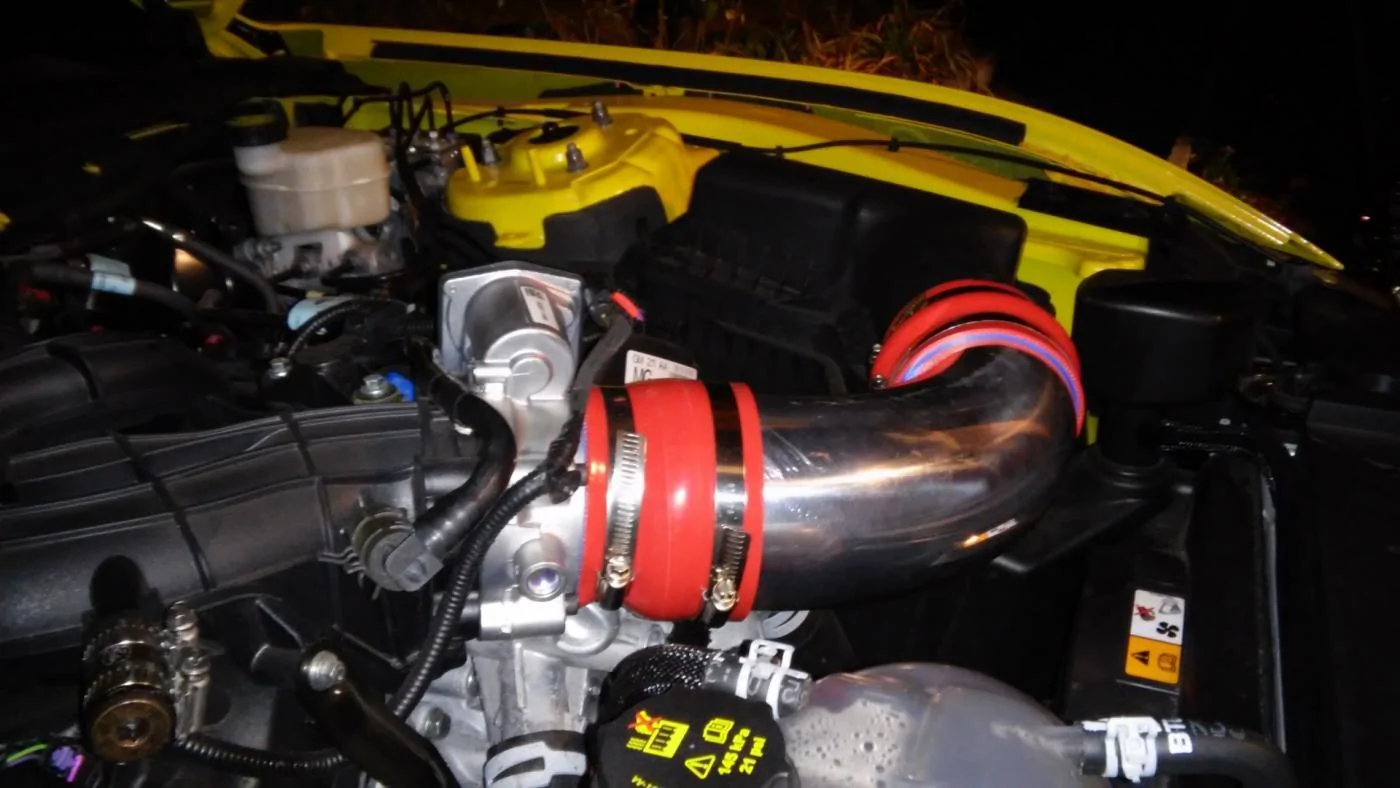

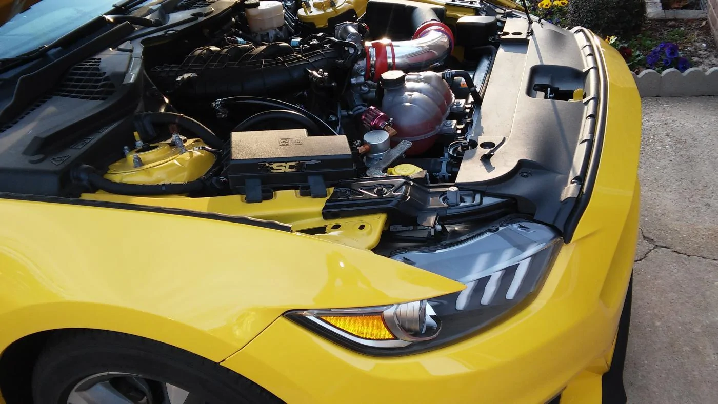

Snapped better pictures of the snorkel.

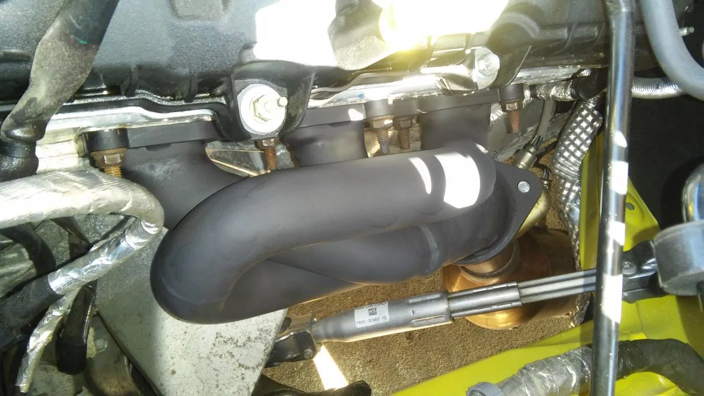

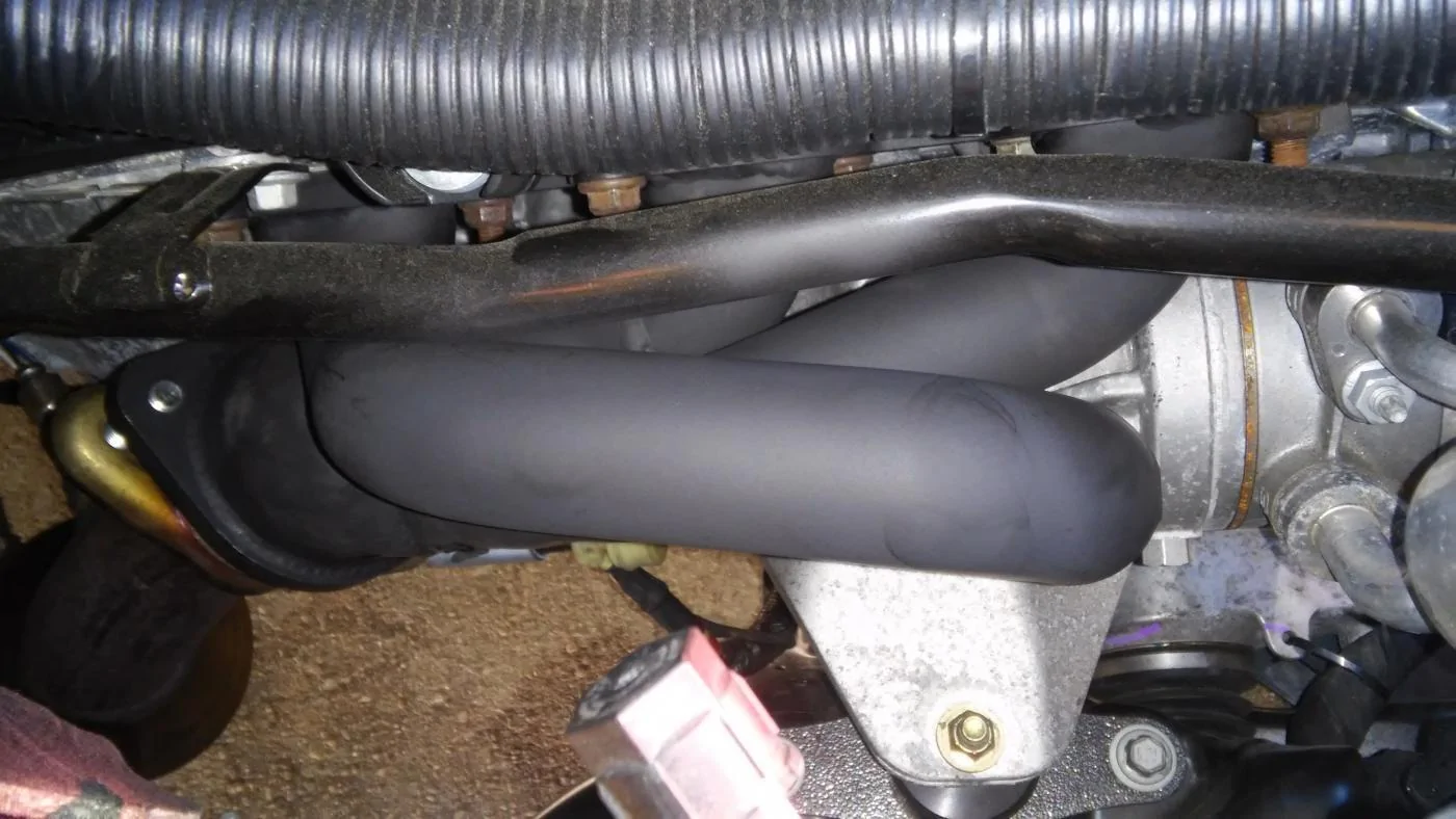

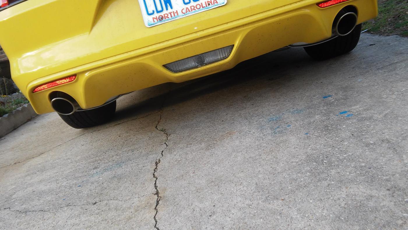

Added: GT Exhaust and wow what a huge difference on sound quality! :thumbsup: (Excuse the dirty car, Fayetteville roads and rain are not kind).

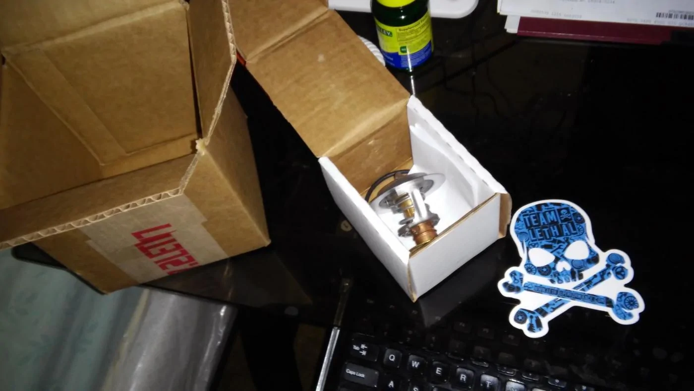

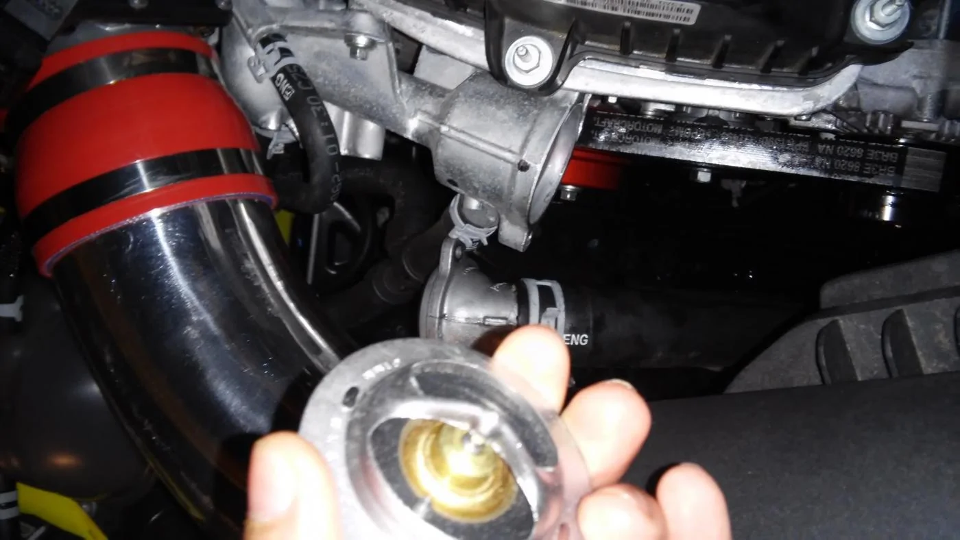

Added Reische 170* T-stat. Phenomenal mod for the money; even without the tune I see a dramatic drop and temps and performance. Thanks @Chris@Lethal you guys ship super fast! I was also surprised that Ford has switched to Dexcool now. Thanks to doing some homework here I saved money getting Prestone 50/50 vs the pricer Motorcraft Orange. The Xcal4 for Unleashed tune to adjust for the t-stat and mods will be here tomorrow. Can't wait!

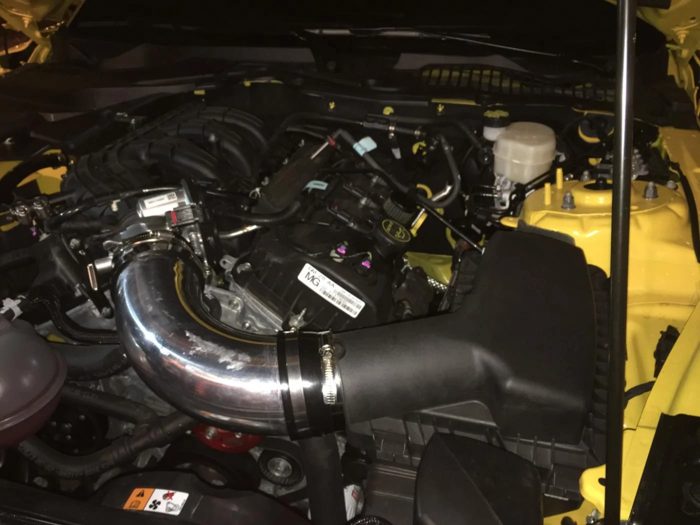

question, what length of tube is suitable for this set up, looking at eBay and there are to many sizes to pick from.
It is the 102mm (4") intercooler elbow that I cut to fit. It works great. Here is a link to it: http://www.ebay.com/itm/Aluminum-90...ash=item3f742c4147:g:-k0AAOSwg3FUeVHu&vxp=mtr

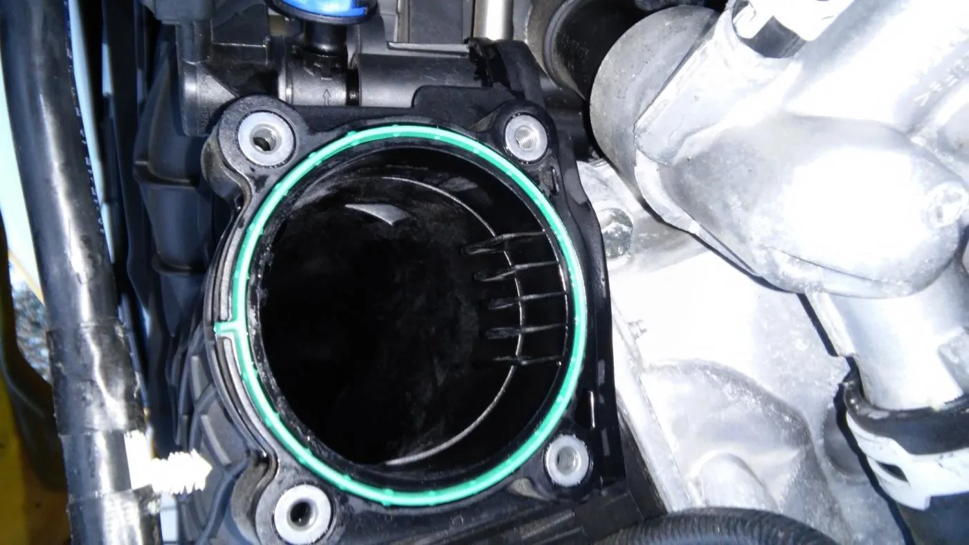

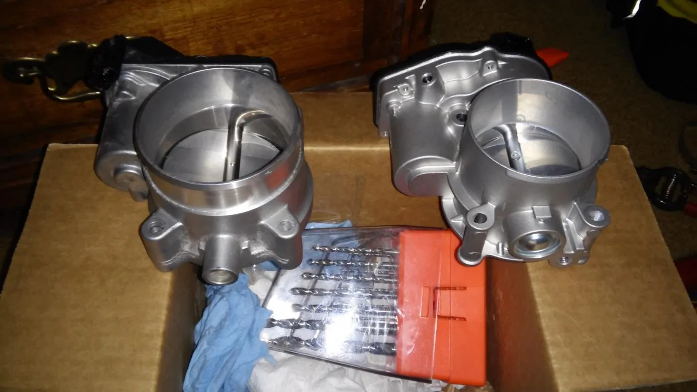

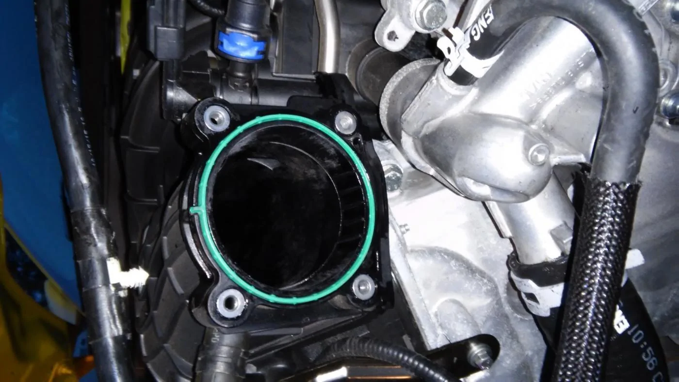

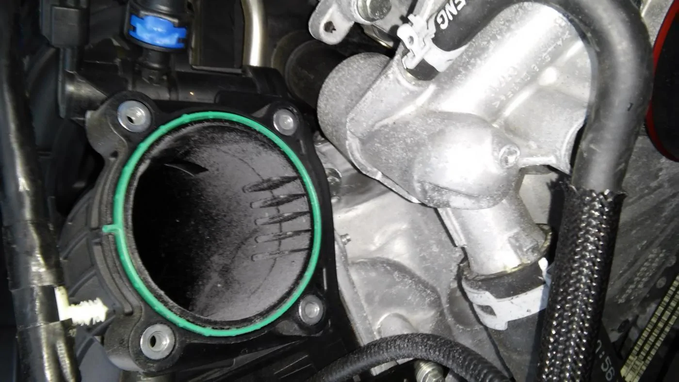

So should I get a 2014 TB or will any GT TB Work just have to remove the fins
whatdoyoufeedit?
whatdoyoufeedit?
Jan 14, 2015
582
208
Fayetteville, NC
2019 Race Red EB A10 (Formerly 2016 3X Yellow V6 M6), 1996 Mercury Cougar XR7 4.6L A4 (Future Coyote swap candidate)

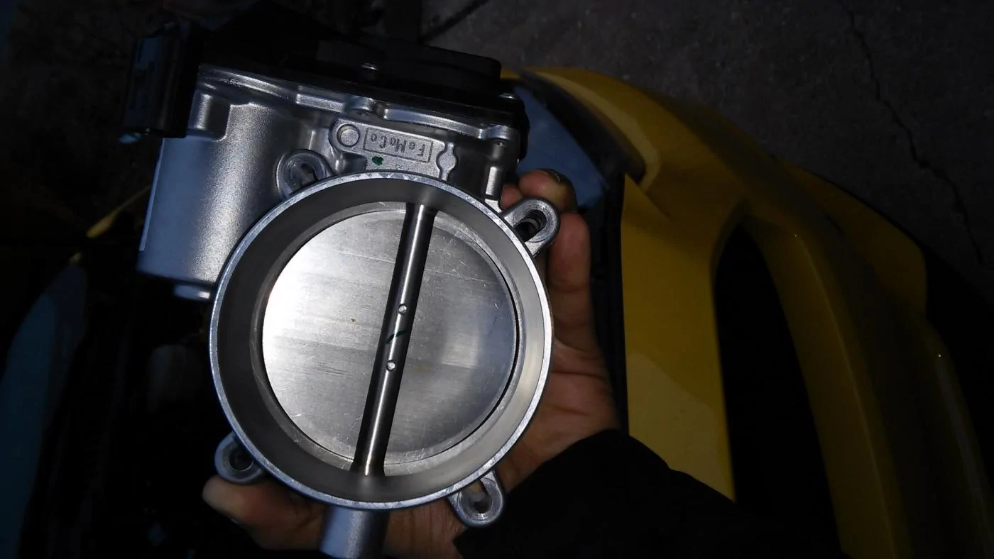

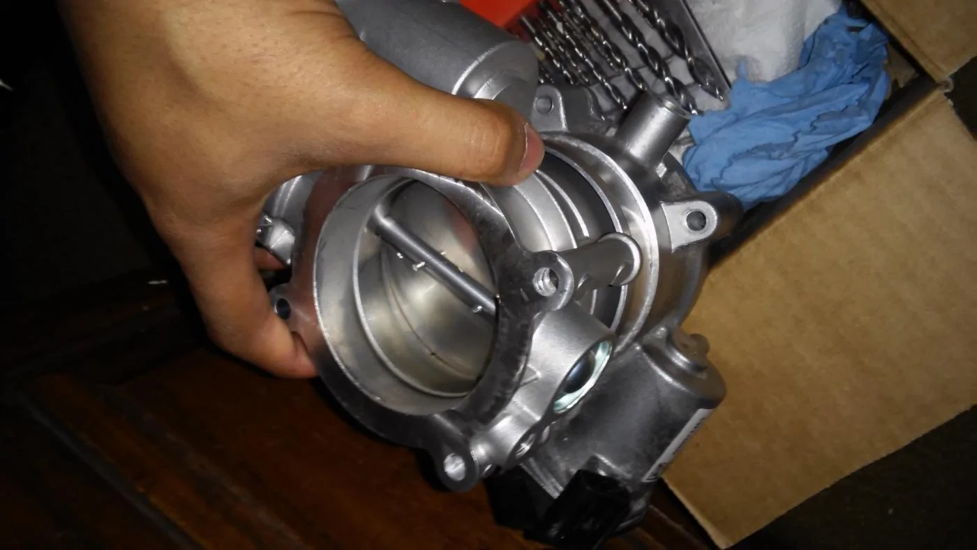

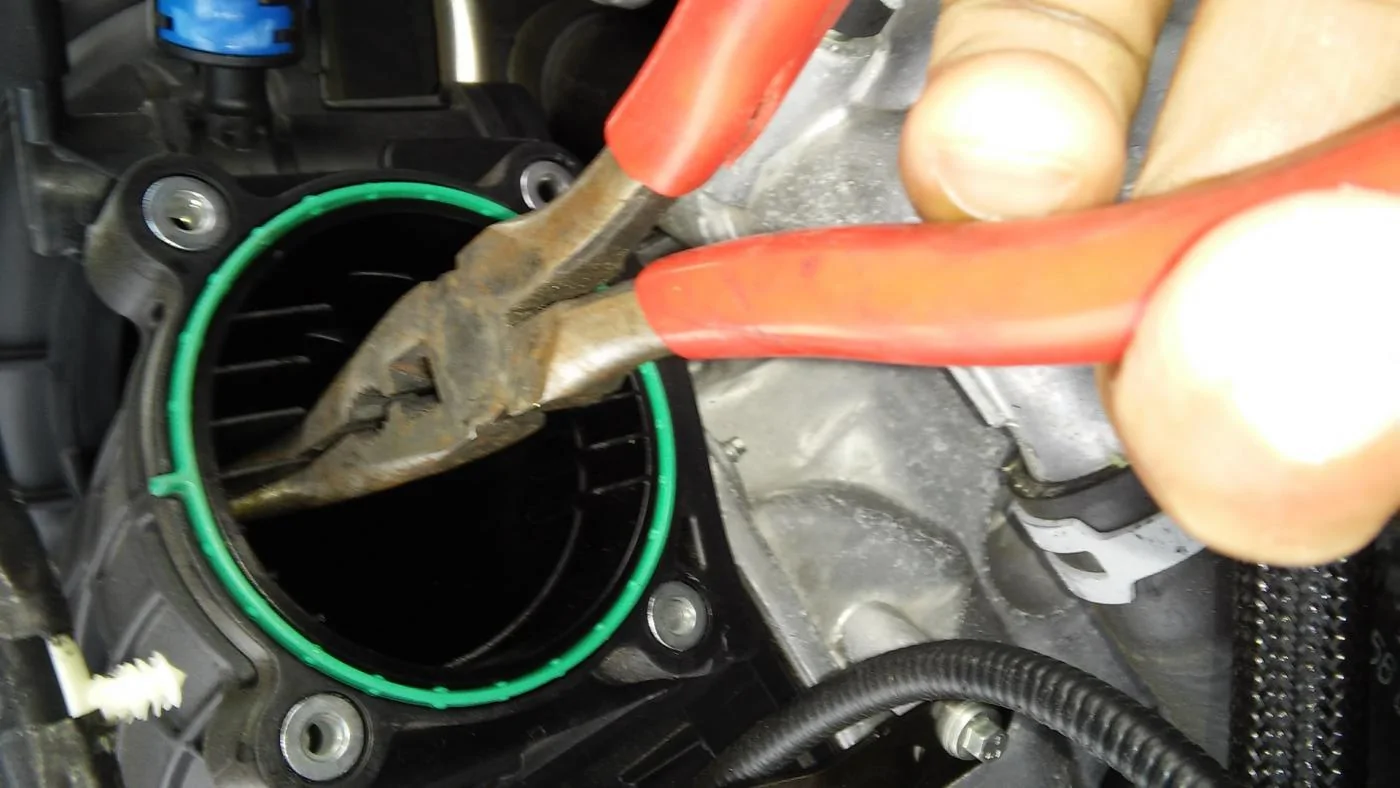

You want the 2011-2014 GT TB. Nobody has been able to get the 2015+ to work even with "tuning". You remove the fins and take the new throttle body and the hold throttle body to the machine shop and tell them you need the holes match. Tell the machine shop to move the holes 0.187" down towards the center, they will know what to do. More information can be found here: http://www.mustang6g.com/forums/showthread.php?t=72817

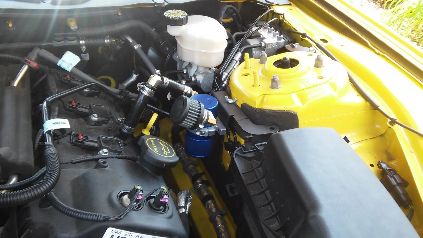

Added: driver's side catch can to eliminate oil mist on driver's side valve cover.
