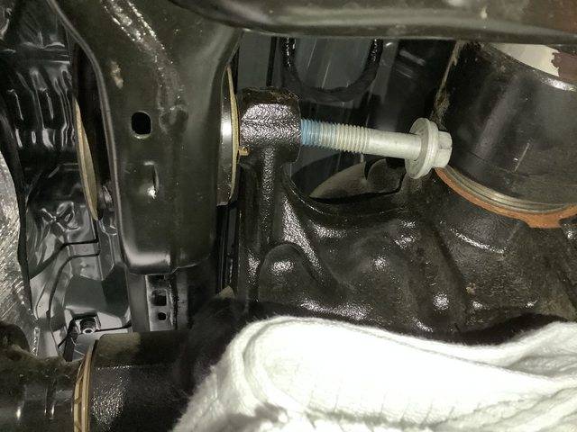

Can the rear bolts be removed without dropping the cradle?
If they are 100mm long, then I measured about 4" of rearward clearance to the body. IOW, it seems that it might bind before fully backed out.

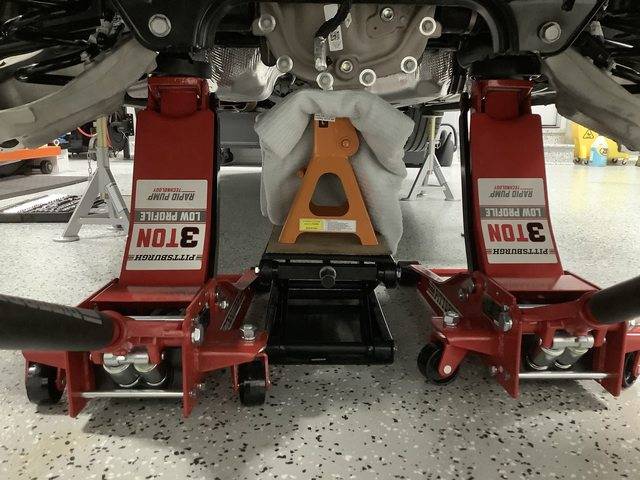

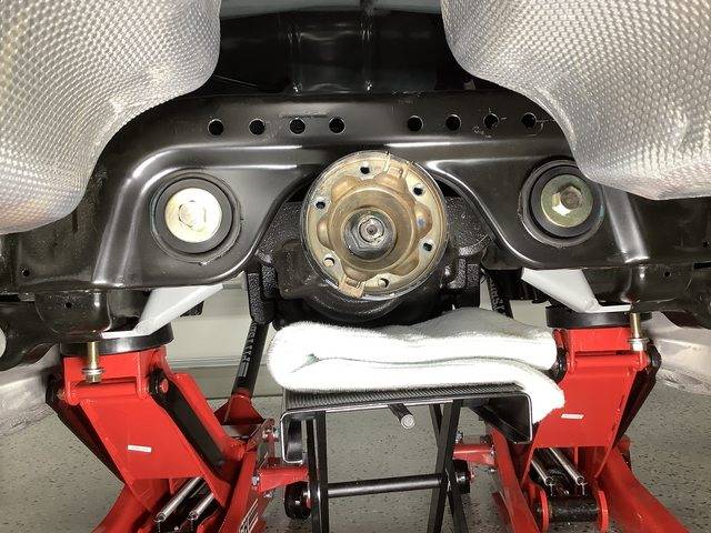

I loosened the rear bolts and then removed the entire cradle before taking the rear diff. bolts out on my car. IMO, it’s really the easiest way to do it without having to fight with something. It’ll also give you an opportunity to install a subframe alignment kit and a subframe bushing support kit. if you don’t already have them on your car.

So I crawled under the back of my car to inspect the situation closer. There is no way to back out the rear bolts without dropping the cradle somewhat so that they will clear the spare tire well. But after reading some vendors' instructions it seems as though the cradle bolts don't have to be completely removed.
Not sure on that part, but when I dropped my cradle, I used the three jacks shown in the photo. I just kept alternating on the floor jacks from left to right and then the scissor jack. I didn’t have any help and everything went back together very easily without anything going into a bind.

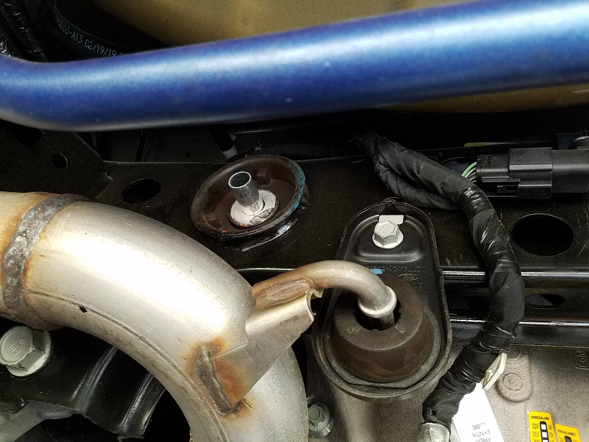

I made a pair of aluminum sleeves, 14ID x 16OD x50L mm. Installed them into the OEM rear rubber diff bushings in about 90min.
I lowered the cradle by loosening, not removing, the four bolts. I did not have to remove wheels or exhaust. But I did support the diff with the floor jack just in case, though it wasn't really necessary.
I have two spare pairs available for anyone.
