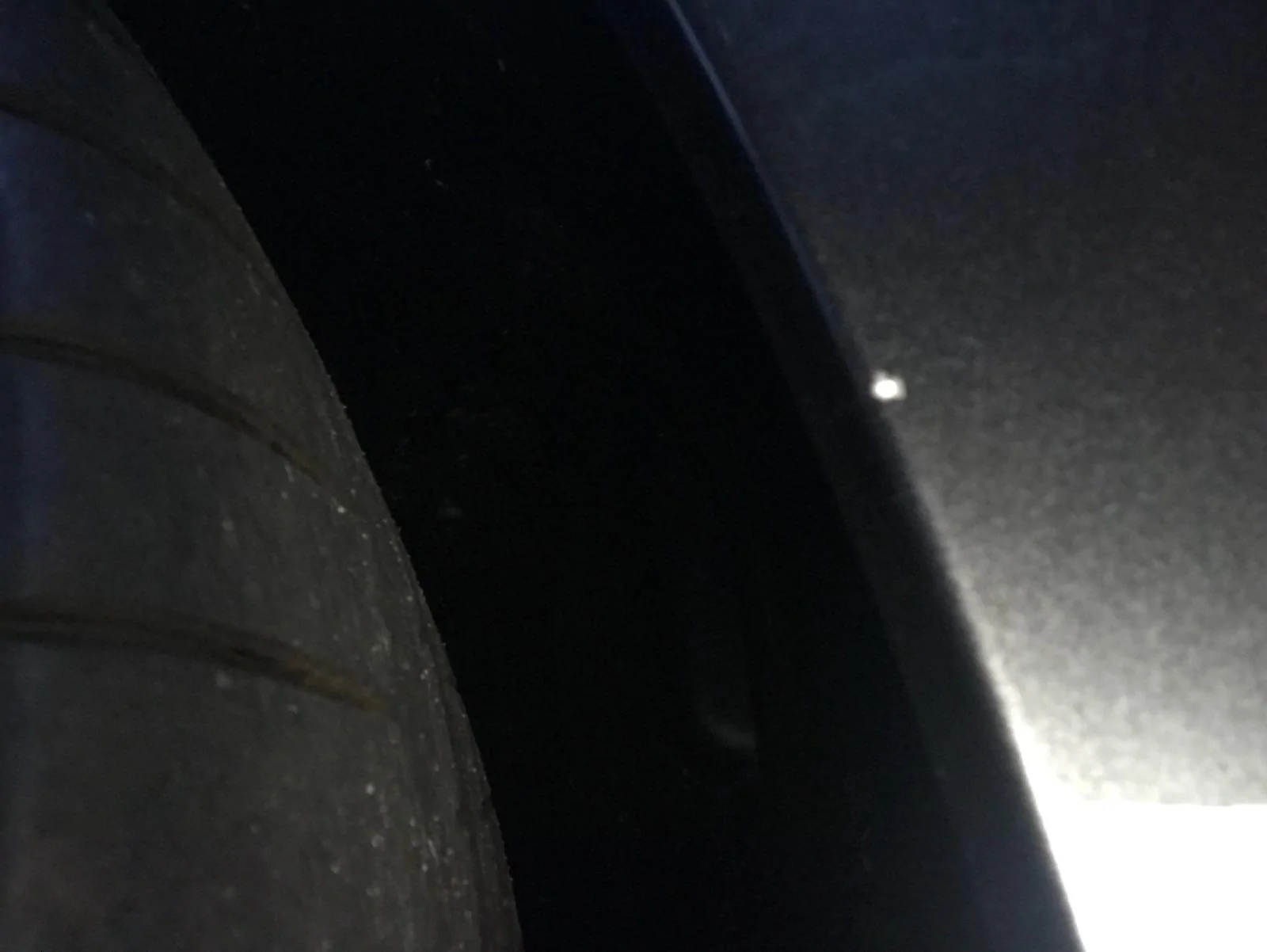

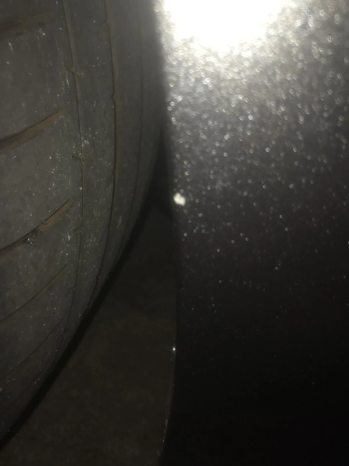

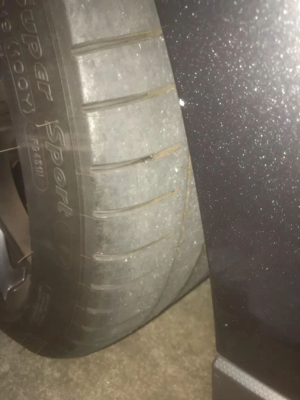

Just noticed a deep rock chip when cleaning the car. I've done some research and the two best methods on the market ar dr color chip and scratch wizard. The difference between the too is scratch wizard comes with a bondo filler material to fill where as dr colorchip does not. Which would you guys reccomend for a deep rock chip? I've attached pictures

I see you have magnetic as do I. It is the most difficult color to do a decent touch up on as the metallic flake will not "stand up" as it does when sprayed on. Hard to even get the shade correct with the touch up paint it always goes on darker. I would take that one to the paint and body guys

I think all you need are some touch up paint from the dealer, a small artist brush and a bit of lacquer thinner for a brush cleaner. Dip the brush in a bit of thinner and then into the touch up paint and lightly dab the chip being careful to stay inside the chip. Particularly if it's a metallic paint, resist trying to dab the chip full all at once. Better to fill it slowly over several hours with thin coats allowed to dry in between coats. Done carefully, a chip of that size will be nearly invisible. If you are feeling fully capable you can sand the filled chip flat with 600 and then 1000 & 1500 grit wet/dry sandpaper wrapped around a popcycle stick. I learned of a trick the other day when using this approach, which is to put a wrap of masking tape on either side of the strip of sandpaper. The masking tape helps keep the sandpaper from going below the surface profile and creating a shallow divot. Then the sanded area has to polished to remove the sanding scratches.

Very good advice. Magnetic Ford color code is J7. I would make a suggestion not to use anything lower than 1000 grit wise (I use 1000, 2000, 3000). Taping around the chip before wet sanding (do not do it dry) is critical. Also critical is to let the paint dry properly before sanding (I try 24 hours). After sanding polishing with DA or orbital buffer with good pads and compound will make it look even better. The only good thing with this chip is that it is very close to the edge so if repaired properly will not be very visible. Good luck!
