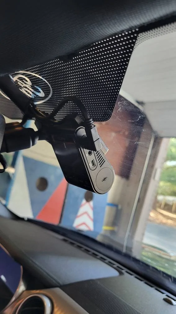

Here's how it looks from my view, basically hidden out of view for me, which I like:
View from passenger seat - and I didn't put it up on that blacked out part in fear of the glue (upon removing the mount) pulling off some of that black stuff. It might not, but wasn't worth the risk for me.

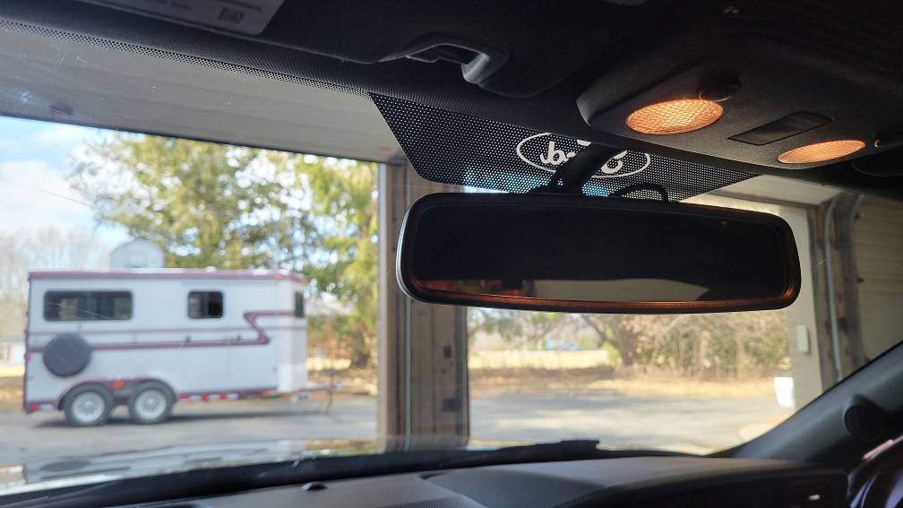

Bullitts don't come with the advanced safety features, so I ain't got much up there. On a GT with those features the windshield gadgets will take up more space.
I also have light windshield tint.
It mounts just below the dotted black thing and sits right next to the mount for the mirror:

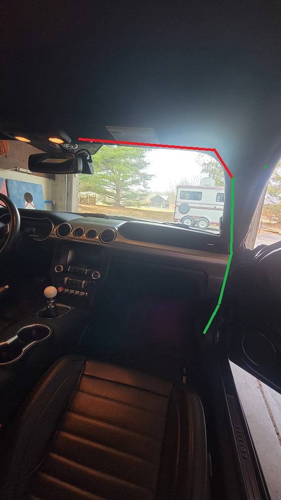

In this picture the green section is ran behind the weather strip after removing it and fishing the kit through. The red portion is just tucked behind headliner:

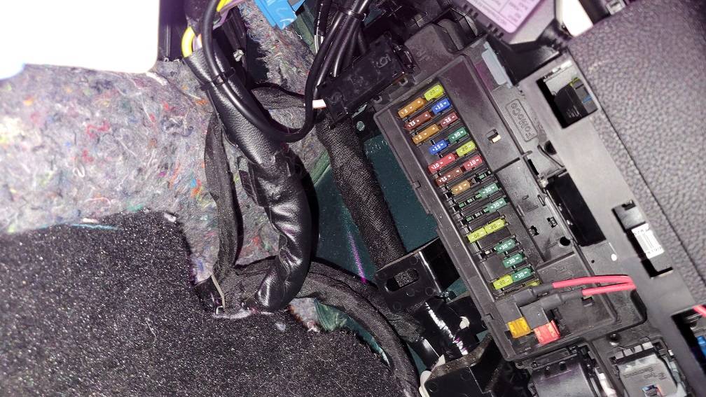

Fuse box detail:
Lastly - if you don't need parking mode (i.e. hardwire kit from fuse box) and only want power on with ignotion, there's mounts/adapters for rearview autodimming harness - you buy this, plug your mirror into it and you gain a USB plug right at the ceiling, which allows you to plug a dash cam in.
It's used frequently for radar detectors too I think:
https://www.amazon.com/dp/B088P4VFQ...OPVJJIQP&psc=1&ref_=list_c_wl_lv_ov_lig_dp_it
If you want parking mode, you have to go to the fusebox.

Thanks so much! This is great. I have the same mirror as you. I like how the cam is hidden from view. I think if it were mounted higher, you would see part of the screen above the mirror. Can the mirror move enough to have access to the screen or do you just do that from the passenger side? How often do you need to use the screen?

I think the intelligent parking mode features of the A129 are very useful, so I highly recommend getting their HK3 wiring kit and going to the fusebox.

Yeah, you can move the mirror quite well, doesn't interfere. I do have to move the mirror to get the camera dismounted and remove the cam to review footage (i.e. to pull out the SD card).
This is not ideal, but it's due to my choice of the way I ran the wires. I try to remove power before removing the SD card, I don't want any footage corrupted.
And the other reason why the cam is harder to remove is I have a little felt pad that comes with the camera on it so it doesn't rattle. You can't hear it yourself, but when reviewing footage, you can hear rattle from the mic since it's so close.
In the end, long story short, no interference and I look at the screen maybe 1x a week making sure it's recording? No reason to look at it past that once you have everything set up.
I have muscle memory to know where to press to save the footage.

Yeah I def don't want part of the screen visible. I'm 6'3" and from that angle I can't see it, which I like.
