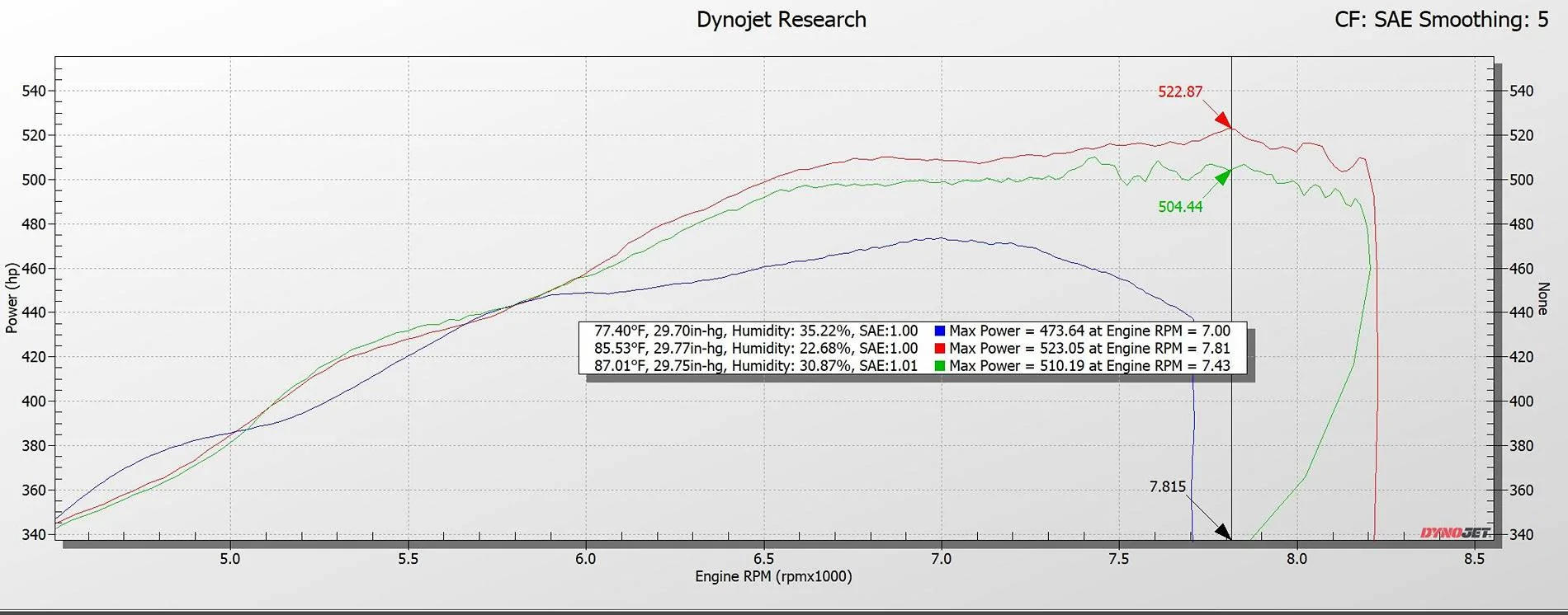

FBO vs. Cams. (Comp cams Stage 3, springs, chains, tensioners, Holley low-ram intake.
Blue - FBO E85
Green - initially with GT350 TB
Red- With Soler 95mm TB + light home port of lower manifold
Blue - FBO E85
