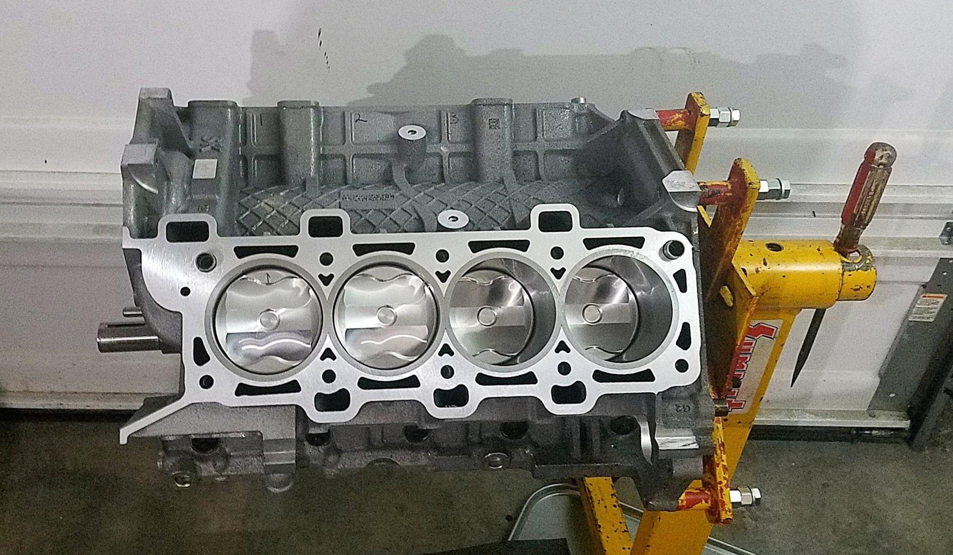

What's the setup on the new motor.
Just collecting info
Gen 2 block, Darton sleeves, Molnar power adder rods, Diamond MOD2K pistons, lots of MMR stuff, all studded with ARP, Boundry pump and gears, Innovators West damper.
Short block is all complete and on the stand, working on heads and timing setup next.
