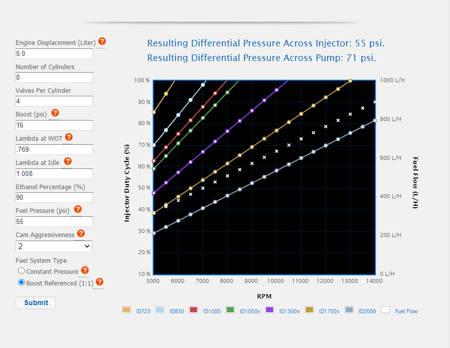

I am considering dropping to a 4" on my 2018 D1X Stage 2 setup (currently running a 4.25") now that I have traction (makes a big difference). I believe I should have the fuel to support it with my two 267's based on the Injector Dynamics calculator. The calculator is calling for 508 l/h at 8k rpm and I think the dual 267's are rated at 600 lph. Obviously, I will need to log the car as I only have my current Lambda and STFT to use. Along with dropping the pulley size, I will be installing an ATI damper, Kinetic stud and PC crank support. My decision was expedited based on what happened to TGGT's car last week (sorry). The downside, I really don't have a functioning boost gauge as I run the ecoboost swap so I am not sure this fuel calculator is completely accurate (used 16psi). I believe TKM Conbread runs the same pulley. My car is a street car that is not driven much. Car has 5k miles, 1200 with boost. I understand the risk here and may be setting myself up for a new shortblock sooner rather than later. Anyway, do you believe a 4" is a bridge to far on the stock motor (I have a 7.65 crank pulley). My thought, I can get roughly the same blower rpm at 7350rpm on the 4" vs my current 4.25" at 7800rpm. Also, with the 4", the blower is close to max rated rpm at 61,161 rpm. Appreciate your input. Thank you.

For me personally. I will be staying with the 4.25 on my d1x setup with the new motor. I see a little over 13 psi at about 7700 ish rpm. That being said I think you could do the 4” and keep the motor alive. If it were me doing it I would have the car shift at 7400 - 7500. I believe that would put you around 15-16 psi. I think it will hold up. How long? That’s another question. Btw good decision on getting the crank support. I wish I had it to do over again, but it is what it is

My PC crank support arrived yesterday to compliment my ATI damper and Kinetic crank bolt. I will get all of it on the car soon. I did throw the 4" on yesterday and made a couple pulls for logs. My fuel looks fine which is great. I very much like the PC stage 2 setup so far. Coming from performance diesel trucks, this car is a very different experience. Thank you for the feedback.
