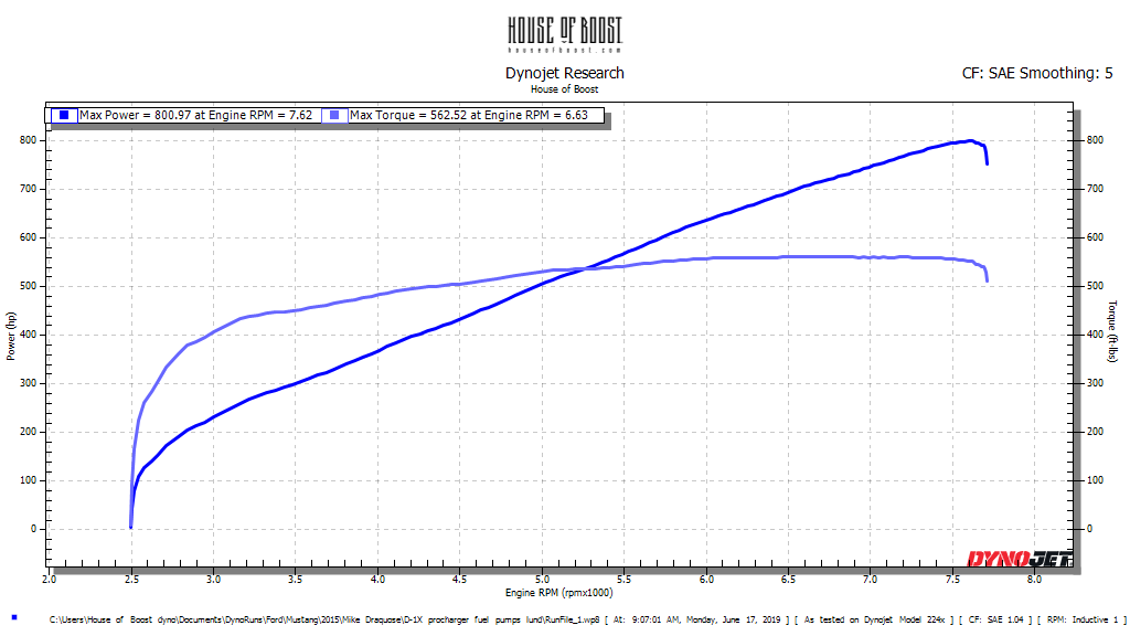

D1X @15 psi on E. 4.5 pulley...was expecting more I guess.

Damn a 4.5 pulley
What intake?
Who's tune?
How much timing?
What correction factor or elevation plays a roll in it a bit.
You shut it down early most people pulling to 8k
Also did you log boost on the Dyno was it 15 psi when the pull stopped

One last bit without the pre-filter a 4.75 car with a 18 intake will make about 14.-14.5 around that RPM might even see 15 @8k.
A 4.5 pulley by those standards is a 17-18 lb pulley on a 15-17 car with what I posted above

I see a few things, I see Lund and 1.04 correction, so that seems fine nothing crazy.
What's your cars full mod list?
When you get time and any other answers to the above
Thanks again

800 on 15lbs is real respectable. Gives me hope I’m close to that minus being auto. HoB you can compare to some of procharger tech’s YouTube videos as that’s where he dynos most cars. Didn’t realize you just down the road a little from me.
And that torque curve:inlove: where’s all the pd clowns about centri’s not making torque?!

:cwl:That's funny. But your probably close to 9s on a summer night with that power. Dont have to wait til fall to pull it off.:like:

Your tq curve looks awesome,i would think it would have been.a little more torque but hey all dynos are different.Take it to the track,even if you dont 60ft good because of driver mod,your words not mine lol,you will get to.see what kind of mph you are putting down.If the temps in your area were anything like ours the past couple days,on a cool day that is 850hp easy!!!

Looks pretty solid to me! Pull that thing to 8k
