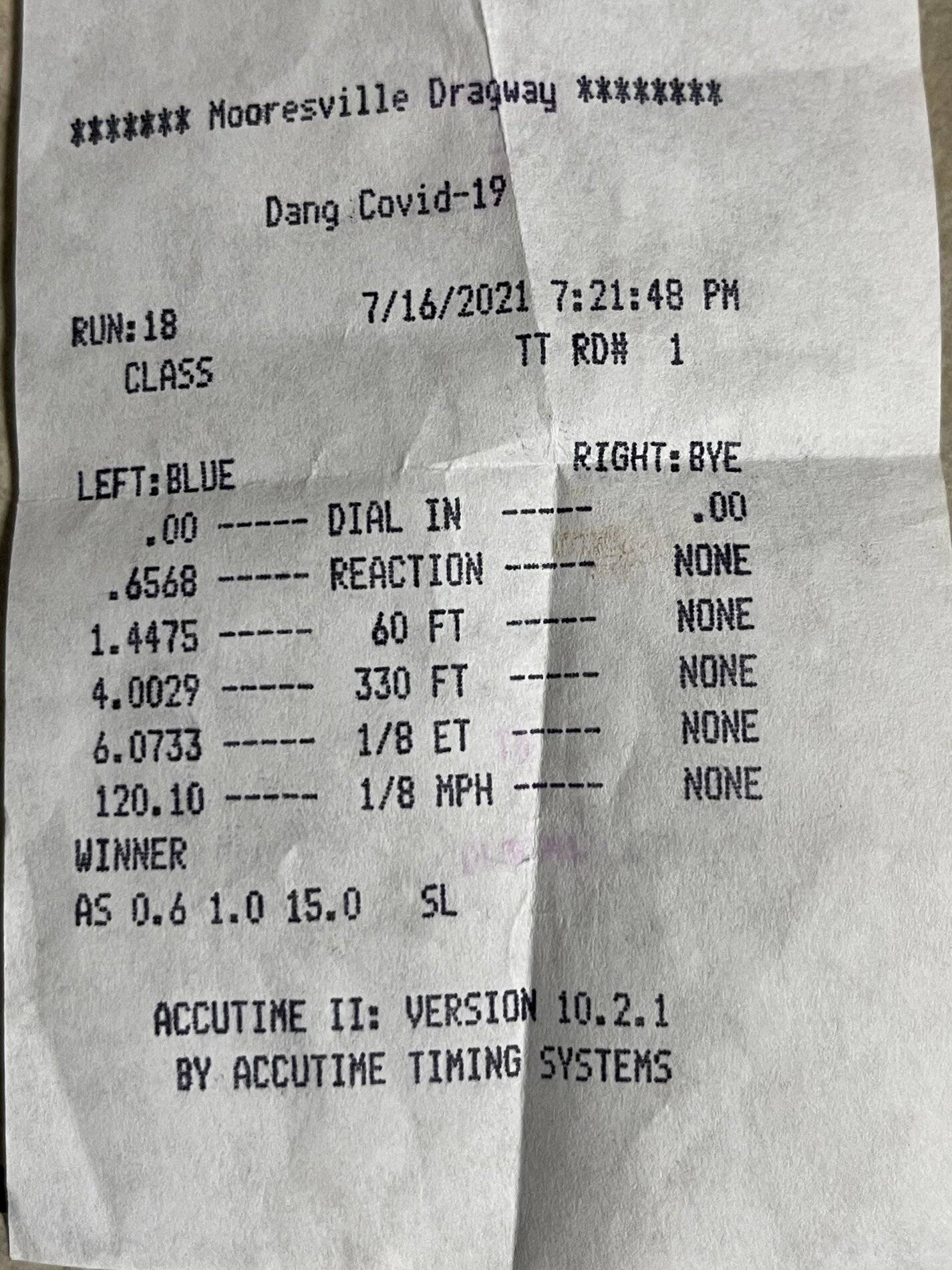

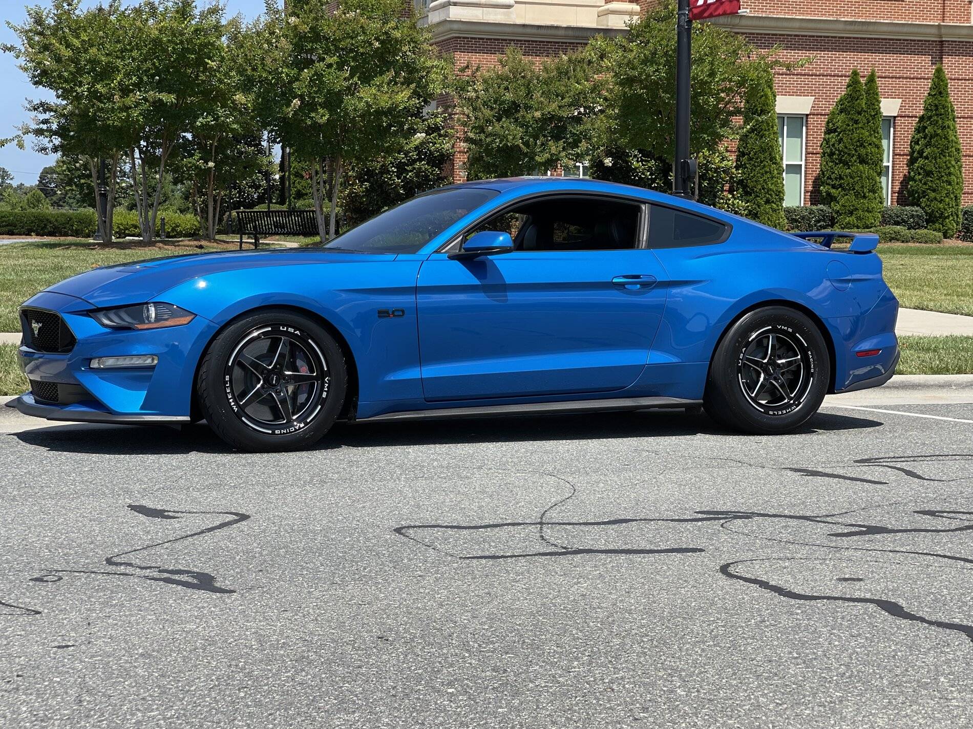

Made my first 1/8 hit friday evening… setup is
D1x 4” pulley 18psi
A10 circle D
Fore tripple pumps
PBD tune

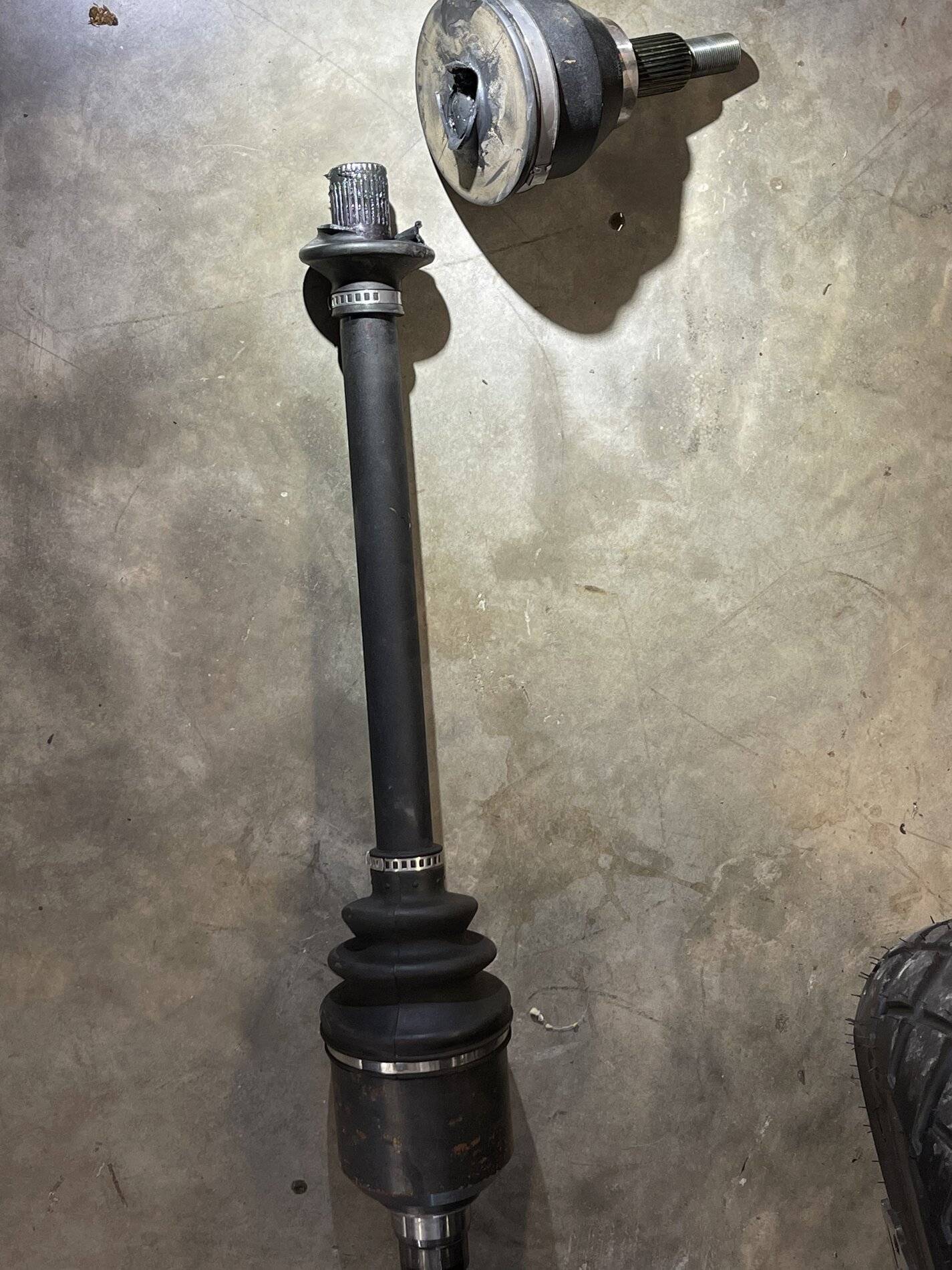

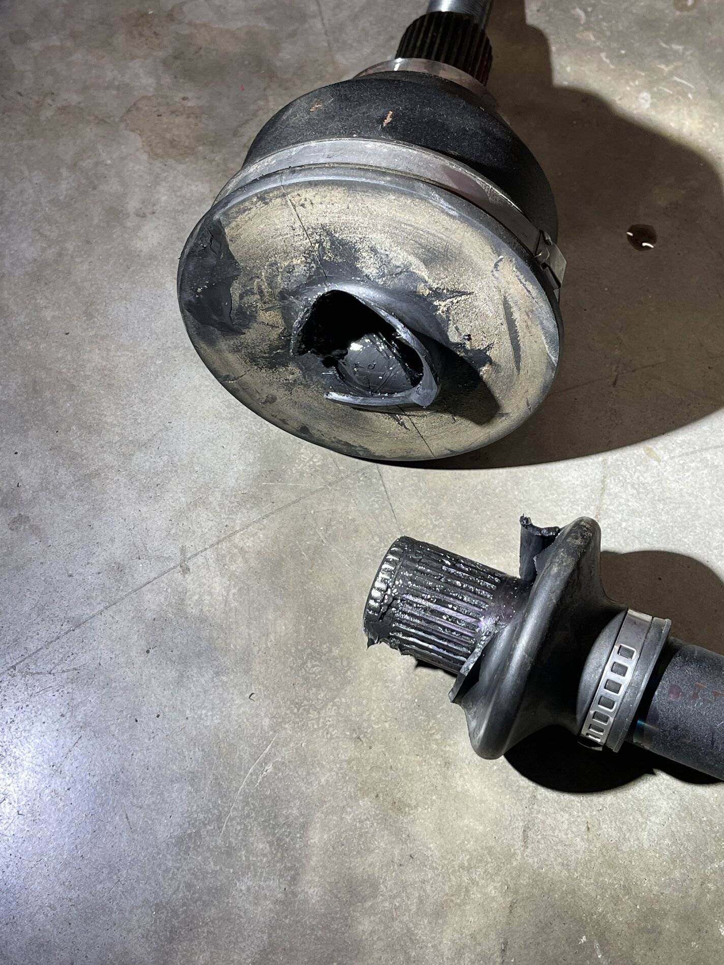

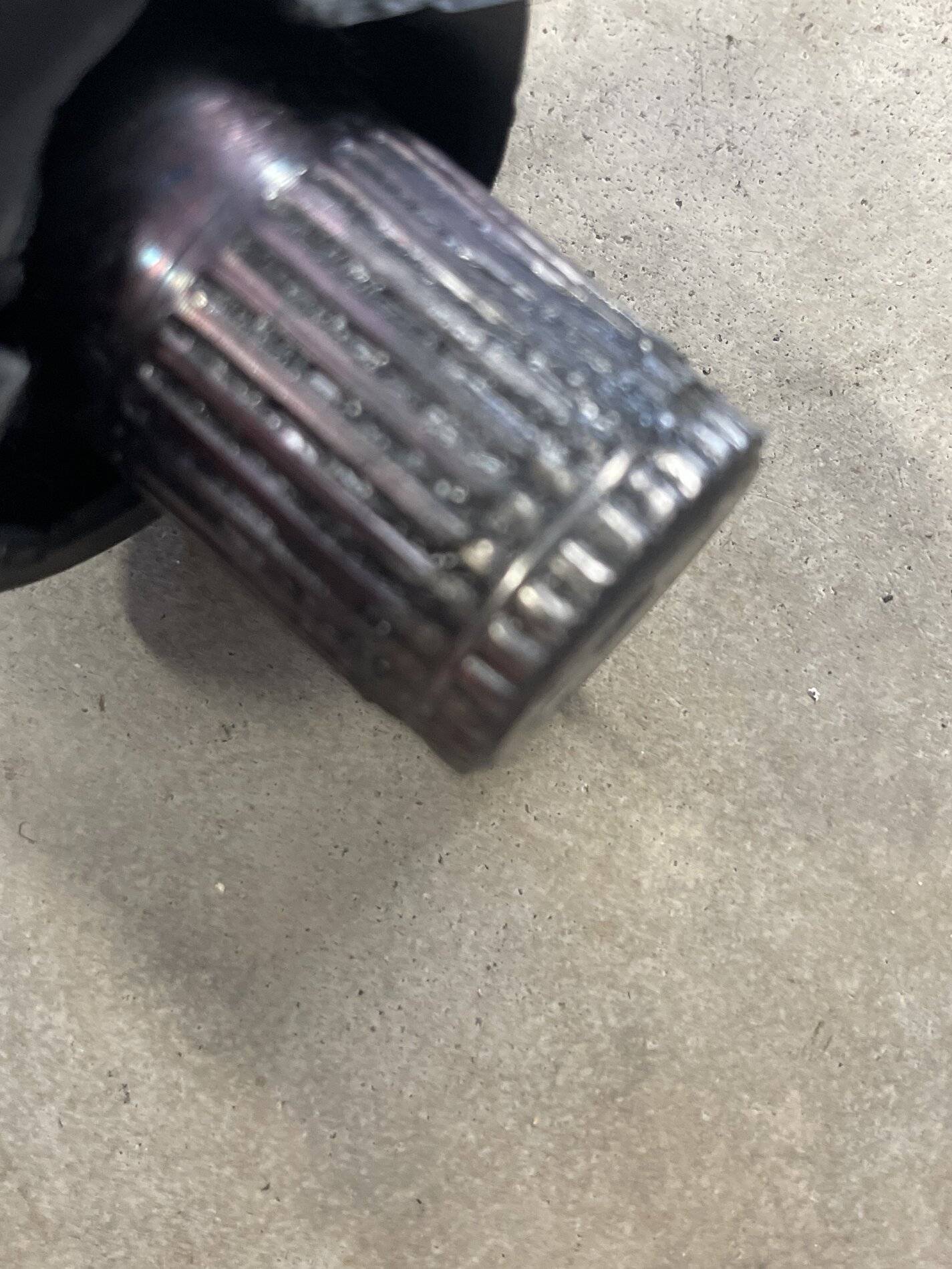

Car ran faster than i was looking for but broke a Axle on the topend… DSS 2000hp axles… Not real sure what happed so im going to Take it tommorow to Drive shaft shop and see what they say…

Losing an axle at 120 sounds scary. Gotta assumed there was some sort of manufacturing flaw with that axle?
Nice pass. Thing is moving.
thats what im thinking!! I will take it to RJ em tommorow and see what they say!!

When gear were you in when it broke? Seems common for 10r80 cars to break axles on the 1-2 and sometimes 2-3.
Right as it clicked 7th I believe…. right as i rolled thru the Traps 120mph

Why in the wide, wide world of sports are all of these DSS half shafts breaking? I would think a 2000 HP set of axles would be indestructible. As far as I know, those are the highest hp rated axles on the market; aren’t they? It almost seems pointless to replace the factory axles when you read about these HD axles snapping just as easily.

It shifted into 7th in the 1/8th?

It broke going into 6th… watching the video i aint sure if it made it to the 1/8 before it broke
