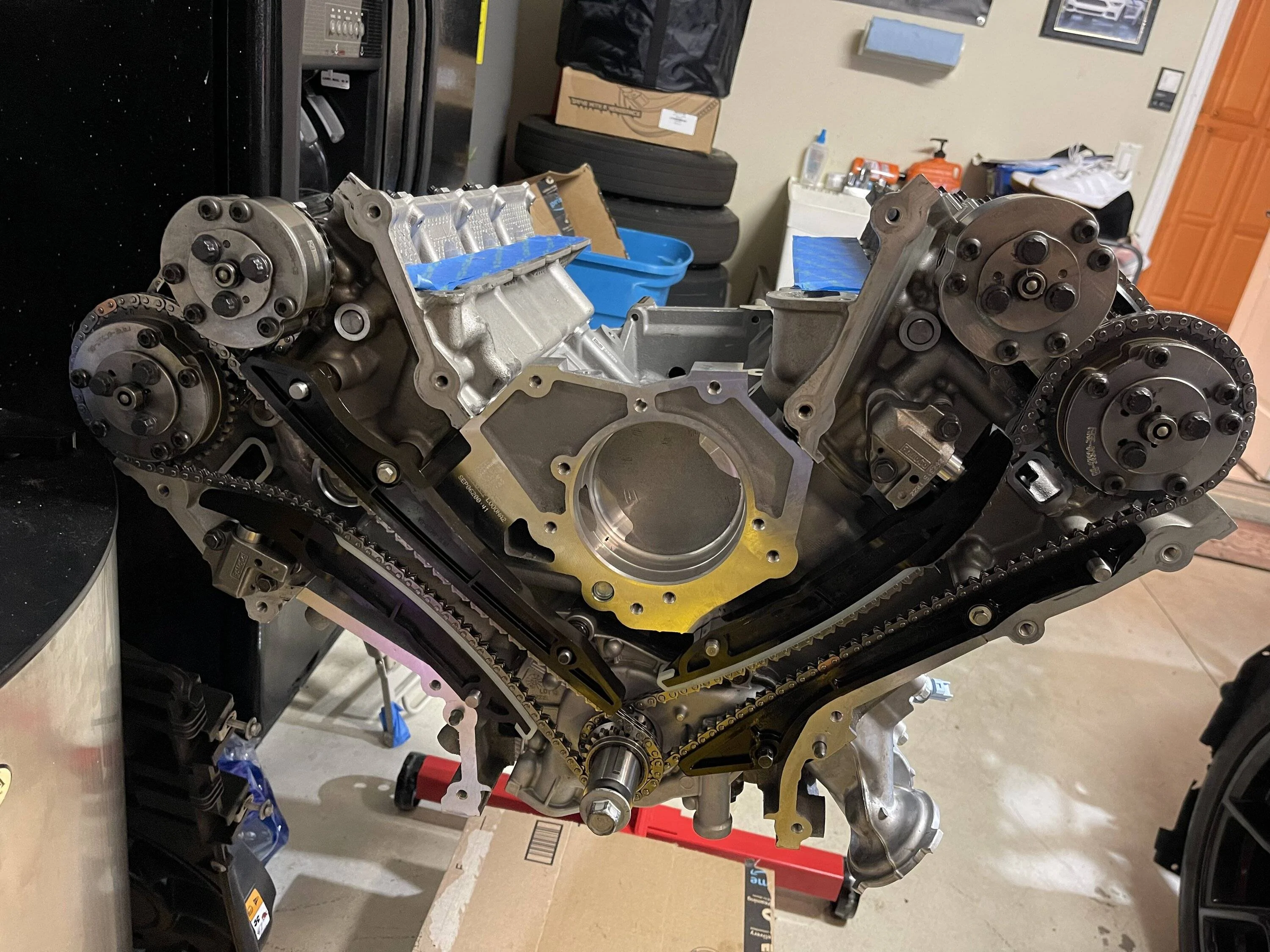

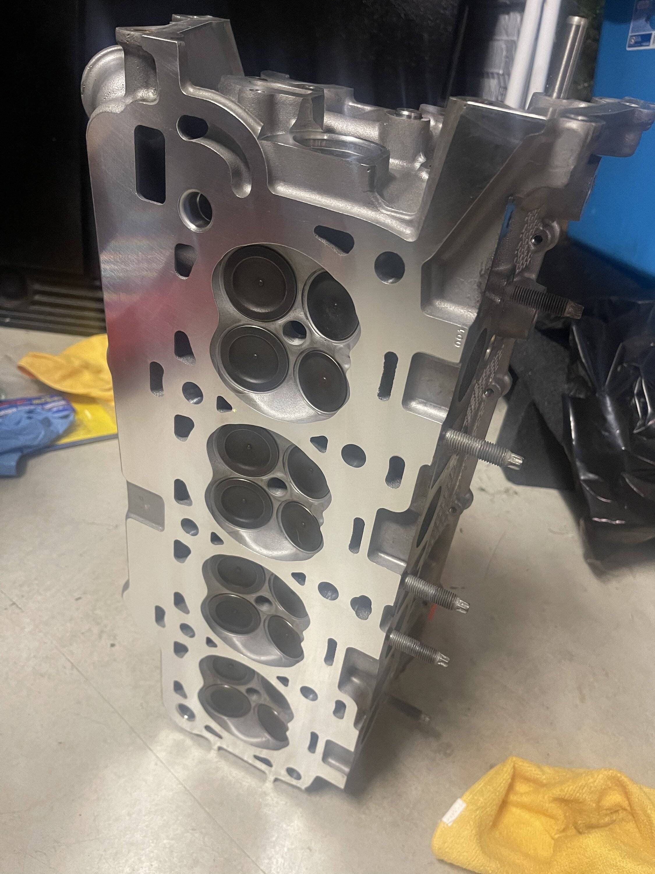

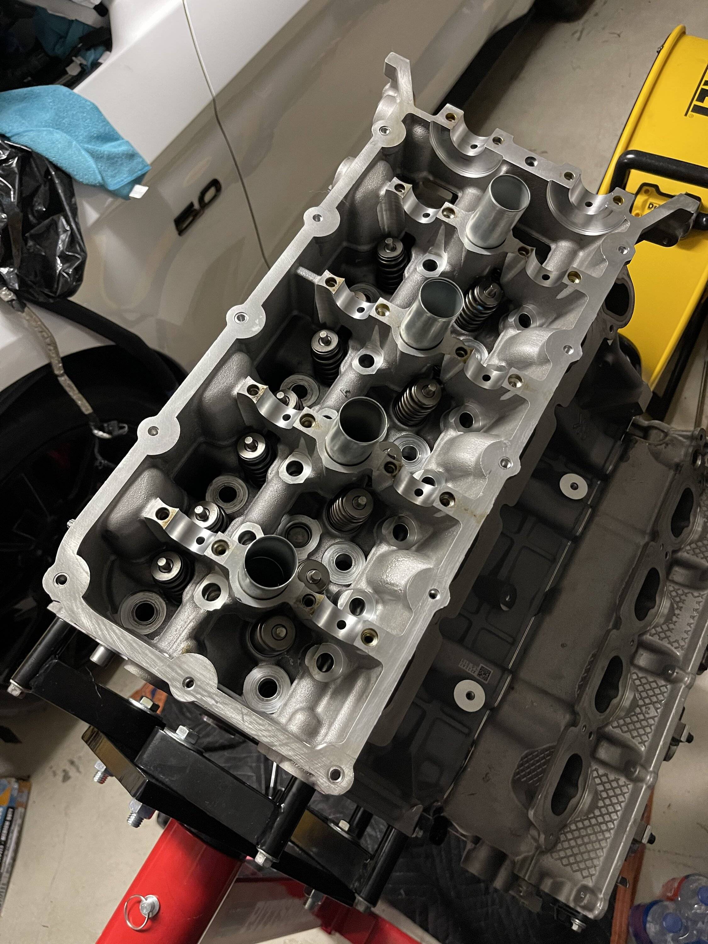

Hey everyone, sorry I’ve been busy so I haven’t gotten back to this.
I still haven’t had a chance to break the old block down, but someone was commenting about how it looks like the part of the piston was sandblasted, and then a portion of the piston is on the sleeves. When looking it over last week, me and a friend definitely noticed that it looks like the sleeves were not gouged, but they looked like they had the piston melted on them. My oil pan was full of grains of metal and chunks of metal.
My empty intercooler reservoir was because I had a hole in one of my intercooler bricks. Both of these things happened what I think is at the same time. Hole in the inner cooler, and burned up cylinder six.
Right now I’m just focused on building the new block to get my car back on the road. Just waiting on a new oil pick up tube so I can mount the oil pan and timing cover.
