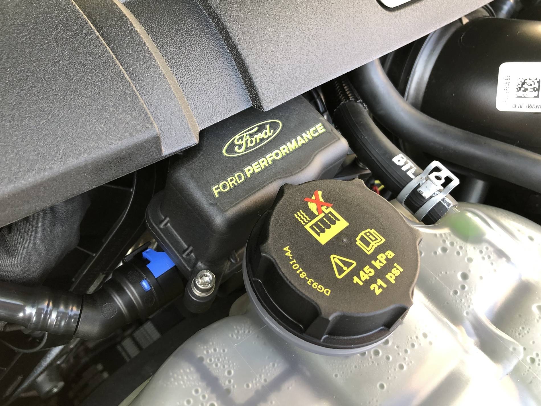

It’s kind of almost under a vent, but I’m not really sure how much of a difference the vent would make ... ?

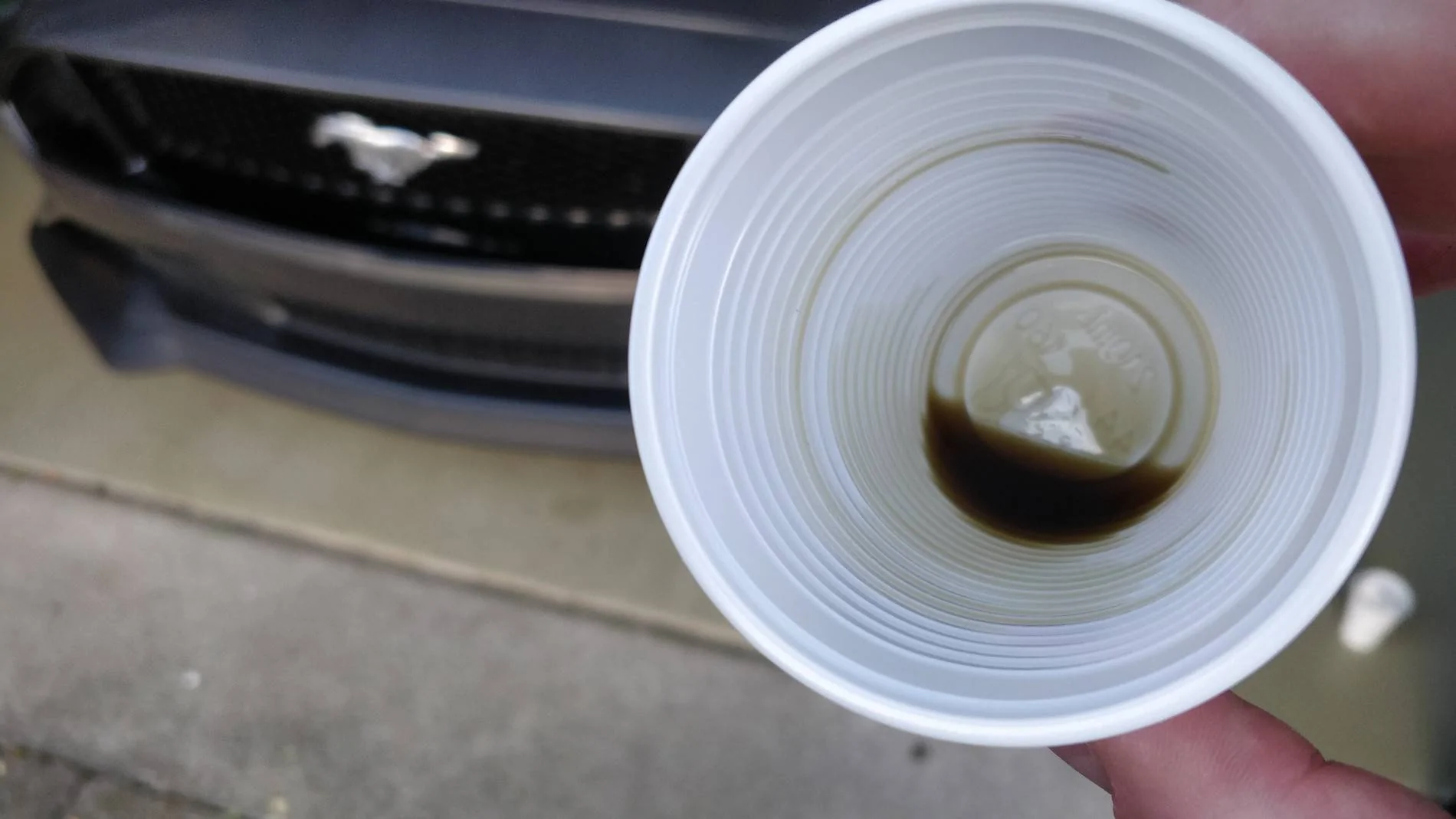

@WD Pro and @Vlad Soare
An update from Denmark!
I hit 1000km in my car and took out the catch cans.
This is a picture of the amount of oil that was in the R/H side
It is a very little amount but just thinking of this would have been enden up caking in the engine over time makes me happy that I installed the catch can!
The L/H side is not worth mentioning... it was dry - as in BONE. FREAKIN'. DRY. I even wiped my finger in it but it was as clean as when I installed it.
And for good meassures - I have the JLT 3.0 catch cans on both sides :like:
