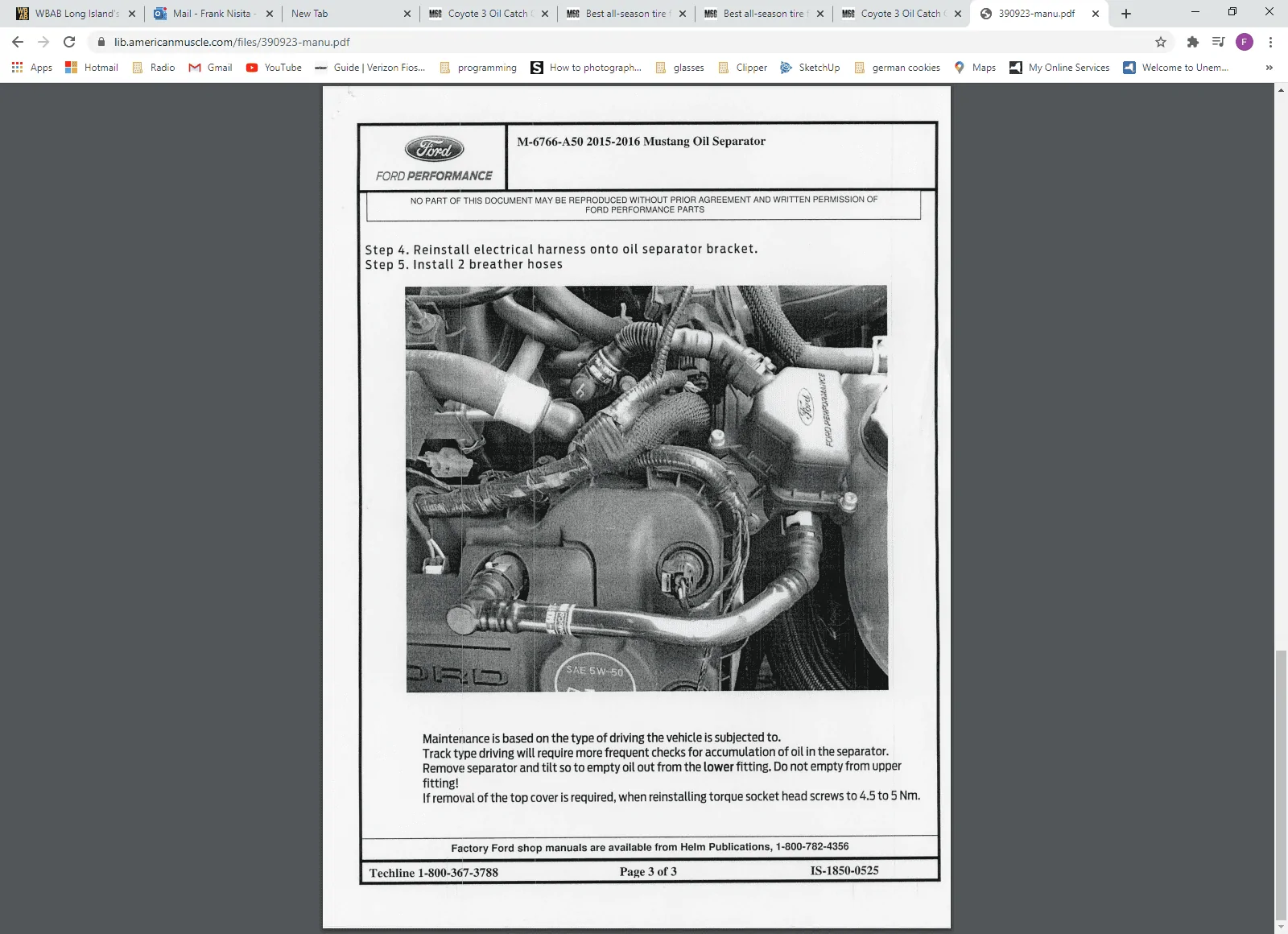

To be clear :
Initial fitment takes about 15 mins and requires a torque wrench to do it correctly.
After that, you only need your hands to remove, empty and refit it.
You can take the top of it if you wish to clean / dry it out - that requires a torque wrench to put the lid back on correctly.

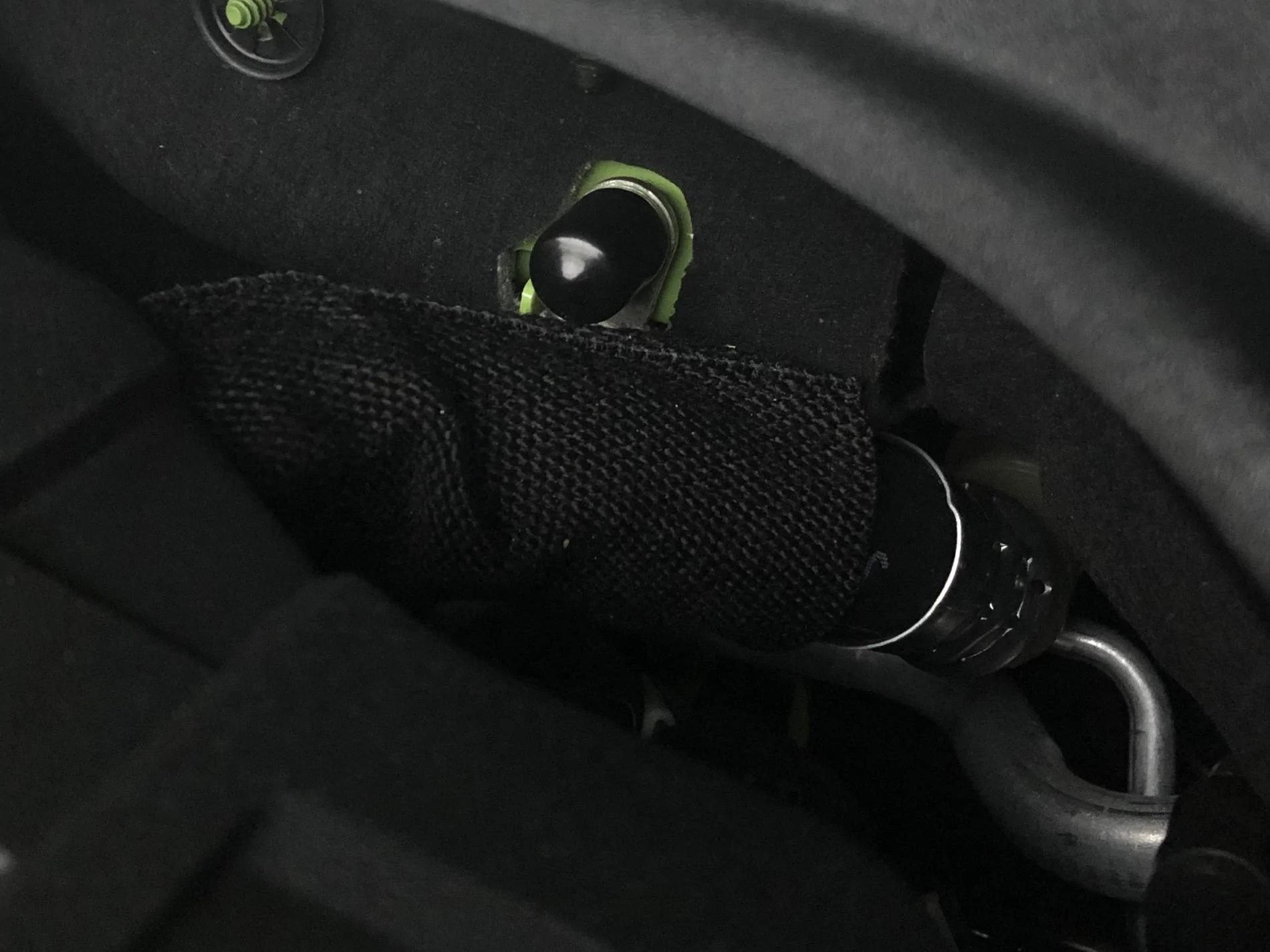

My question based on so little fluid is it that either you have a good engine or a poor performing catch can. Could you photograph the outlet pipe just after the can? If you see moisture/oil there, you know your can is not that good. I have seen testing where they put can in series and often the second can caught stuff after some cans.
After reading your comment I couldn't think of anything else than I had to check that tube, haha! With my luck it had to be the catch can that was garbage...
However!!! - This it the picture of the outlet tube. And I wiped the pinky in there and it was dry :fingerscrossed:

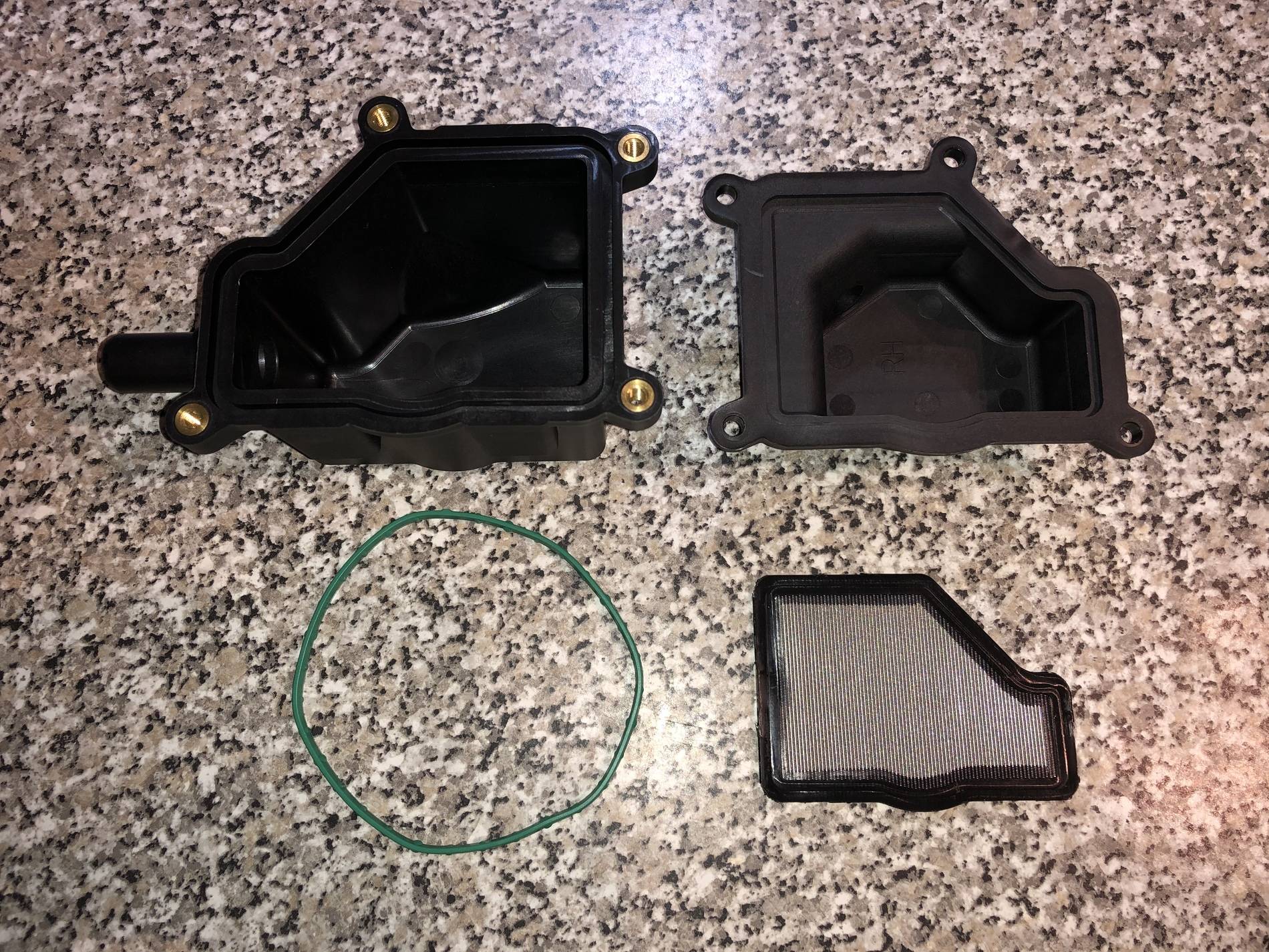

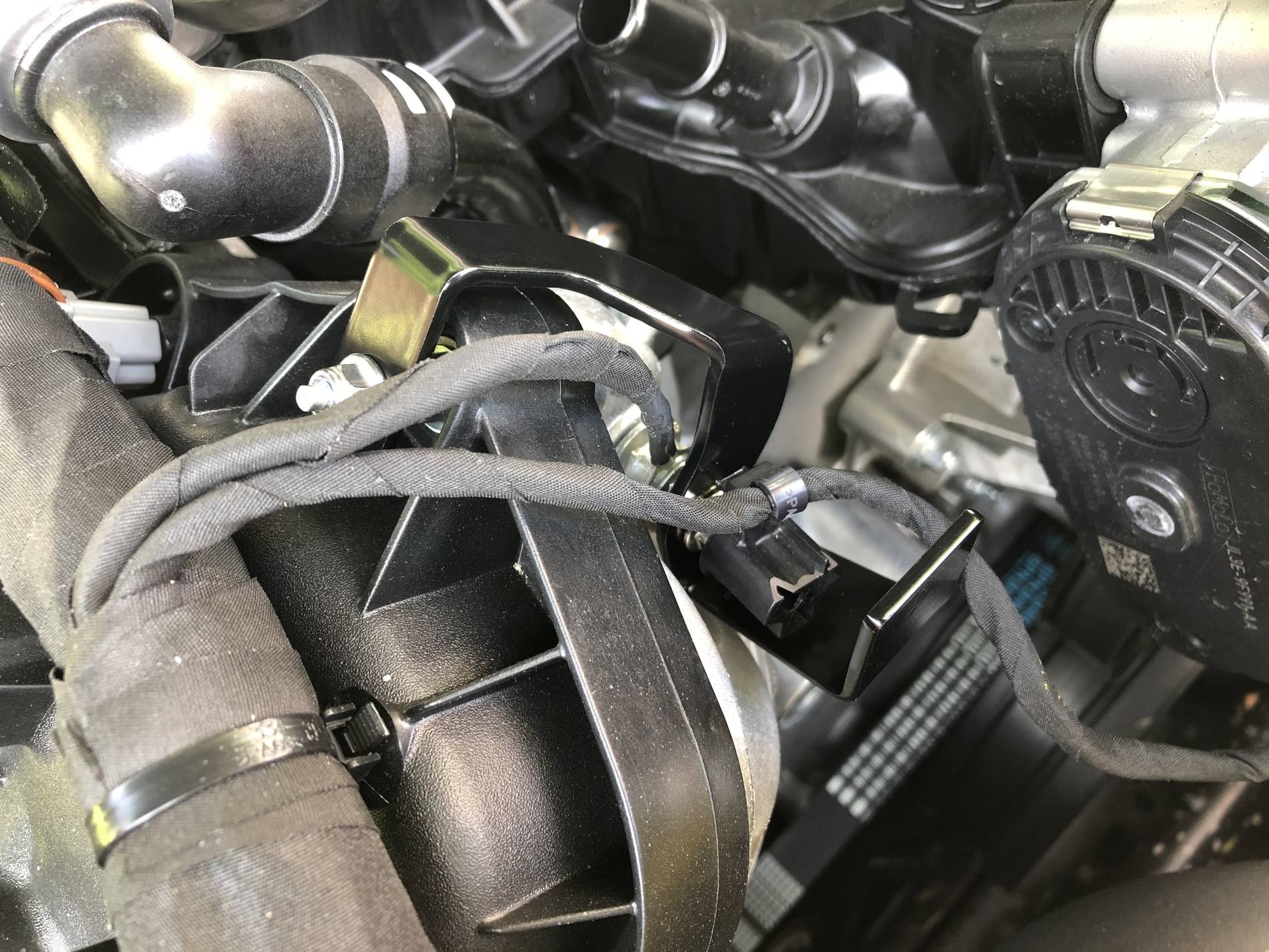

If it helps, here’s the 2018+ bracket that the can sits on :
And here’s one stripped :
WD :like:
Oh man, that's overkill. The lower bolt would have been enough, no? But at least that bracket will never move attached to 2 points. Just wish the nut on top of the visible bracket was prettier. Ha ha. I might look for a black closed nut, and cut the top of the bolt if necessary.

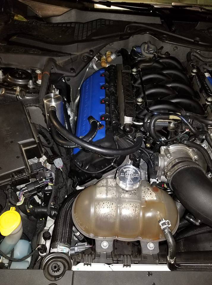

I really like my Bob's catch can. It has a pet cock valve on the bottom for easy draining. My Coyote is tuned to 7,800 rpm and I drive up to that point. It works.

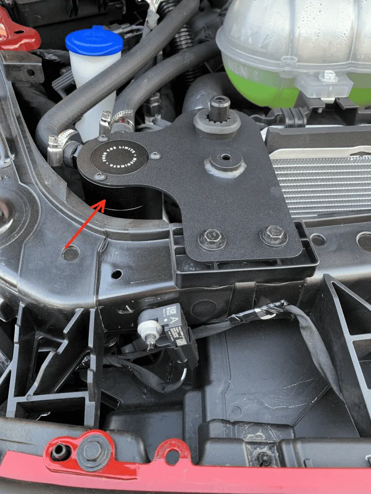

Thanks, I've ordered a Ford Performance one. :like:

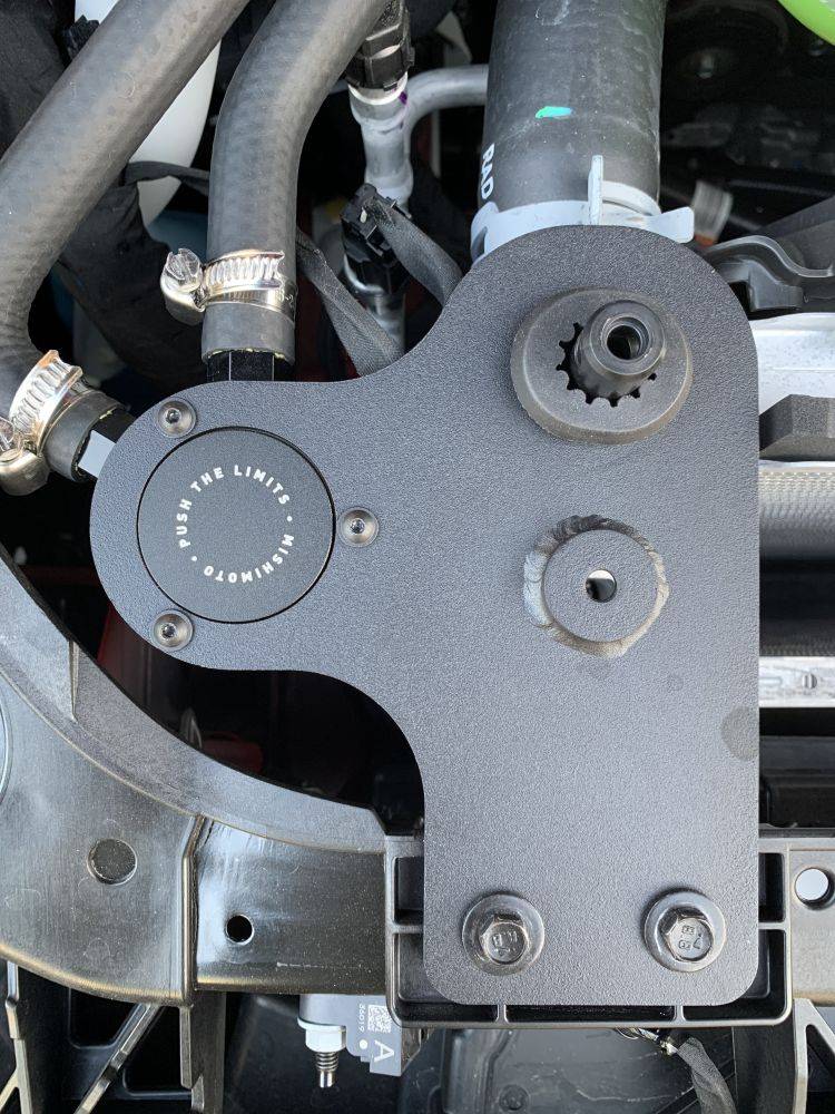

The Ford Performance wasn't in stock at the time, so I cancelled the order and got a Mishimoto instead. And I'm glad I did. It looks awesome, you can feel the quality, I really like it. It was very easy to install, and it can be emptied easily - all it takes is the removal of the radiator cover.

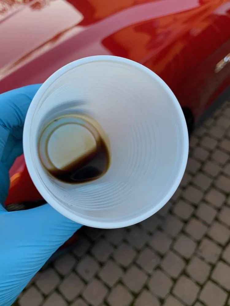

And this is what I found inside after one thousand kilometers:
Five milliliters, measured with a syringe.
