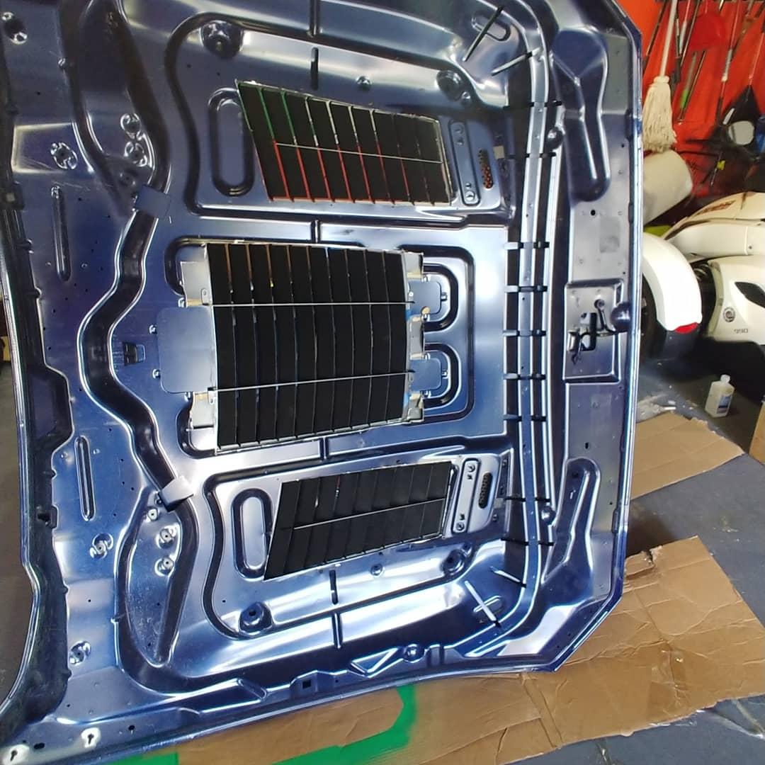

Question 1: Ive heard mixed opinions on running with the rear hood liner and battery cover removed to allow more airflow through the bay and help with coolant/oil temps. I've also heard that there is a high pressure zone at the bottom of the windshield that can actually force air into the bay instead of let it out. Anyone have any experience with it off? Any negative side effects of leaving the weather stripping off? Doesn't look like rain can get in.
The pp1 has a 350 radiator ..up to 230 is pretty normal om 20mims session
I removed the foam under the hood. And open the little mini vents ..i now have full trackspec hood vents. No huge help on vents but can helps a lot with downforce .
The pp1 has a 350 radiator ..up to 230 is pretty normal om 20mins session
