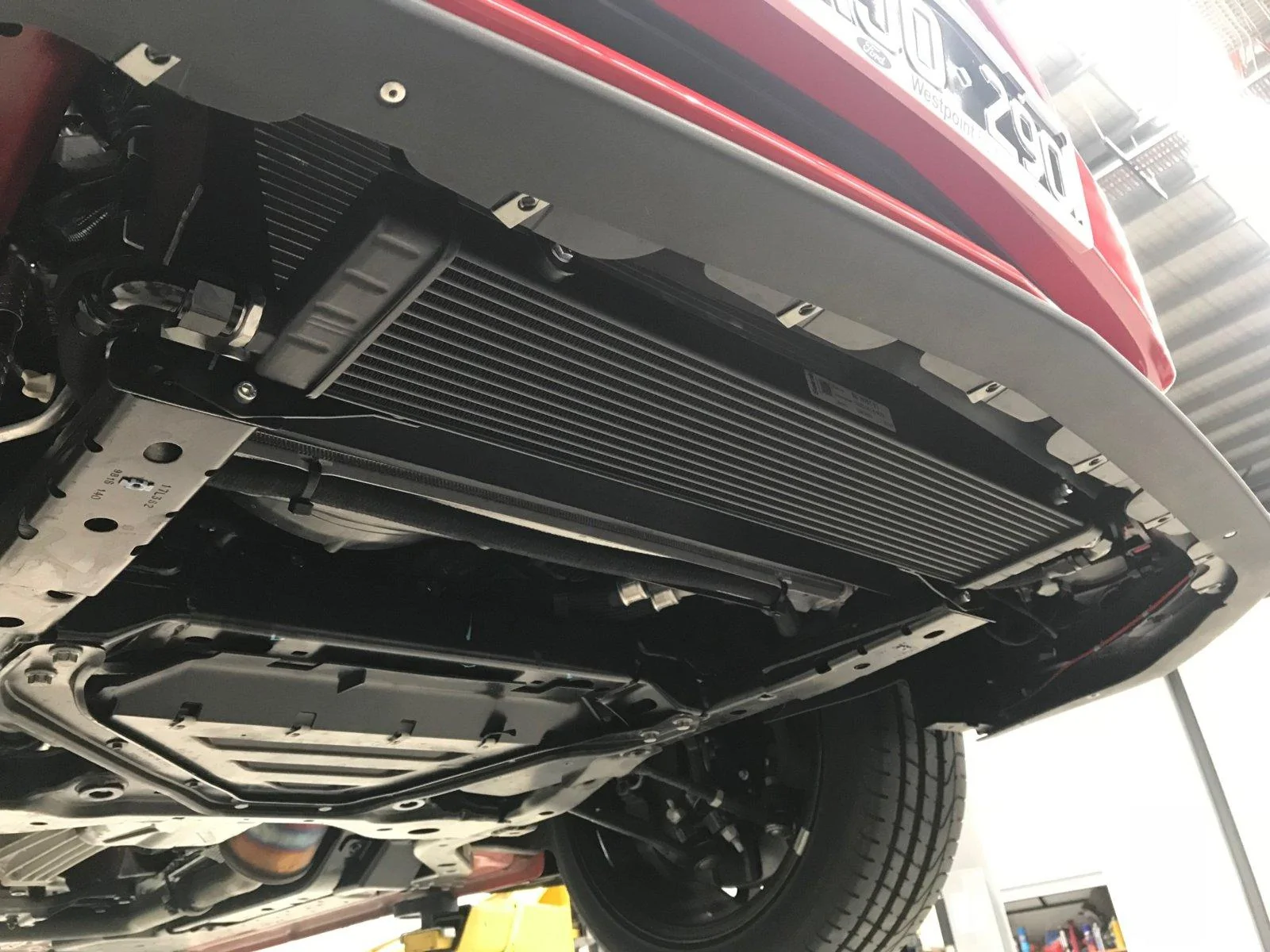

how long to fit? easy/dificult to fit? looking at this as well

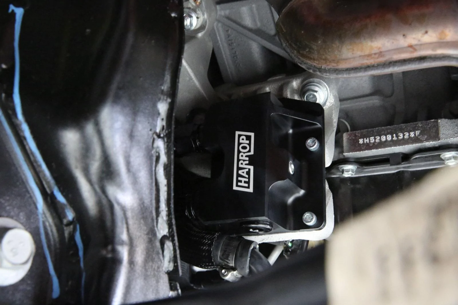

I got the Harrop oil cooler installed by Harrop. It has the best quality cooler and fittings, and it is a neat install plus they have really good service. Although I am very handy, it is worth getting them to install (rated at about 3 hrs) if you are in the area as it was a modest install price that included the consumables and you get peace of mind for this critical component as I am sure that they will stand behind it. There was a slight cosmetic imperfection in the cooler tank in the first install and they replaced it without question or any charge.

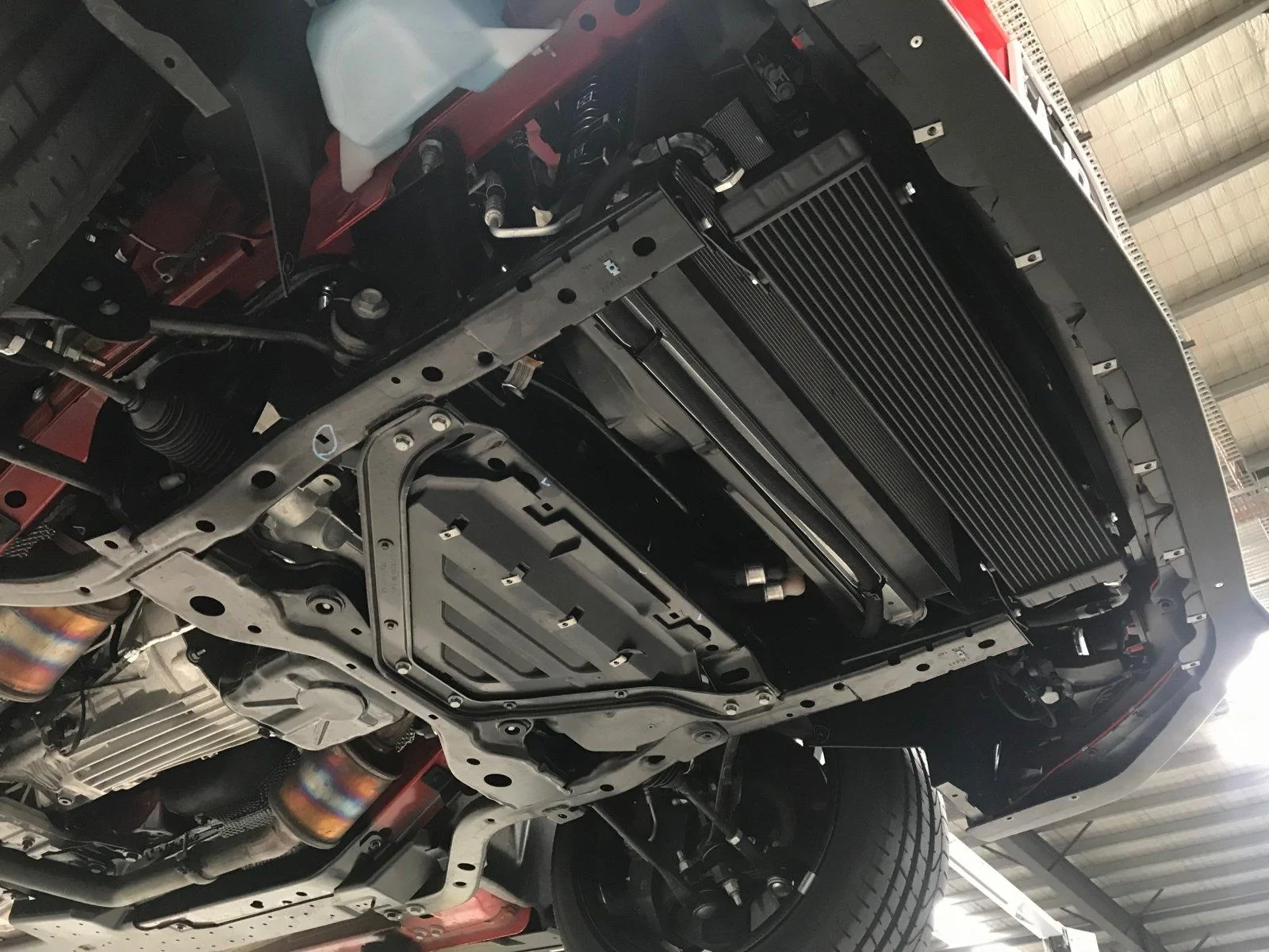

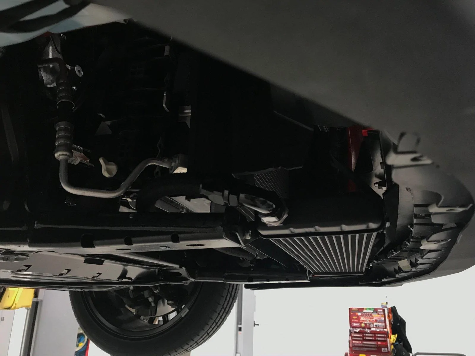

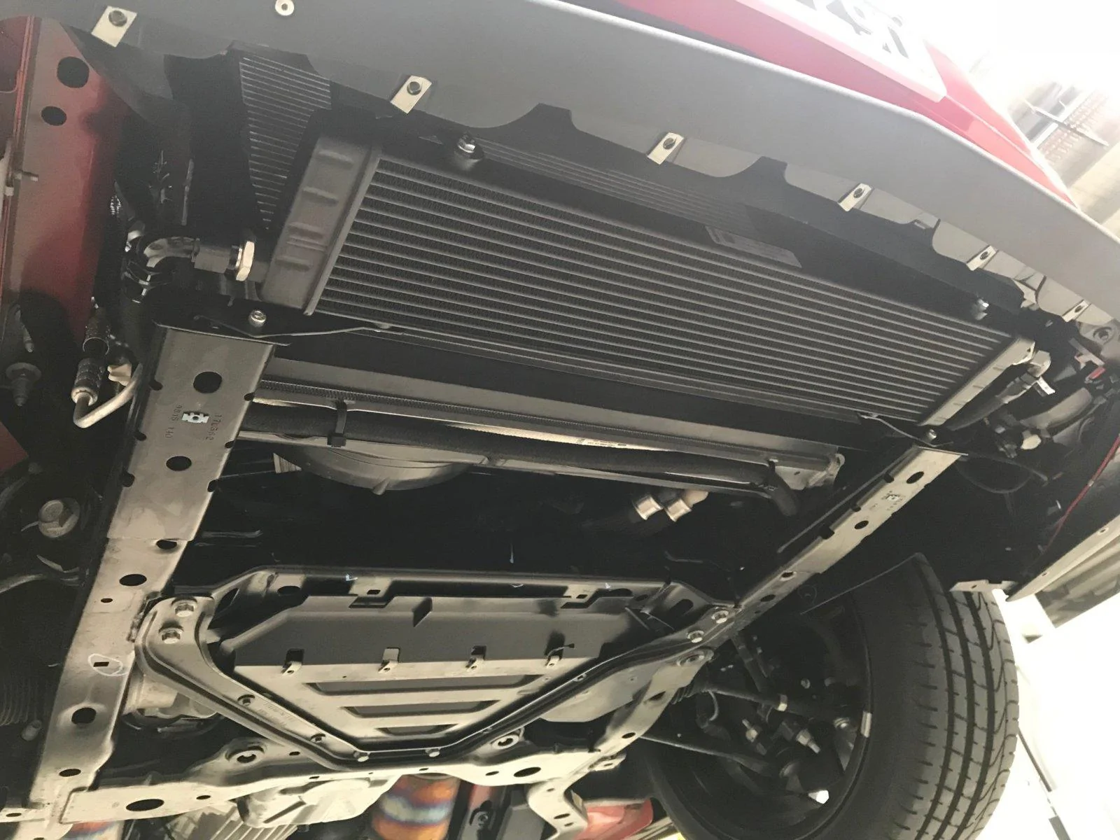

Just looking at this setup a couple of questions I have
1. Is there any airflow going through the cooler given it mounted horizontally and will sit just above the under tray
2. is the lower radiator hose replaced or is there some sort of loop back where the old cooler was mounted.

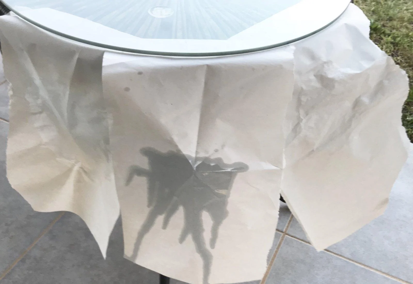

Hey all there seems to be a bit of panick about this so I’ll share a ghetto check we use on older aviation engines if we suspect an oil based contaminant in water based liquids, before we go spending big dollars on outsourcing chemical lab tests to third parties.
Oil in coolant check:
What you need: a sheet of butchers paper (or low fiber white paper equivalent)
To check:

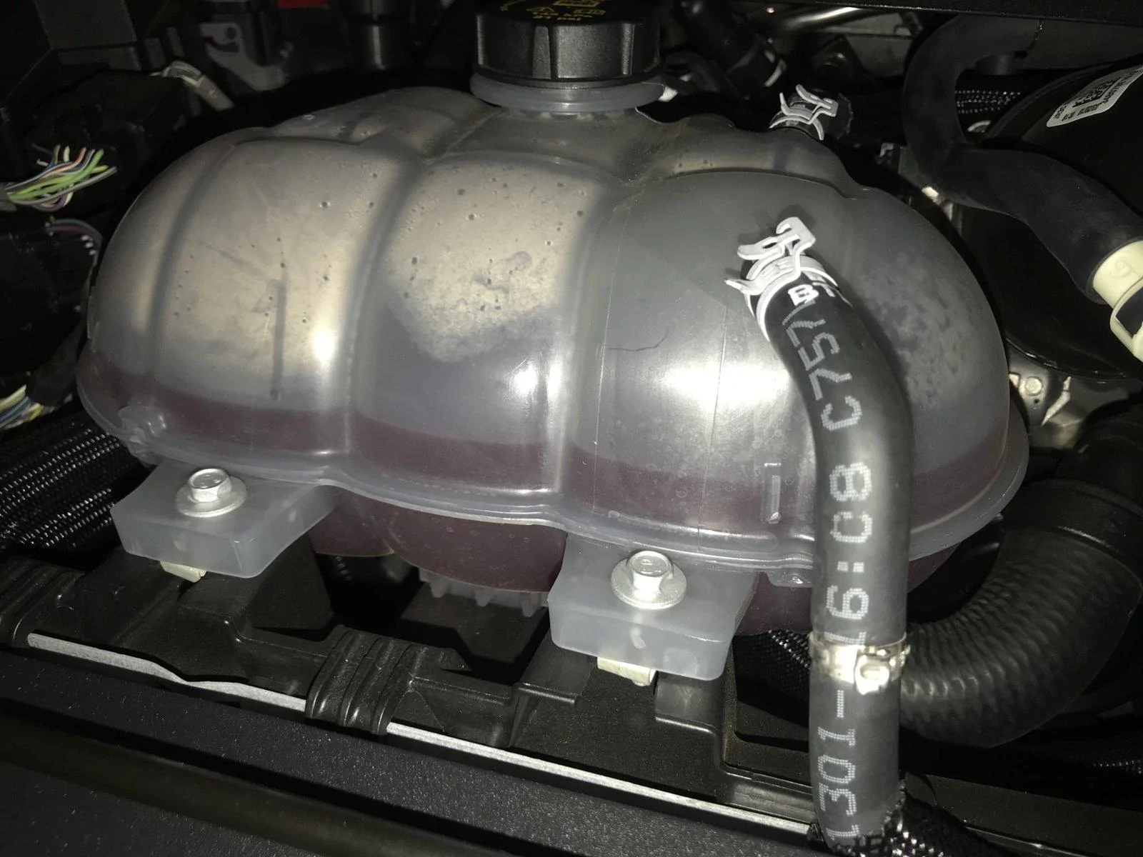

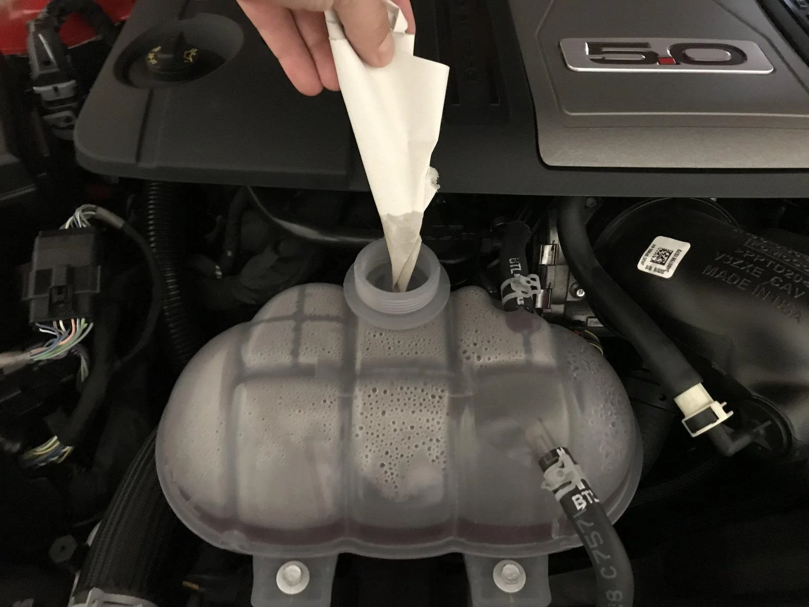

*Do visible check on outside of coolant reservoir for obvious oil contamination (last picture, pic 3). There will be a noticeable darkened discoloring along the top of the coolant level (not the top of the reservoir). If this is so then it’s bad news. Any more severe than this, and you would have seen some white smoke coming out the exhaust, and smelt coolant burning on hard pulls, and you’d see/smell coolant in your oil separator if installed. This contributes as imminent failure evidence.
*if the above shows no discernible contamination, then do below steps for further investigation to see if the problem may become evident at a later stage:
- get piece of butchers paper, fold and insert very slowly into reservoir, just enough to get it slightly wet with coolant (see first pic, pic 1).
- remove paper and let dry.
- while it’s drying you can get another piece of paper and wet with normal water (as a reference)
- if you have some car oil and coolant handy, you can make another control piece of paper by combining 5ml oil and 500ml coolant. Dip paper in and let dry.
See pic 2 (middle picture) for my results:
On the left is the test piece I placed into the coolant tank, the middle has less than 5ml oil to 500ml coolant, and the right piece has just water.
Even after only 20 mins of dry time I can see the left piece (test) looks almost the same as the right piece (water). (See pic 2) The middle piece looks completely contaminated with oil, and this will happen because the oil sits on top making a thin layer that bonds onto the paper and won’t allow any coolant/water though. This tiny level of contamination is way too thin for the human eye to see if just looking into the reservoir.
I’ve done just over 10,000kms of moderate driving in my 2018 mustang, so this check assured me that the oil cooler is working perfectly normal, as I can not see any evidence whatsoever of oil in my coolant.
If the test failed, I’d suck out roughly 250ml of the coolant and send it off to the lab for a proper test (giving evidence to Ford). These guys are in QLD and do a decent job for decent money in a reasonable amount of time: https://www.alsglobal.com/au/services-and-products/oil-fuel-and-coolant-analysis or this method https://www.penriteoil.com.au/products/coolant-test-strips#/ is a little less expensive as well.
After an hour of dry time a successful result will show the test piece still appearing damp with no shine in light (detergents in the coolant will do this), but definitely not greasy. The oil control peice will be just as oily as when first set to dry with a shiny surface, and the water test piece will be dry.
Hope this ghetto test can give others assurance as well.
cheers
The airflow comes from the lower grill there is no extra ducting or diverter. It is a high pressure area and the air will flow through there as normal.
There is a loop in the radiator. I was going to get a full size radiator to replace the factory tee unit. But, I did not know the ID and how easy it would be to remove the existing fasting clips.
I would have thought it better for cooling to remove what looks like a restrictive factory tee, Harrop did not think it was an issue.
