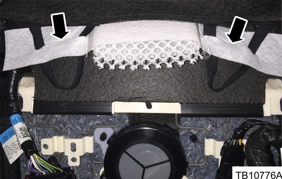

The TSB replaces the backrest blower motor with a redesigned one that contains a fabric air channel for the hot air to escape.
I thought the "fabric air channel" was to draw air from under the seat ... not to exhaust hot air from the TED. Believe the hot air is still just rejected inside the seat back, and that's why the TSB fix doesn't seem to make much of a difference.

The TSB was issued in September 2015, so likely began to be incorporated in production vehicles around that time.
You can tell if the TSB modified unit is installed by looking under the seat from the backside. If there is a white intake "sock" coming out of the seat flap (see under seat image from TSB), you have the new version.
Correct, although it's more that their intake is insufficient then that the hot air being trapped (although that's still an issue). As mentioned, it does solve the hot spot issue though since the fan is no longer overheating.
My car was built in october and it did not have this fix.
I believe it's only a TSB so unless the customer complains, they don't take actions.

I did the TSB. See the pics for results.
The seats have 2 blower motors, one for the bottom and one for the backrest cooling. The TSB replaces the backrest blower motor with a redesigned one that contains a fabric air channel for the hot air to escape. If you are frustrated with the heat generation in the lower portion of the backrest and you can get the TSB done for free: DO IT.
Pic1 : Before
Pic2 : After
The seat bottom is not "excellent cooling".
At the three-bar setting, you get what should be about two bars of cooling. One bar is negligible.
Well it was the end of September that the TSB came out, so it might have taken awhile to work its way through. Depends on how far in advance the seats are assembled, I suppose. Although maybe the TSB didn't make it into any 2016 models. Perhaps anyone else with a build date around that time (October 2015 and later) could share.
My opinion though is your better off with the original unit. There will be options to adapt it for improved performance – mine (available soon) and possibly others. I think, but haven't proven yet, that they went with a lower speed fan in the modified unit which greatly limits its ability.
My build is May 31st, 2016 and it still has the issue. Considering that was the last production day for the 2016 mode year, I'd consider it safe to assume this is an issue on all 2016's.
Corrected my post. Thanks.
I wished that the TSB would make the back cool just as good as the bottom, but oh well. I've had it for a week now and it has never developed heat in the lower region yet, which used to be extremely annoying.
I agree that the bar system is kind of pointless, I never had the need to go any lower than 3 bars.
