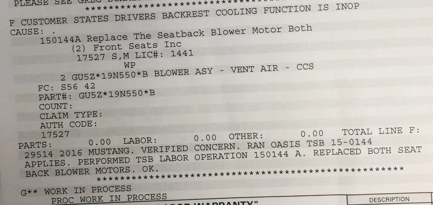

Just an FYI:
In Sept. 2017, my Ford Service Center replaced both upper seat back blower motors under warranty in my 2016, based on a current TSB. See attached screen image of work order notes, TSB number and Ford part numbers.:

Just an FYI:
Did you find it makes a difference? They did mine last week and eh.. It's not much better.. Everyone says it's the design
