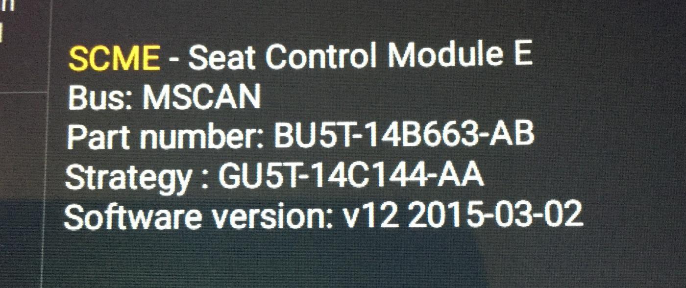

Just curious how you came to this conclusion. I'm assuming you have access to additional data from other GT350 owners or something, but you didn't make that clear.
Perhaps USMC0341 could check the software version for the SCME module. They may have done a full software upgrade versus just a parameter change.
I only have access to the phone app for Forscan right now so I don't know if the Windows version provides more detail. It says the software version is V11 2009-12-07. It also says the strategy is BU5T-14C144AB.
Here's what my scanner says..
SCME- Seat Control Module E
Part number: BU5T-14B663-AB
Strategy: GU5T-14C144-AA
Software version: v12 2015-03-02
Hope this helps...
