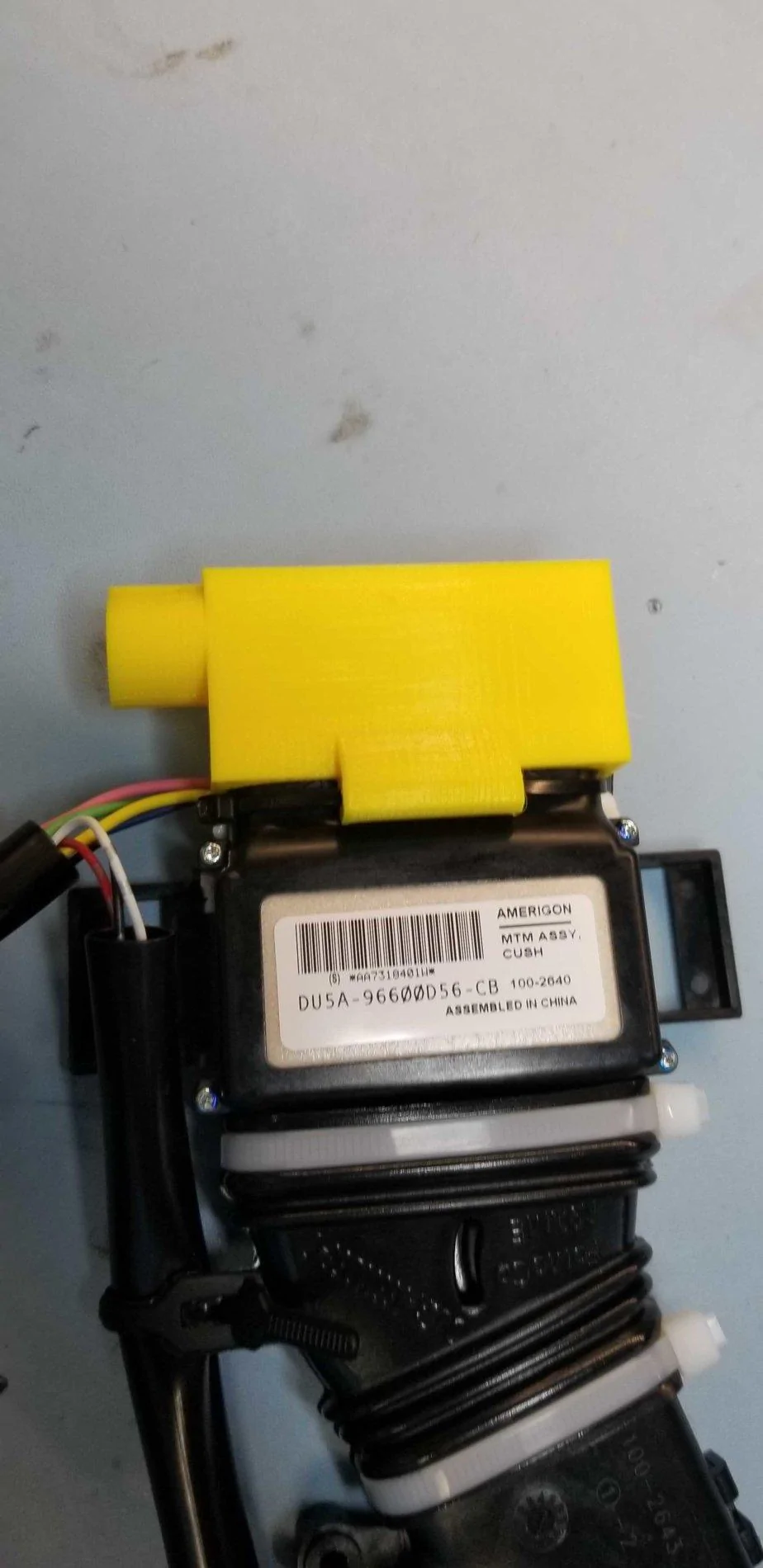

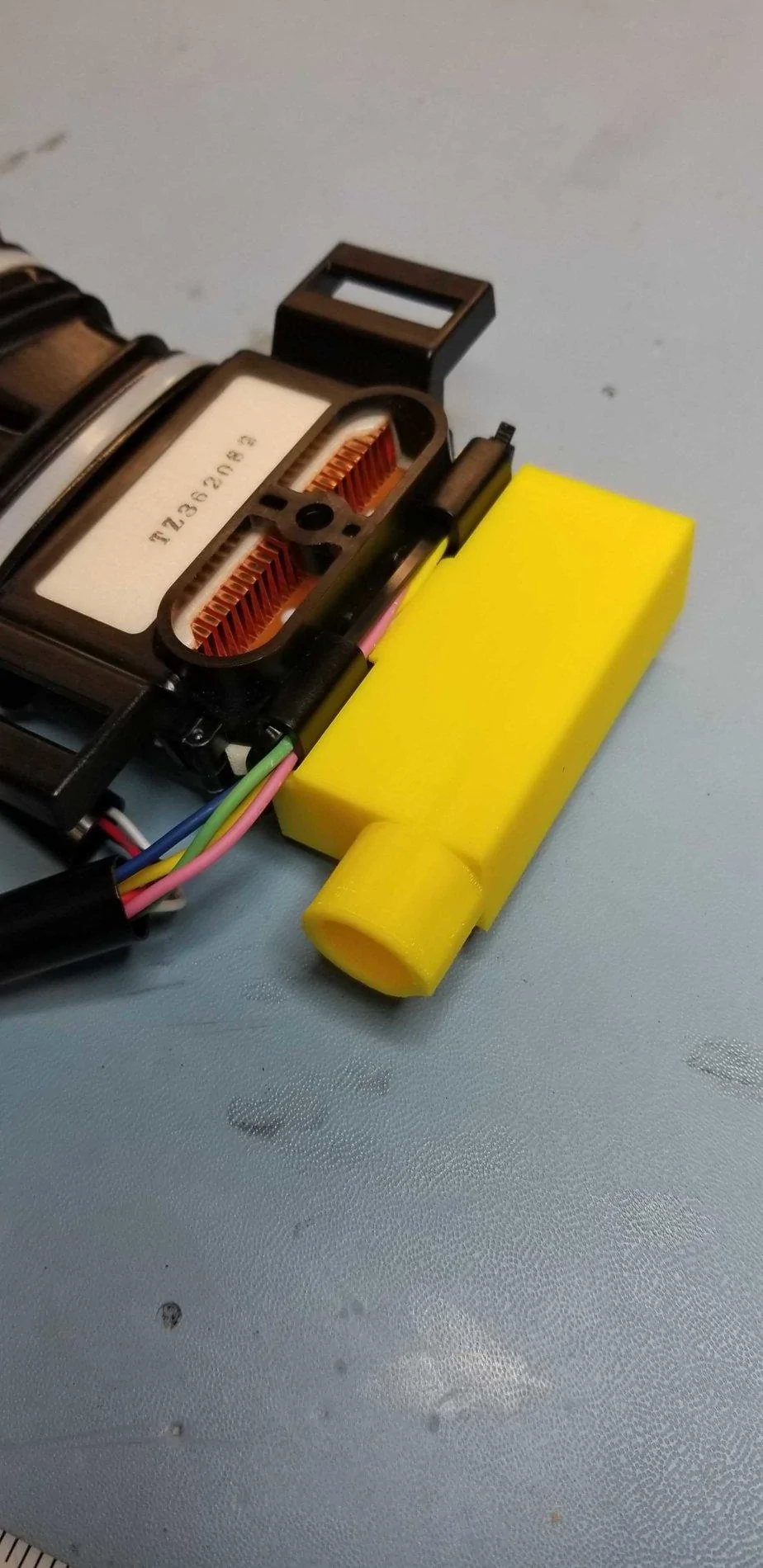

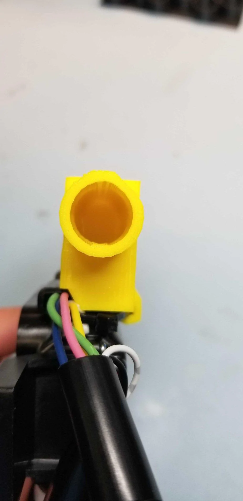

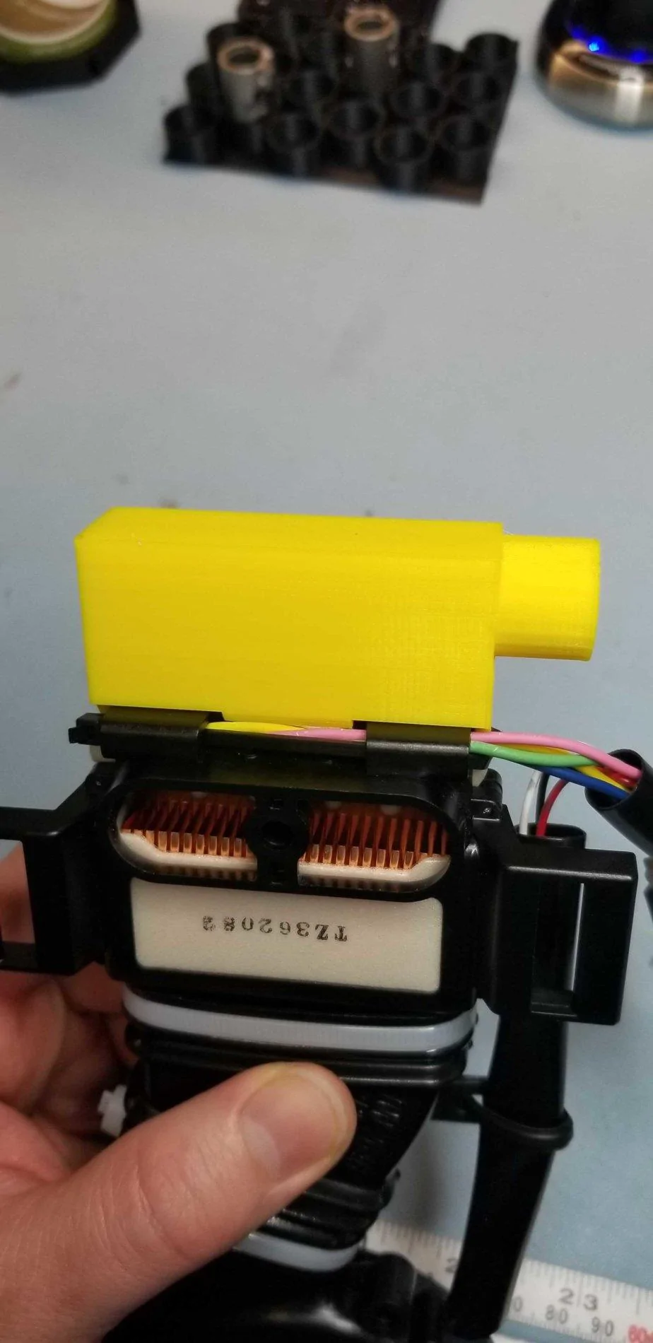

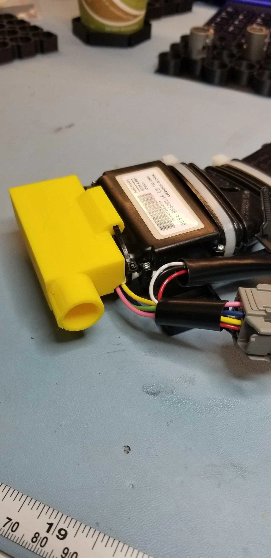

Hello to all! i am working on a solution to this exact problem described in RIBS post. The hot air cannot escape from behind the seat, obviously because hot air rises, and the geniuses at for did not bother to put some vent holes into the rear seat backs. So I am working on a prototype that should actually resolve the problem.
behold the TED pipe! This is a custom designed chamber that easily fits over the top of the TED and is held in place using a zip tie. A length of hose will be attached (similar to the DARKO hose setup) and the hose will feed to the bottom of the seat back. From there, a small fan will be attached that will SUCK the hot air out of the TED unit, making it much much more efficient.
I still need to obtain some decent tubing, source a proper sized fan (not too big or loud) and design a fan to hose adapter. Once that is all done, I will have to figure out a simple way to get power to the new exhaust fan.
I will keep everyone updated with results, and if its a success, I will be selling these as kits for a very reasonable price!

this one will be for either, and if you have the darko mod, itll be like having the tsb installed like the later mustangs. i am working on another revision of the part, to include the bend in the pipe already so i can source some cheaper tubing options.
