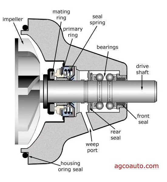

^^^ and you won’t see the leak unless you can get under the car to see the water pump weep hole - because once the seal starts to go bad the coolant will leak through the weep hole, that is by design.
If the water pump has never been replaced, then it’s most likely a WP issue.
Skye
Jan 18, 2022
2,987
4,189
≈39N
"Skye" Mach1 N2144
For reference, a general WP pic.
