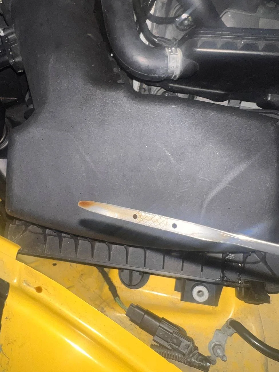

Hi Guys was hoping for some advice. I have a coolant leak in my car I’ve noticed that it has been slowly decreasing when the car is warmed up and I have my window down I get whiffs of coolant occasionally but my main concern is to know whether it’s something serious such as a head gasket or not I checked the dipped stick but just wanted a second opinion to see if it looks alright ? Also idk if it’s me but I feel like it’s running a bit rough too small jitters here and there

Dipstick looks fine. Believe me, the milkshake is unmistakable.
Smell your exhaust on a cold start to see if it smells sweet. That would indicate a headgasket problem.
If the smell is inside the car, that would be a heater core and, besides a headgasket, your worst case.
Otherwise, get under the hood and start following all the coolant lines looking for wet or crusties. Check the radiator sides as well.

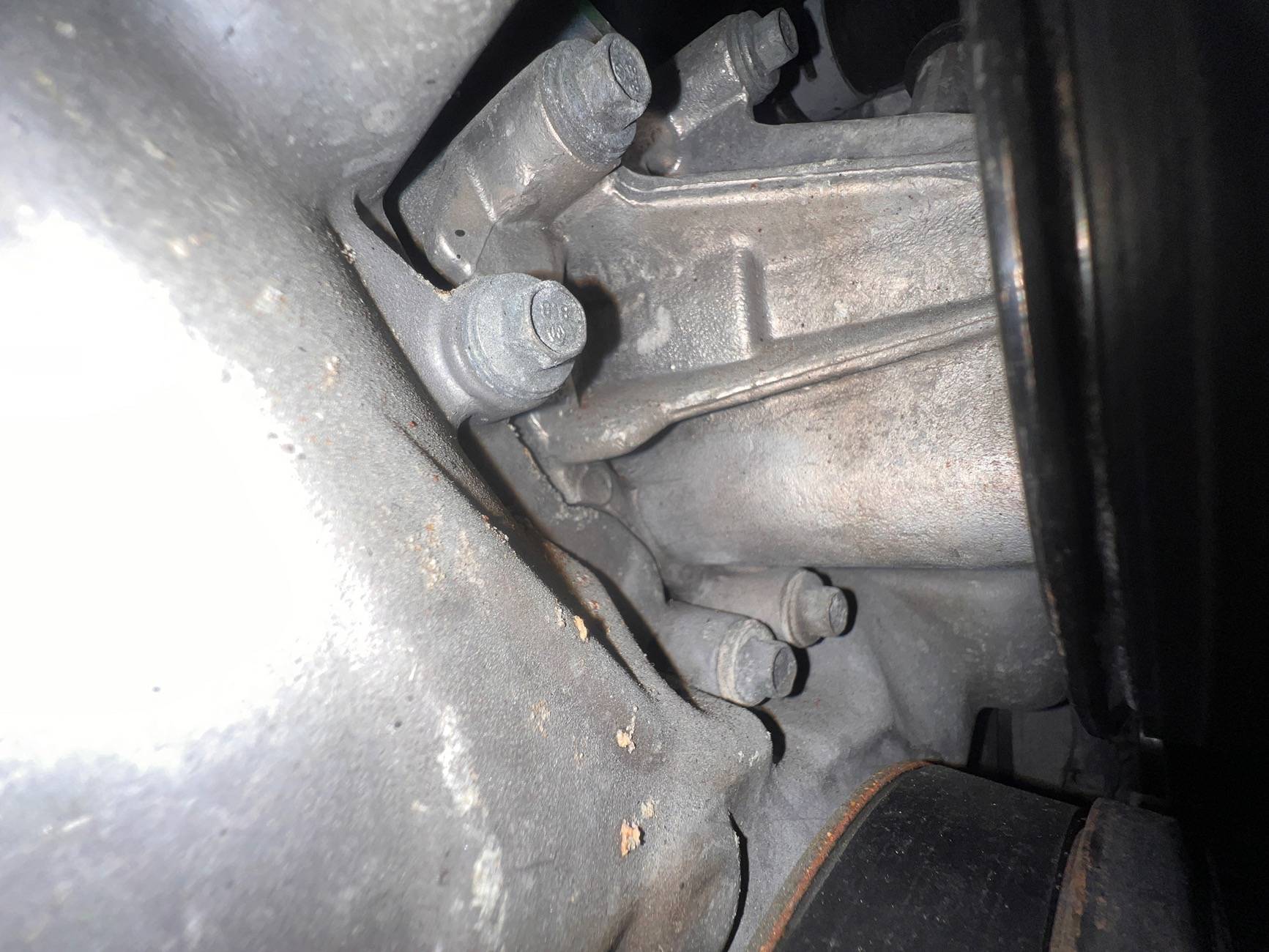

Should I expect to see any leaks under the water pump ? I can’t see anything which stands out to me there
See all that orange residue? Its from a leak. It must just only do it hot and then evaporate. To be safe check above the water pump as well, that plastic t junction is also notorious for leaking.

Pull serpentine belt off and feel for play in the pump shaft.
