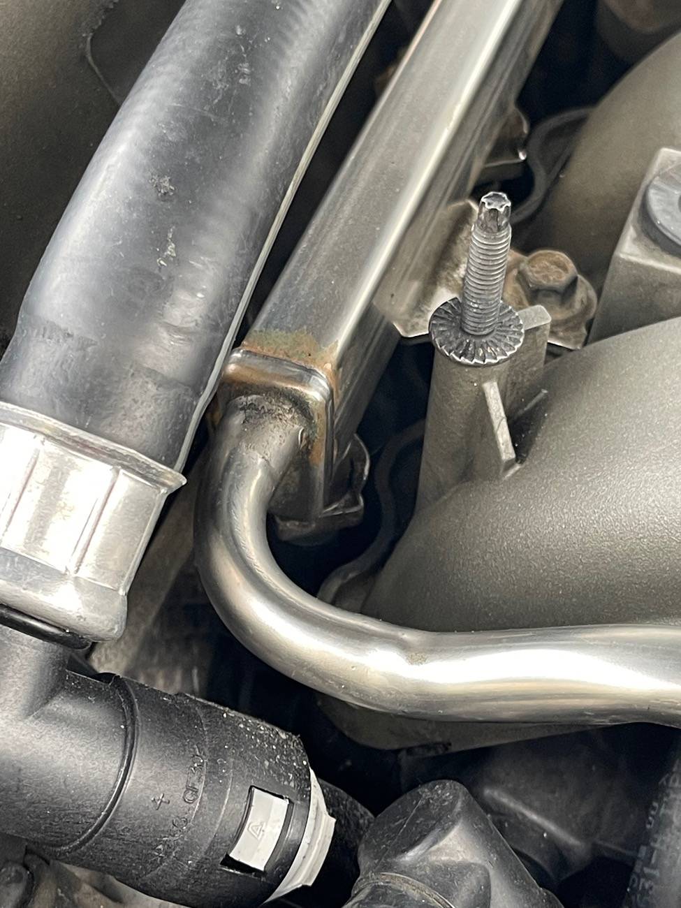

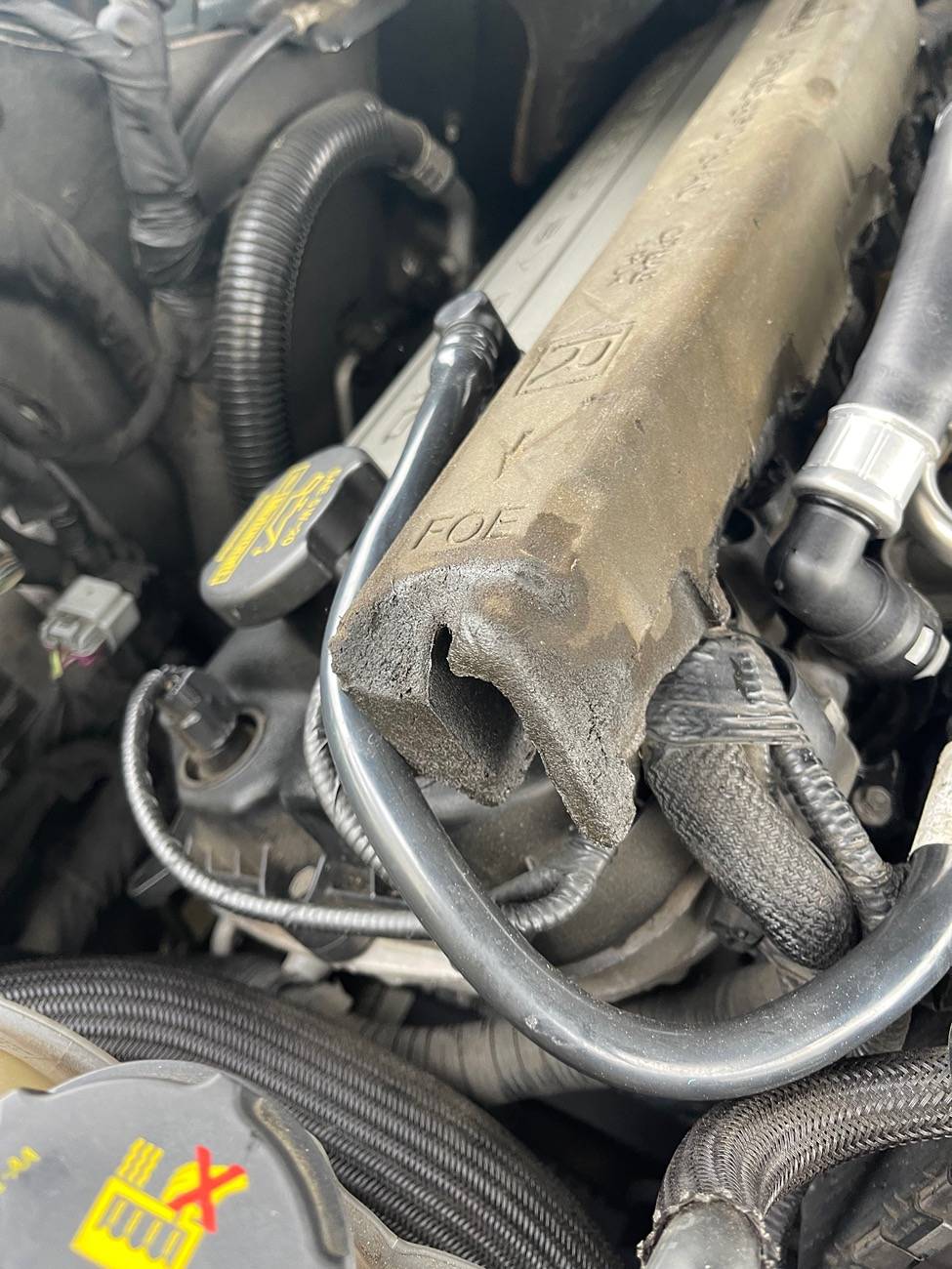

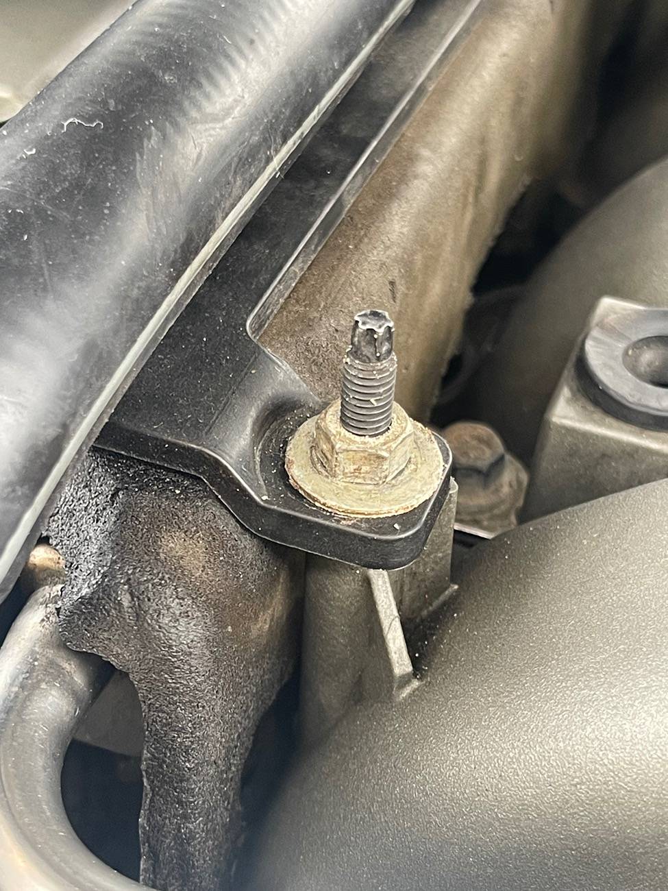

Hey guys. Here once again. I’ve kept the car in the garage since October but checking under the hood today I noticed this piece looked to be damp. I pulled it off and notice coolant like liquid, but the thing is, this looks to be the fuel rain that its leaking out of? Any ideas? I don’t smell gas either. (I stupidly cleaned off the residue/liquid before I took the picture). This foam piece sits under the heater core coolant line. Pics attached. The pic of the rail was the general area of where the liquid was sitting around. Only reason why I say it’s coolant is because the screw that holds down the plastic bracket that the foam piece sits under, was covered in dried coolant. (3rd pic attached)

How many miles on the car? That foam piece looks like it’s been saturated before by something.

114k on the clock. I did get a coolant leak from the heater core hose that sits right on top of it earlier this year but I got those replaced.

Maybe that foam piece was saturated and slowly seeping back out?

If it didn't smell like gasoline, what did it smell like? What did it feel like?
