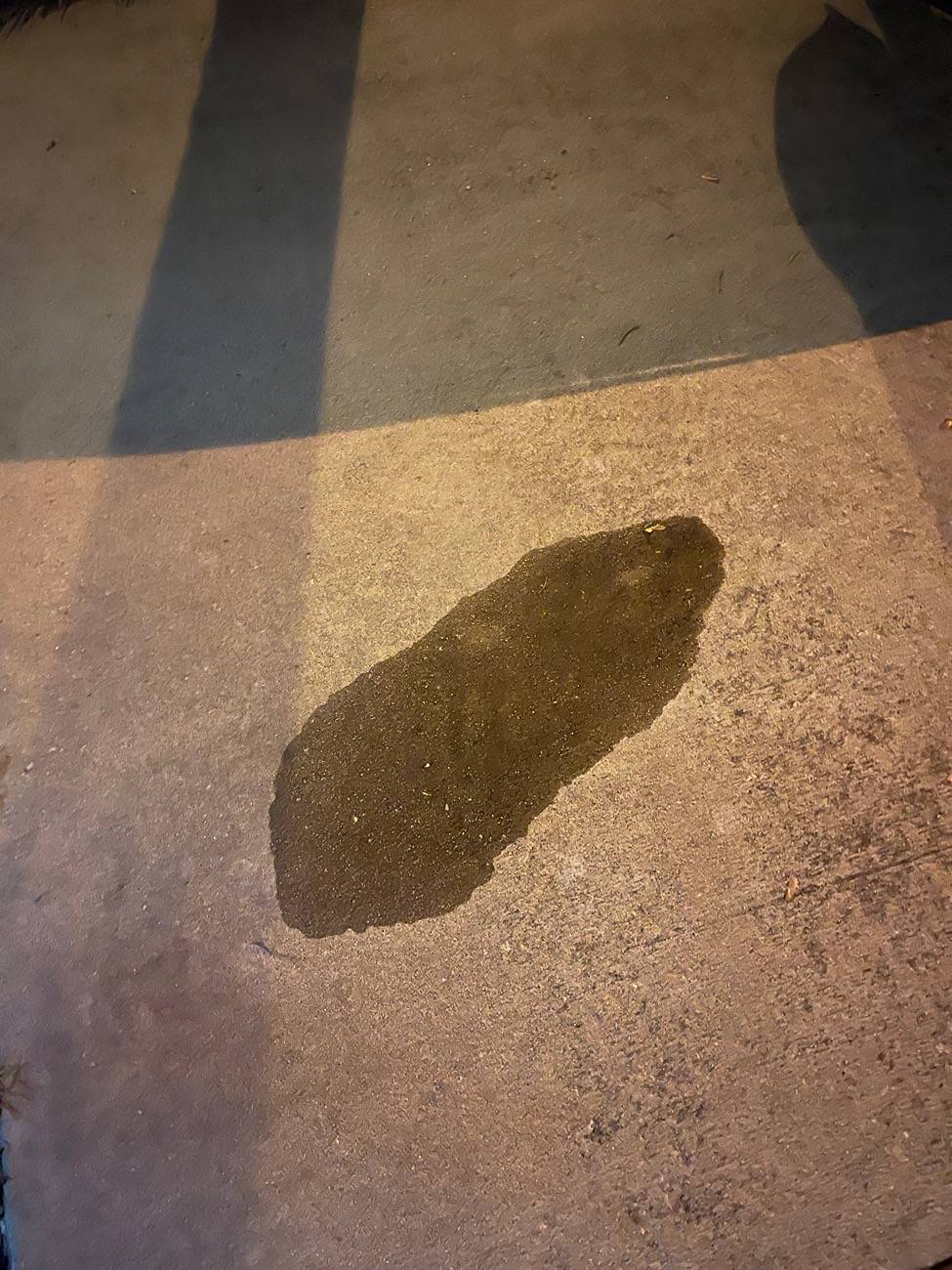

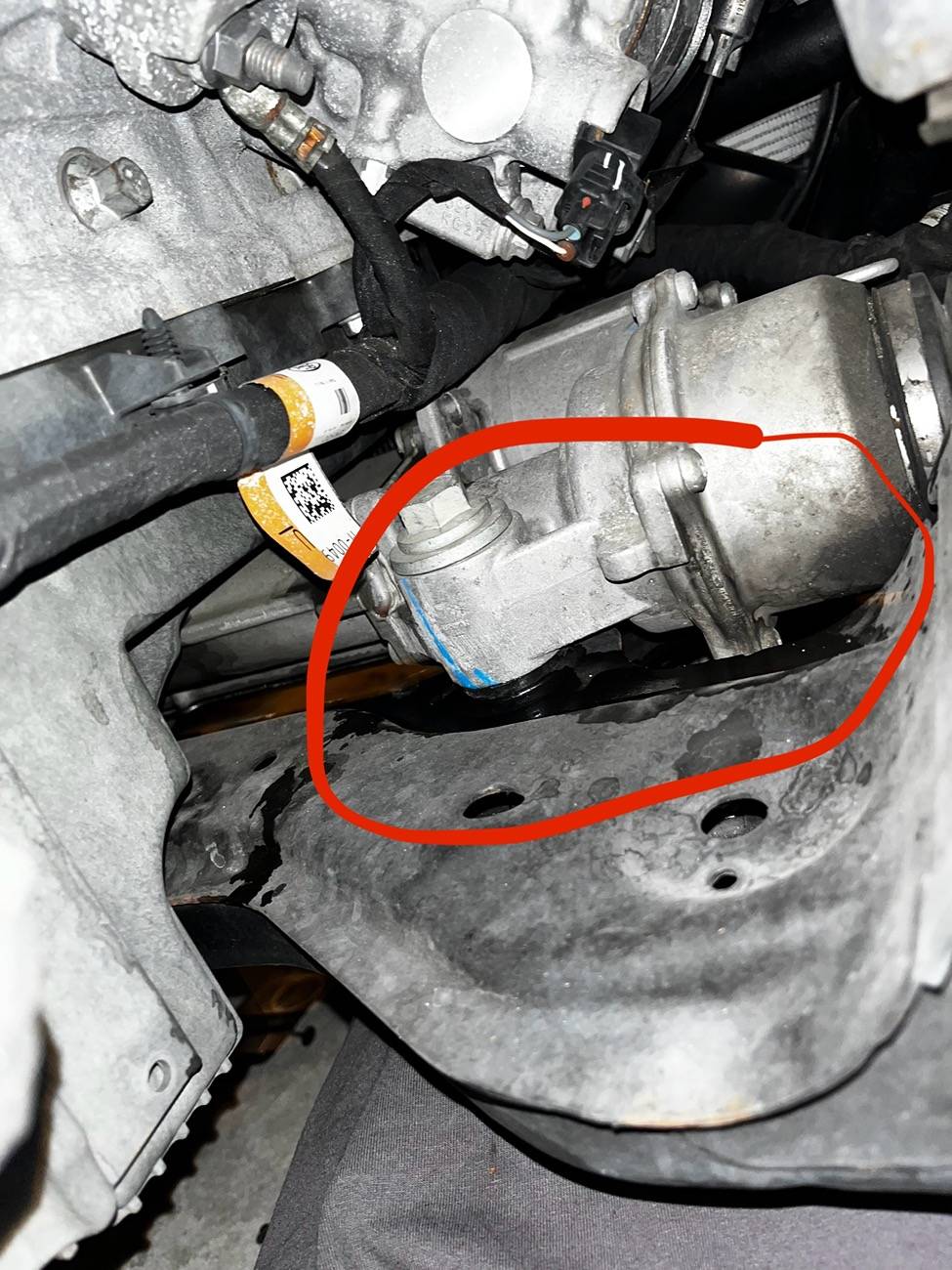

I have a 2020 Mustang GT and I noticed a big puddle of coolant after the car sat off for a couple hours. I jacked the car up and took off the belly pan to try and pinpoint the source but to no avail. From what I seen the majority of the coolant puddled up on the front subframe on the passenger side. This also appears to be where the puddle on the ground came from. Checked the hoses and t connecters from the radiator and coolant reservoir and no leaks. Any ideas?

Go to the parts store and get some coolant dye and a UV flashlight. Easiest way to trace the path of the leak. My F150 had a leak last winter and I mistakenly decided to let the local Ford dealer work on it beings it was still under an aftermarket powertrain warranty. 5 weeks later they gave up after replacing several coolant lines and the water pump, all on their dime. I took it home, added some dye and found it in about 10 minutes. Turned out to be an o-ring they re-used instead of replacing with new.
