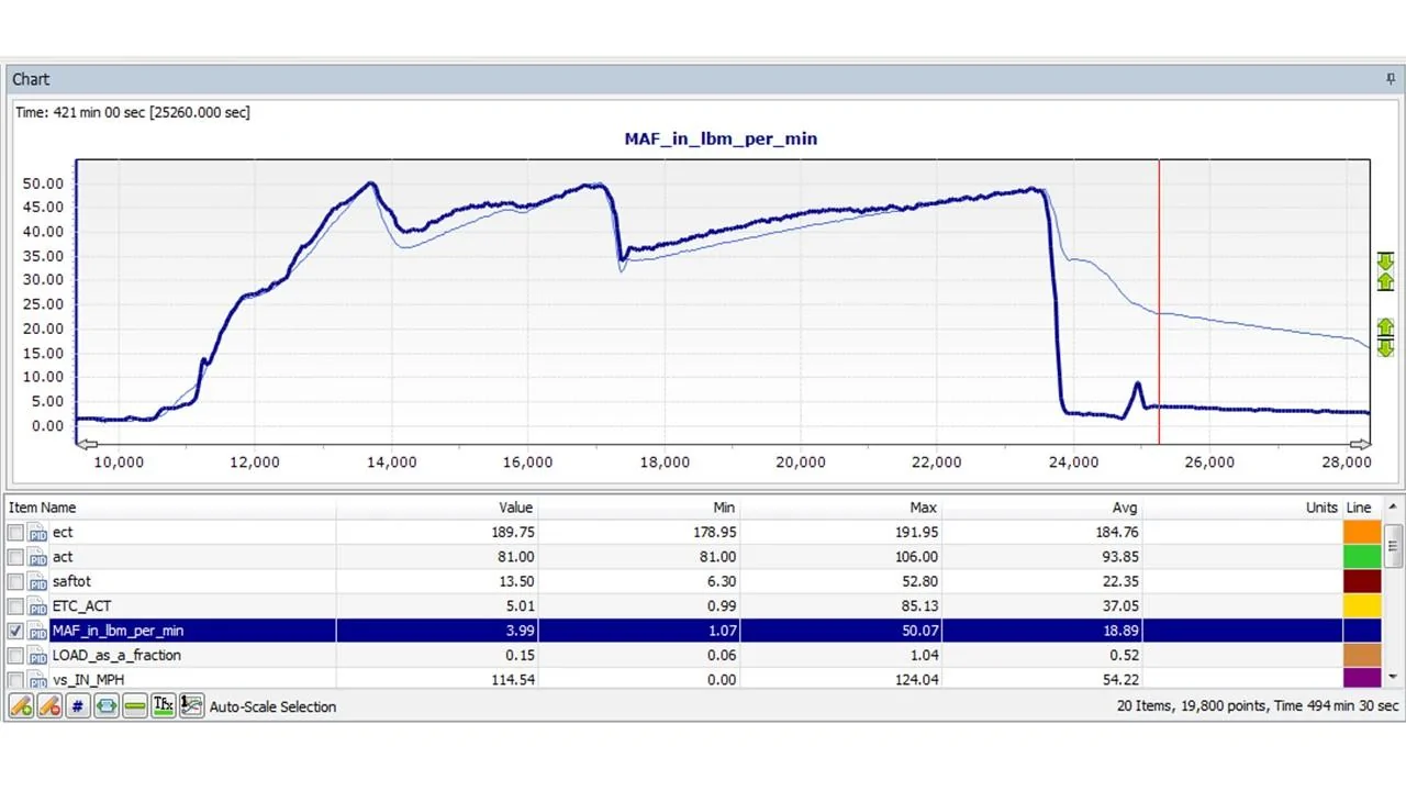

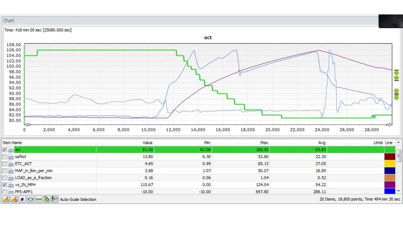

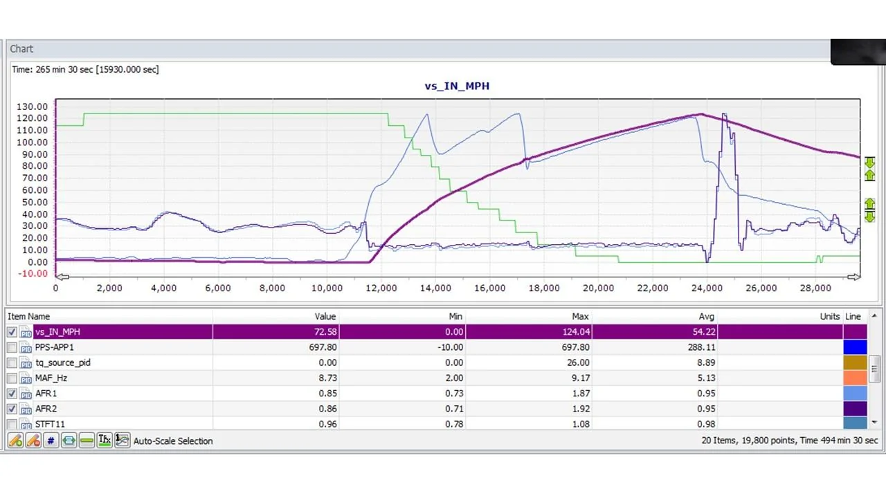

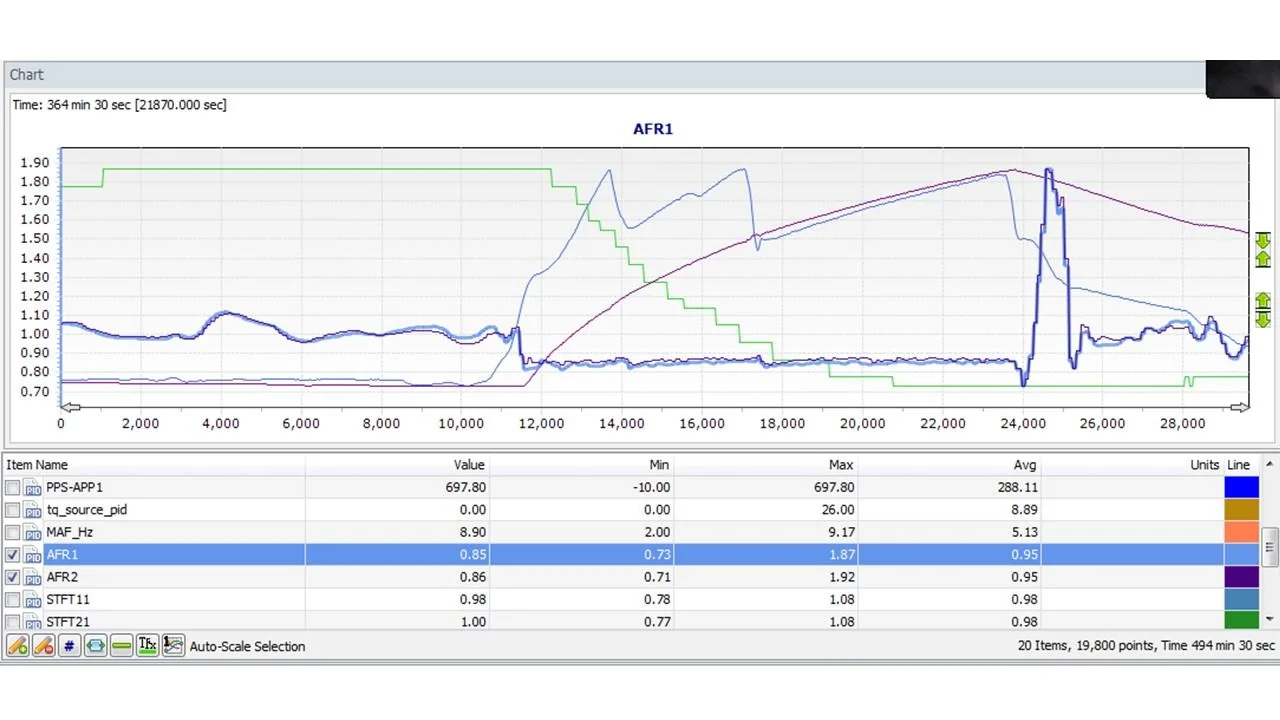

These graphs of my data log at Bradenton are to assist a fellow M6G member. Keep in mind this is during True Street and I cannot open my hood, so temps are higher than normal, but still not too bad considering the situation. Some insulation is sure to help.
Don't forget I'm on E85 and a 5C converter.
A straight edge will help you read the numbers all the way across.

Is that MAF rate what you normally see on your datalog pulls?

I looked back at a few, even the one in November that is my best pass to date and yes this is typical.
