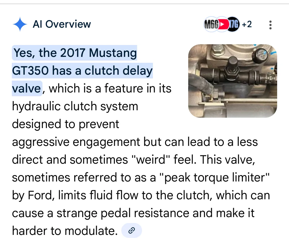

Do our cars have a CDV? The tranny feels great, and I've installed the Steeda spring. However, I am having challenges shifting smoothly at higher RPMs, and it just feels like there is a CDV in the system. I've removed the one installed in my E36 M3. My understanding is that most modern cars have them--I would love to delete or modify the one on the Shelby (*if it, in fact, has one).

not on the GT350. A lot of that is just physics of spinning all that mass. Was a huge problem on the boss cars back when they were using single disc clutches, so much so that the centrifugal force could overcome the pressure plate action and leave the pedal on the floor.

Clutch Delay Valve. I removed it on my E90 BMW as well. They are intended to reduce the shock on the transmission during fast gear shifts. No idea whether the GT350 has one or not.

"Your vehicle is equipped with an electronic powertrain feature to reduce clutch damage. When excessive clutch slip is detected at a high power level, the powertrain control module will limit torque to reduce damage to the clutch. Full power is restored as soon as the clutch is fully engaged. This feature is calibrated in a way that does not interfere with normal driving and does not impede maximum acceleration capability"
I think this is the tune doing something weird not the clutch... but i'm not sure...

No separate CDV like BMW, but the Mustang clutch system uses a CSC and hydraulic restriction that can mimic that delayed feel
