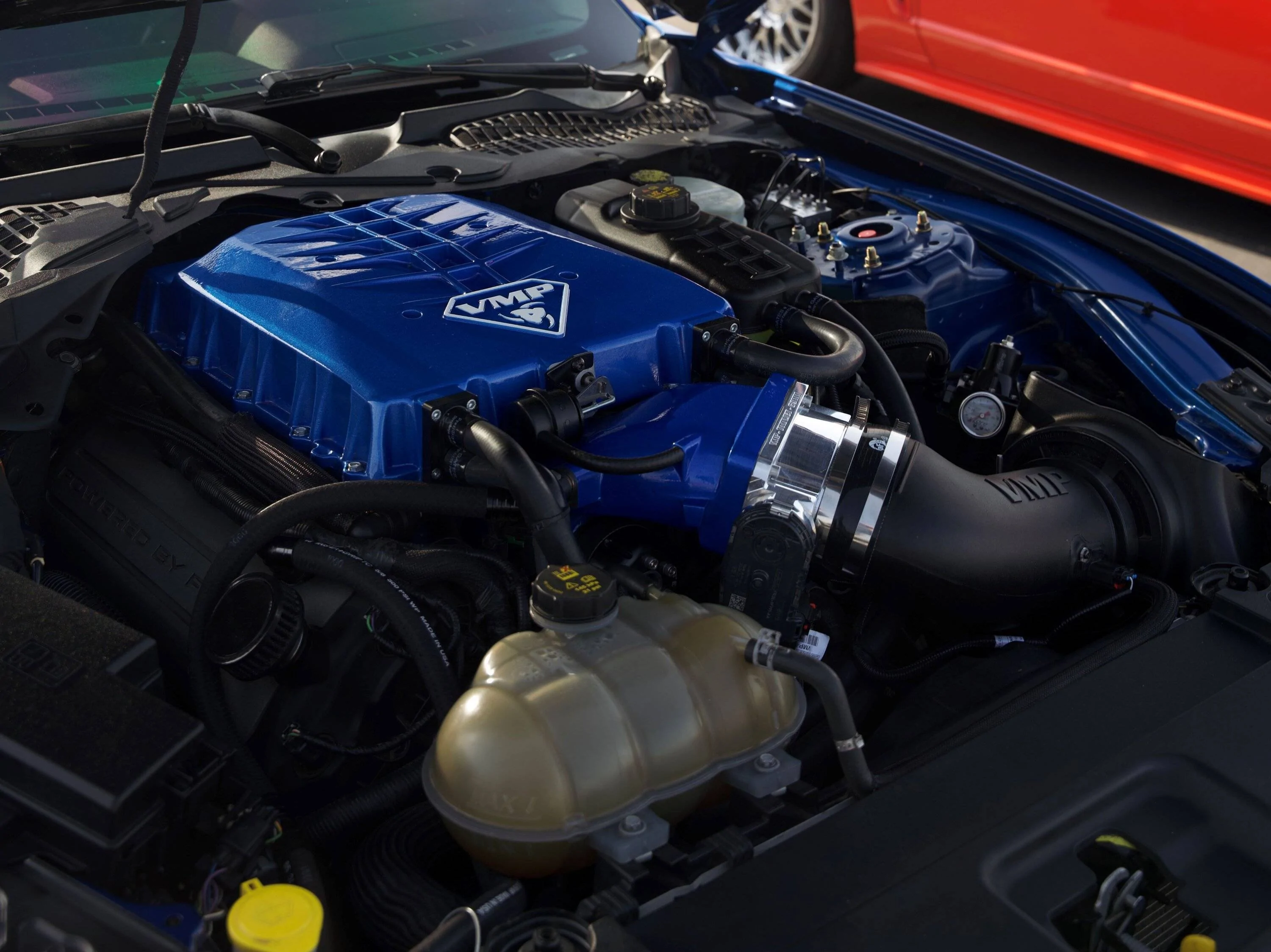

Purchased Ford Aluminum Valve Covers and had them powder coated. What a PITA to install. I had to lift my VMP blower but the end result came out great and I'm happy with it for sure.
That looks really good! Painting the blower the same color would look sweet. This is my buddys car with a lighting blue painted matched Odin. Projectlighting_ on instagram
