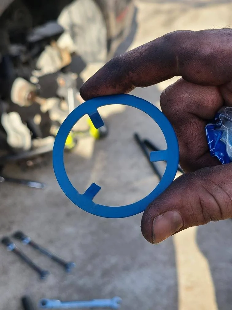

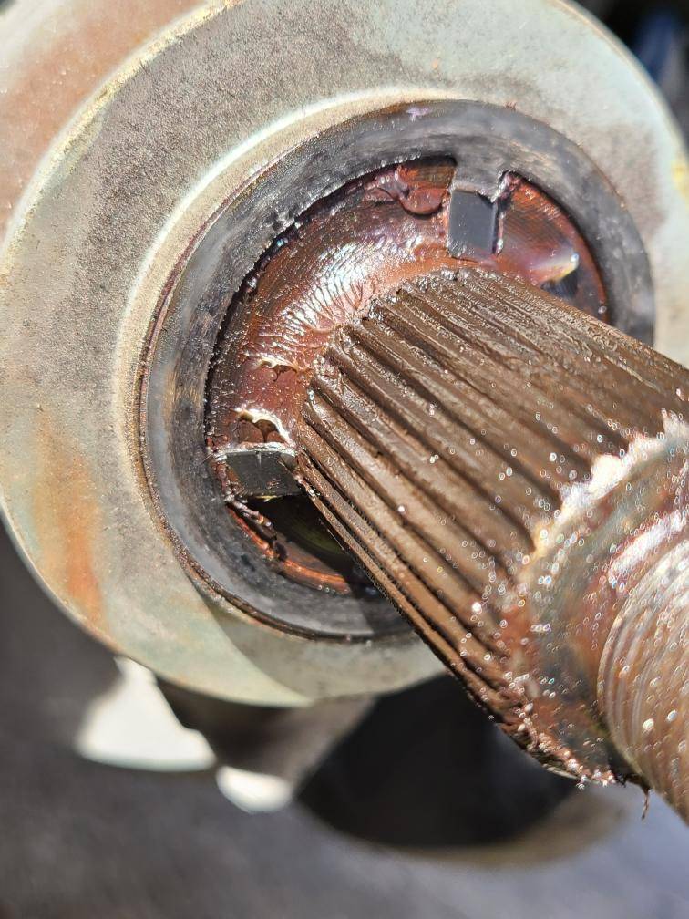

Alright, so after replacing the rear thrust washers and axle nuts, the click is completely gone! I did the passenger side first. Passenger side washer didn't seem to have any damage to it, and after driving around the block I could still hear the click.
When I inspected the driver side thrust washer, one of the tabs on the washer was missing. After replacing that washer and axle nut, the click went away.
I decided the issue had to be related to the wheel hub in some way because I jacked up the car and accelerated and found that the click didn't make a sound when the wheels were off the ground. This got rid my suspicion of the ujoints. That and the fact that visual inspection showed the ujoints to be in good shape.
Ford is aware that these thrust washers are an issue and redesigned the part. It is now stronger than the previous version.
I think that I may have been the cause of the tab being broken. It's possible that when I torqued down the spindle nut after my hub installation that the tab wasn't seated correctly and snapped when it was torqued down. There are other possibilities as to the cause, but right now I'm blaming the design.
So if you recently did a wheel hub replacement and get the click, check the thrust washer.
