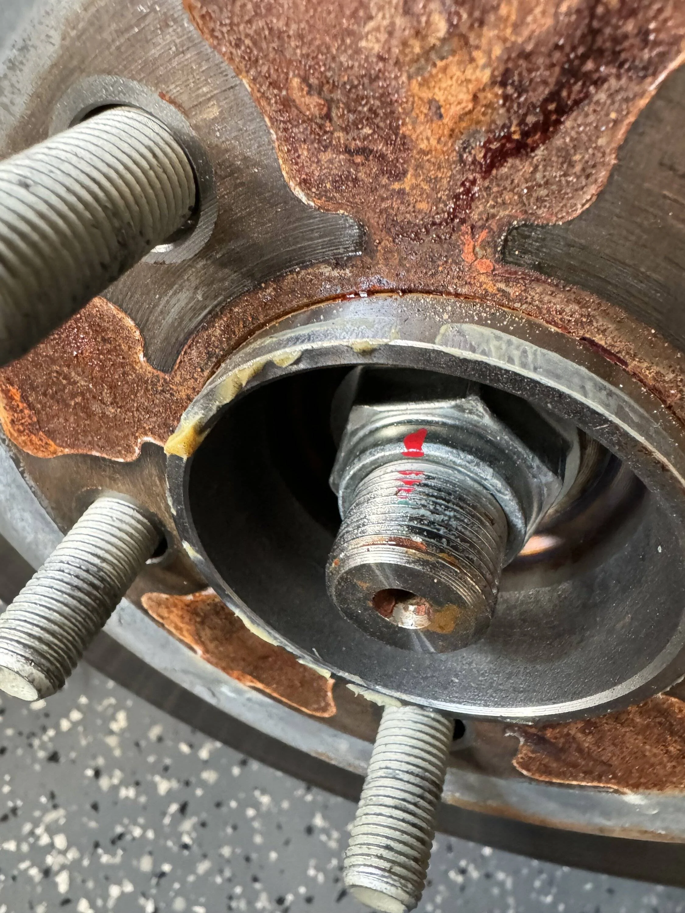

Update: I went ahead and checked the axle nut on the right side. Sure enough, at 150ft lb, it moved another 1/8. I tightened another 1/8 and put a mark to see if it moves. Also, I went ahead and checked the left wheel and had to retorque the lugs to 150 ft.lb. . It could be the cause as well (rotor slapping the lugs). I am happy to report that the noise is gone …for now.

My Mustang GT Started doing this a few weeks ago. It started to make this clunk (almost like a metallic pop), when car is put into reverse and I initially roll.
Later, it started to happen when I roll forward, and now it does this when I roll forward then backward. Is this something that I need to stop driving ASAP?
I took off the right rear wheel (at least that's where sound seems to originate from), and the axel nut is tight (150 lb-ft), and none of the bushings look worn or cracked. I bear-hugged the wheel and tried to move it but I hear no sound and everything is tight.
Other than the sound, the car drives perfectly fine.
I have a drive down to Washington D.C. (from NYC suburbs) this weekend. Wife and I wanted to take the Mustang, but I would rather not if the thrust washing being broken is going to cause a damage.
