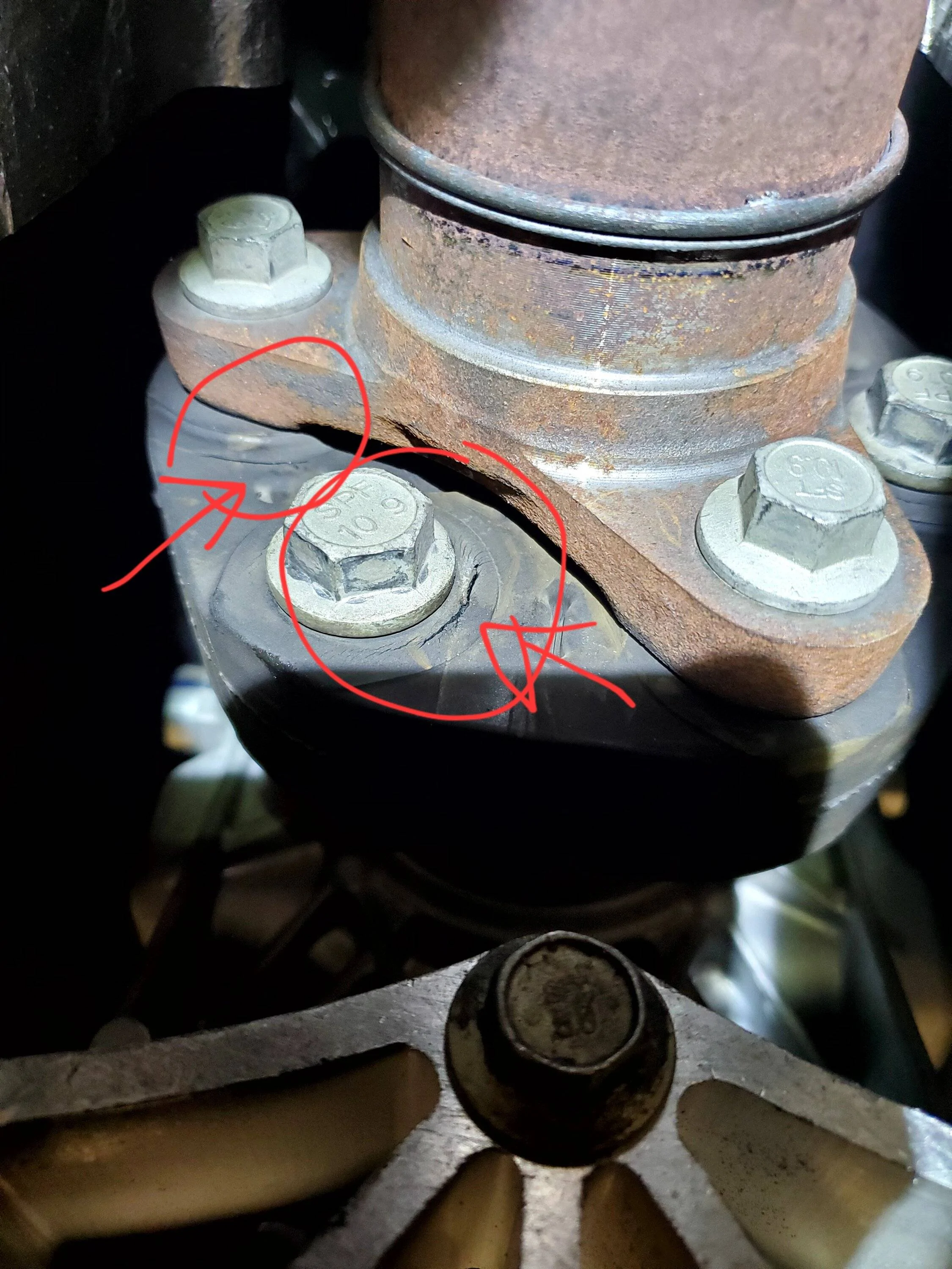

If you have an S550 with a discernable "clunk" or sensation of "unloading/loading-up" at throttle-tip in or tip-off — some of this is unavoidable as a result of the drive-line's design. That being said — the "Guibo" flex-coupler between the transmission and differential is a European-esque solution to some refinement-concerns Ford may have had with its first officially-global Mustang.
S197-Coyotes do -NOT- have the flex-coupler that s550s do. I recently had a vibration at highway speeds that mimicked when two-of-the-four clutch-center hub springs went out on my factory, Turkey-made clutch.
-Fortunately- — it did not appear to be the clutch this time, but the flex-coupler. Get under your car and take a look at it.
If it looks like -this- ⬇ ⬇ ⬇ — replace it
(either through a Ford parts supplier, or you can get the Dorman-OE unit through AutoZone) (I got the Dorman, says "Made in Germany" on it 🤷 but it was better than what was on the car).
You'll be surprised what a difference that donut 🍩 makes — mine had 103K on it.
Side question but one anyone who replaces the part will run up on: anyone know the torque value for those bolts (In the drawn circle)? I recall trying to find it a few years ago and the Ford shop manual didn't list any.
Apologies for not replying sooner, I was out of town. I just did a quick check and didn't find them right away either — but I'll tell you this: I replaced my Guibo at work with a Dorman unit — which didn't include new bolts. But I've been turning wrenches 🔧 to not-be-homeless for a bit now, and I just re-tightened the originals (-with- loctite) to 'that's not going anywhere' (have to actually say it aloud, that's part of the witch-craft) and it's been continuing to make me proud for a few 1,000 miles now.
"That's not going anywhere" vs. *SNAP* "GodDAMMIT" is a judicious application of "how hard was it to come-off?" — it shouldn't be tightened -THAT- much, just below the removing-effort — and loctite.
